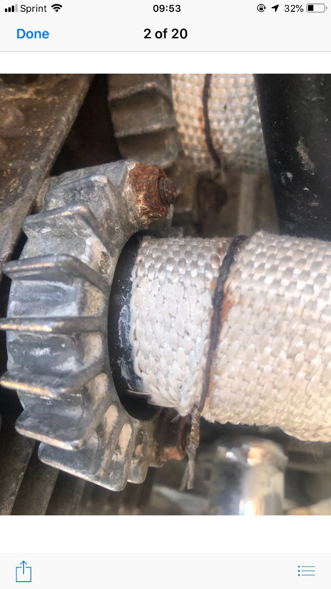

All in All? I hope you have cleaned up the rusty studs. Maybe have wire brushed off all the rust and scale you could.
And have been soaking the studs with some spray penetrant for the past 2 weeks since this picture.
Just do it! The suspense is killing me!! :woohoo: :woohoo:

02 Jan 2019 16:59I'll take a pic of the studs before the new one goes on. The penetrant, which I have sprayed on it almost every day before riding the bike (only to watch it smoke off once the bike is up to operating temperature - but hopefully penetrant is seeping in) has REALLY cleaned up the studs and bolts. Looks like a whole different ballgame.

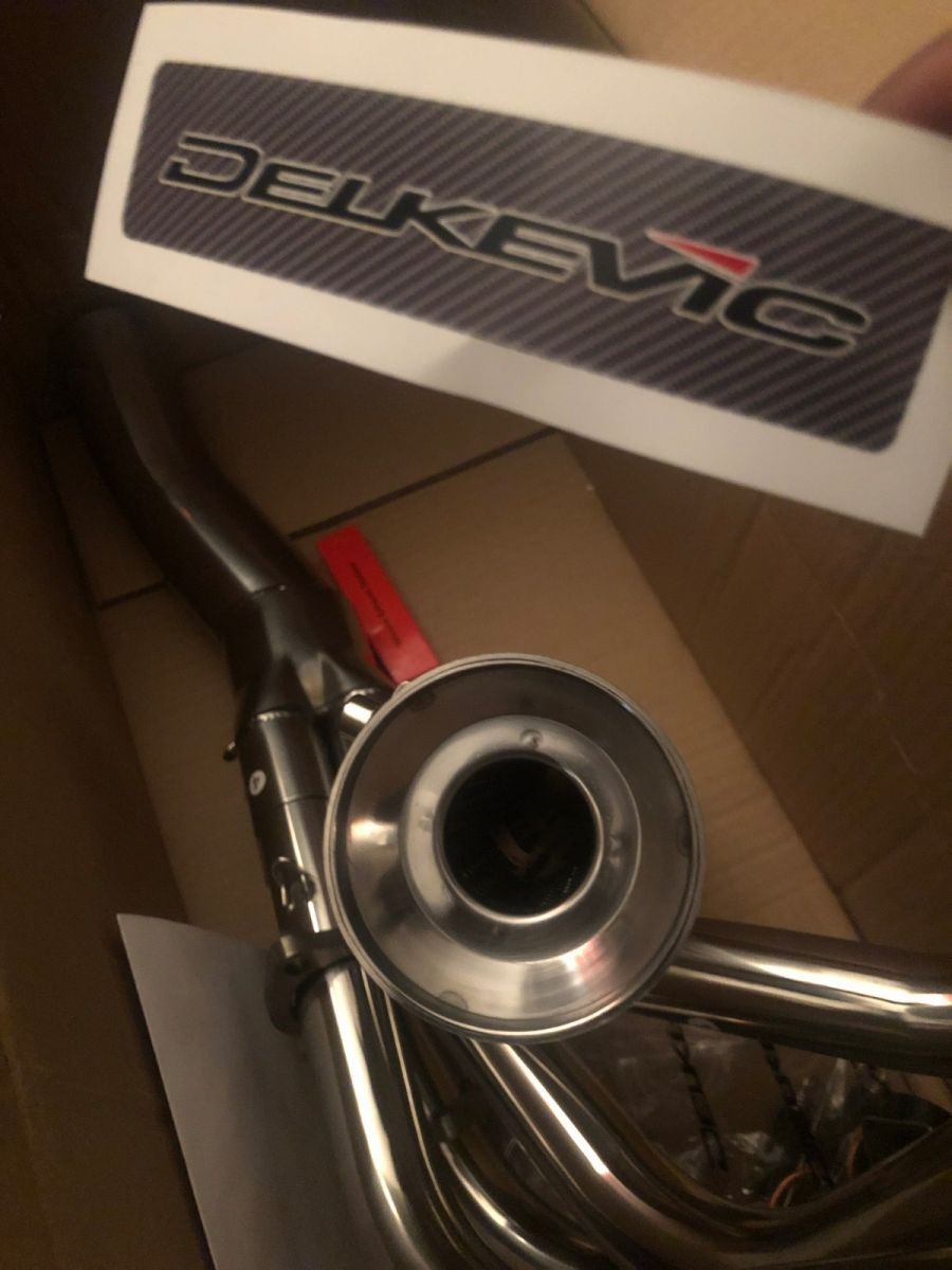

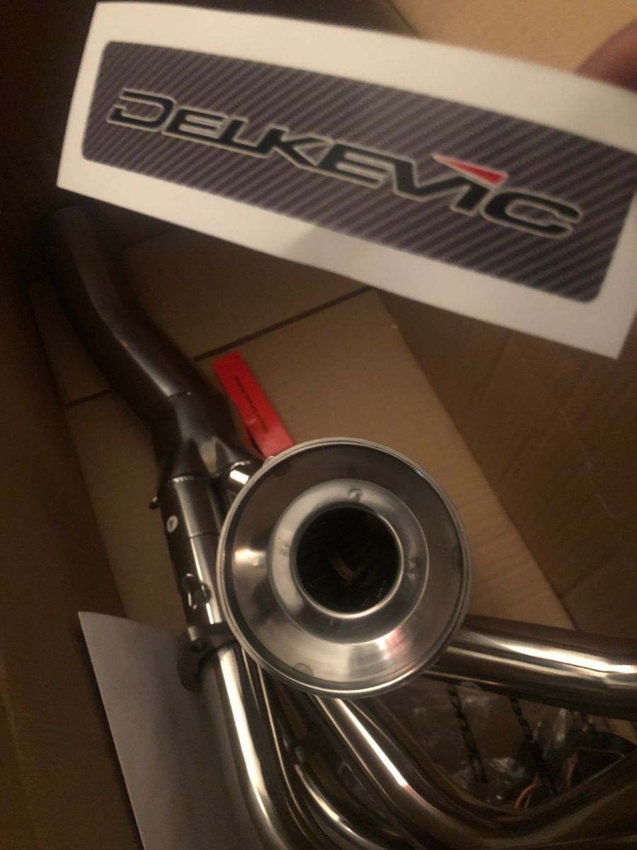

Came in the mail today. Here we gooooooo!

Definitely putting this on myself. Mechanic said he could do it for $285. No way am I paying that. Fingers crossed it all turns out OK. I plan on doing it EARLY Sunday morning before church. I'll get up at 7am. Hopefully it wont take me more than an hour?
How long do you guys think it should take, barring any problems?

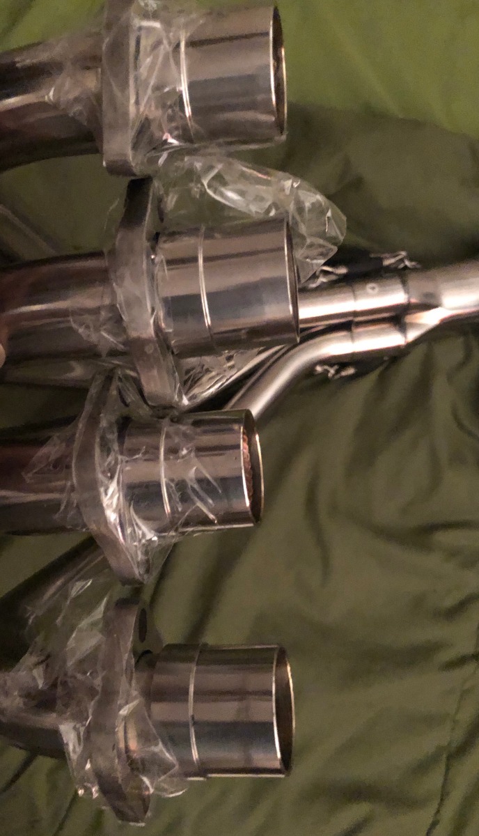

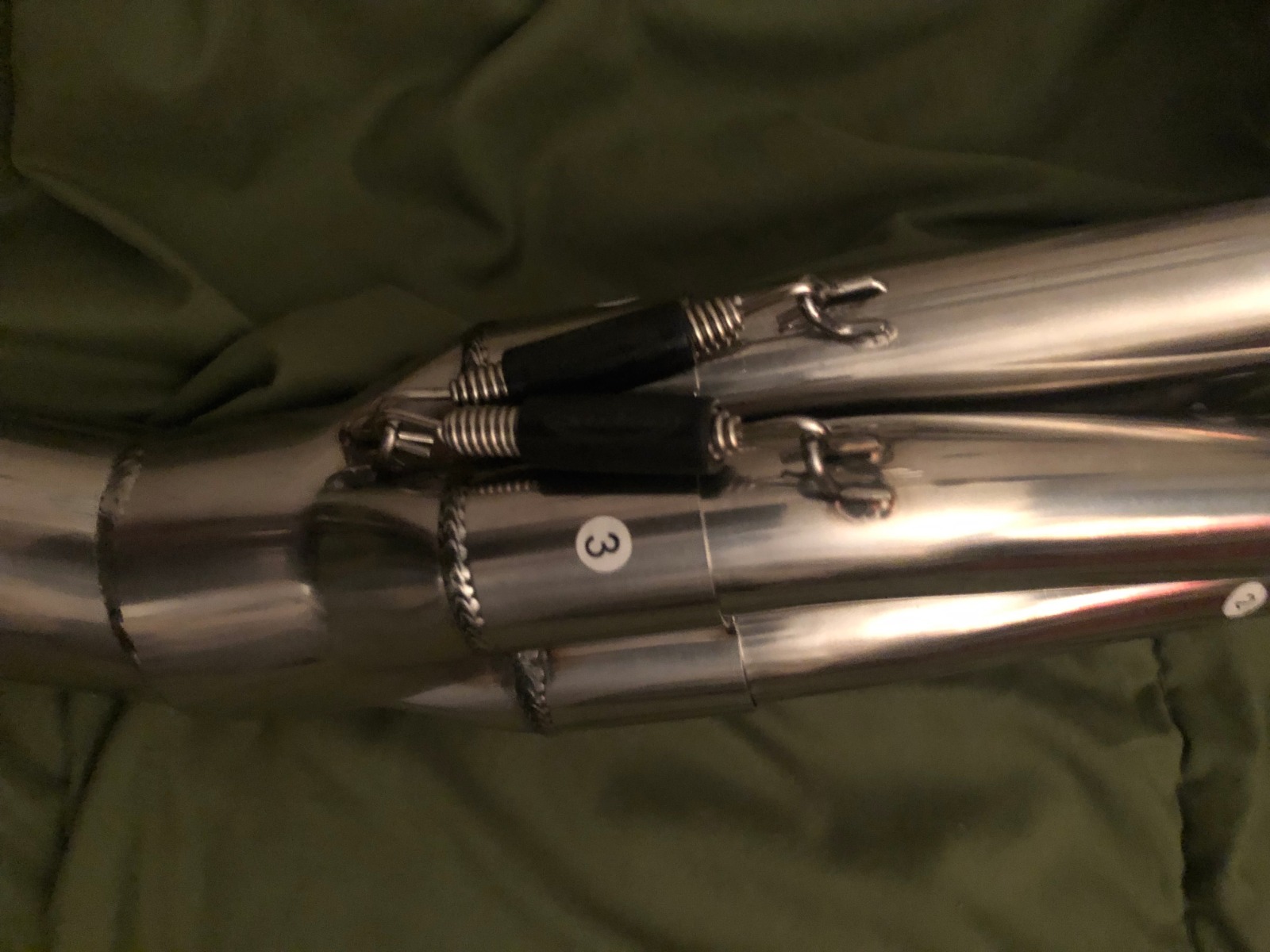

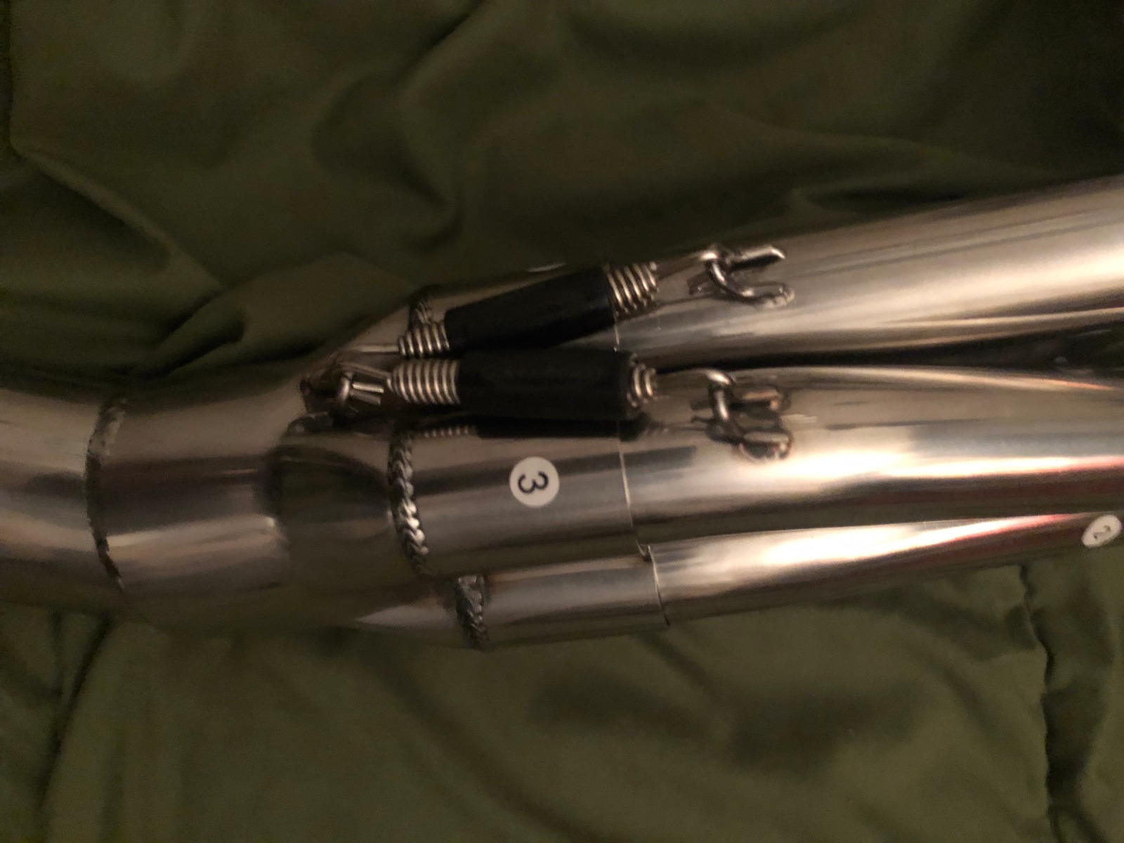

05 Jan 2019 07:05 - 05 Jan 2019 07:33Some good news. I assembled the Delkevic exhaust last night (premature I know) just to get a feel for what it will be like on the bike.
I cant work on the bike today
but

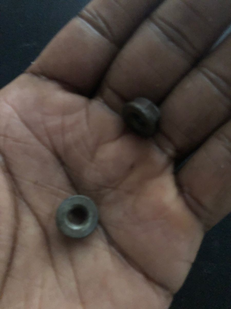

remember those rusted nuts and bolts in the FIRST photo below? They came RIGHT off, almost without any effort. That WD-40 PENETRANT (not regular wd-40) worked like a charm!!
When I took the two most egregious looking nuts off the exhaust, the collar slid right down. So Im hoping swapping out the exhaust tomorrow will be a breeze:

I may be wrong but it looks to me that the collars are built into the new pipes so you won't need to use the old ones.
I would suggest that you put them in a baggie and keep them with the original pipes.

Yeah the new exhaust has beautiful collars. Im not going to put the old ones on the new exhaust, no way. Not even aesthetically compatible. The OEM collars will be put in a baggie.
