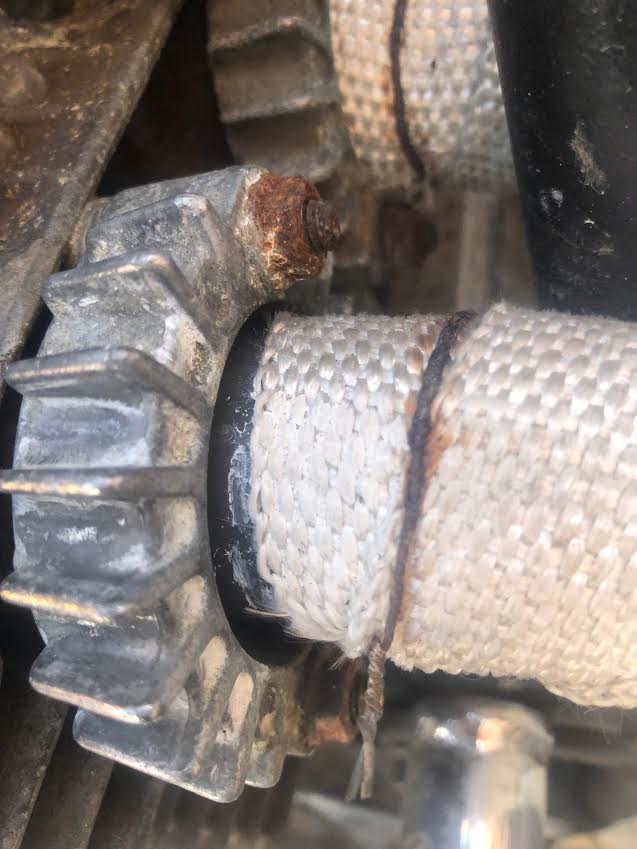

I bought the Delkevic exhaust system today and will be installing in myself. The stock exhaust pipes I have on the bike now are pristine, no rust. BUT the exhaust header bolts, thats a different story. Im thinking this may be an obstacle in taking off the old exhaust. Any ideas? Only a few bolts, nuts are rusted this badly:

Re: RUST. Im afraid. VERY afraid! Pics
26 Dec 2018 14:04
pentrating oil and heat keep soaking and heat an let cool then repeat 6mm ones are a PIA.
26 Dec 2018 14:20 - 26 Dec 2018 14:29
Ignoble metals will rust first,(react with air/water oxygen) and contagious noble metals to corrode.
Your non stainless steel wire to hold the header wrap infect the other metal parts, you have to use a stainless steel wire.
26 Dec 2018 14:20DFIGPZ wrote: pentrating oil and heat keep soaking and heat an let cool then repeat 6mm ones are a PIA.
Is there any way to take the studs out of the engine block and replace them with no rusted ones?
26 Dec 2018 14:31
Yes, of course why not with the right tools and skills.
26 Dec 2018 14:37Scirocco wrote: Ignoble metals will rust first,(react with air/water oxygen) and contagious noble metals to corrode.
Sacrifical anode
en.wikipedia.org/wiki/Galvanic_anode
en.wikipedia.org/wiki/Cathodic_protection
The bolts were rusted long before I put the wire on the wrap. The wire has been on the wrap for 6 months only. They are quite far from each other and I doubt there is any interaction.
Anyway, penetrating oil, heat and elbow grease it is!
I will report back with developments.
26 Dec 2018 14:52 - 26 Dec 2018 14:53Thanks. Right.
Where from? Do you have a link?
26 Dec 2018 15:00z-fever.de/shop/en/product_info.php?info...n-edelstahl-6mm.html650Dude wrote:
