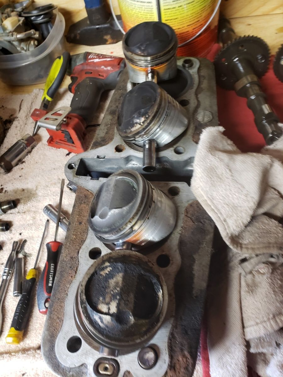

The tubing is the plumbing for the nitrous, also can anyone identify these pistons? And I'm still new to foru.s in general should I just start a topic about my project?

Look up inside them from the bottom, there is usually a tell tale mark or symbol that'll give you the answer, I would say they are higher compression than stock. Take a look at the ends of the cams and see if they're aftermarkets, again, usually some kind of marks.

There's an mtc cast in bottom I'll look closer when I get home, thank you for info

Haha yeah I like this thing I picked it up dirt cheap it was an animal but was smoking I'm trying to freshen up top end finding it difficult to track down rings these pistons are +2mm I emailed mtc I'm hoping they can help find rings for them
