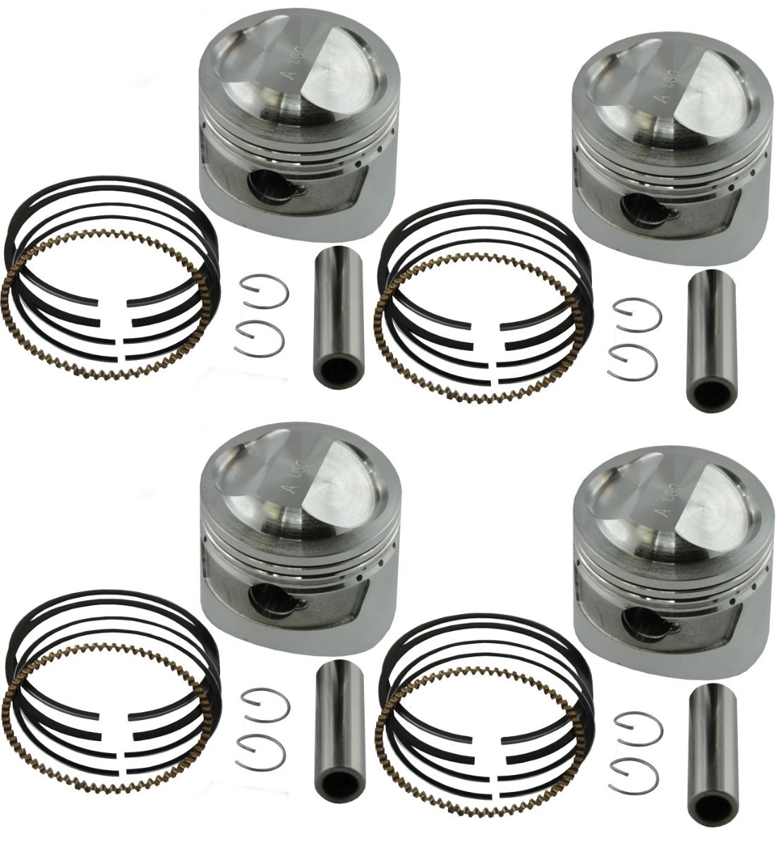

i bought 1045 kit (71mm bore) for my mk2 but it has original compression ratio : can i put a small thickness gasket as Copper .010 /.005 to add a little cr ? WHich should i take ?

You get what you pay for and those IMD pistons are just cast copies of the original OEM ones which were themselves cast..
Not heard anything bad about them so hopefully they should be as good as OEM and should stand a bit of a compression hike via a head skim.
