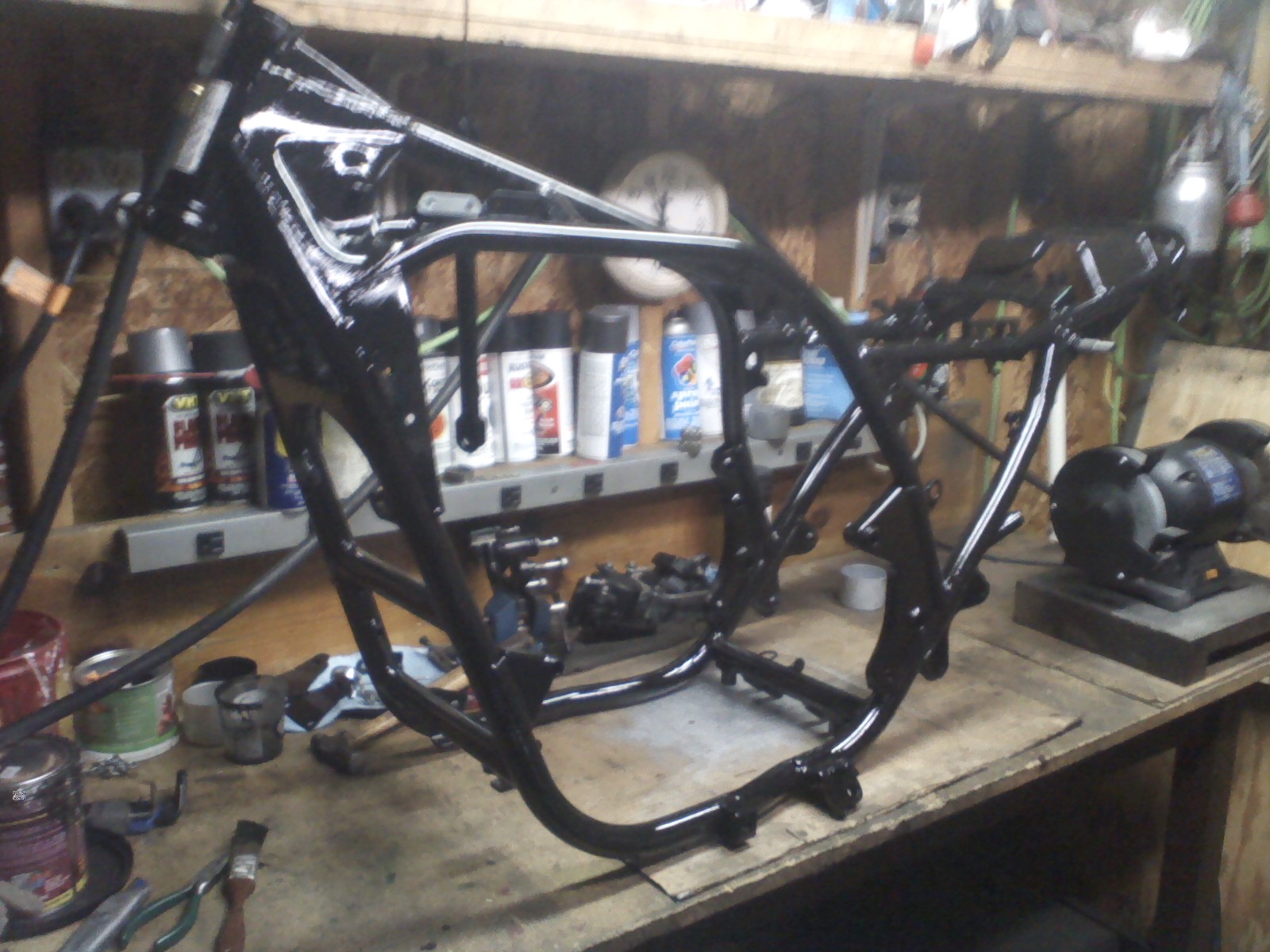

Well another reason is that my frame is a LONG, LONG way from being ready. Just want to see her run ;-) If only for a minute or two.

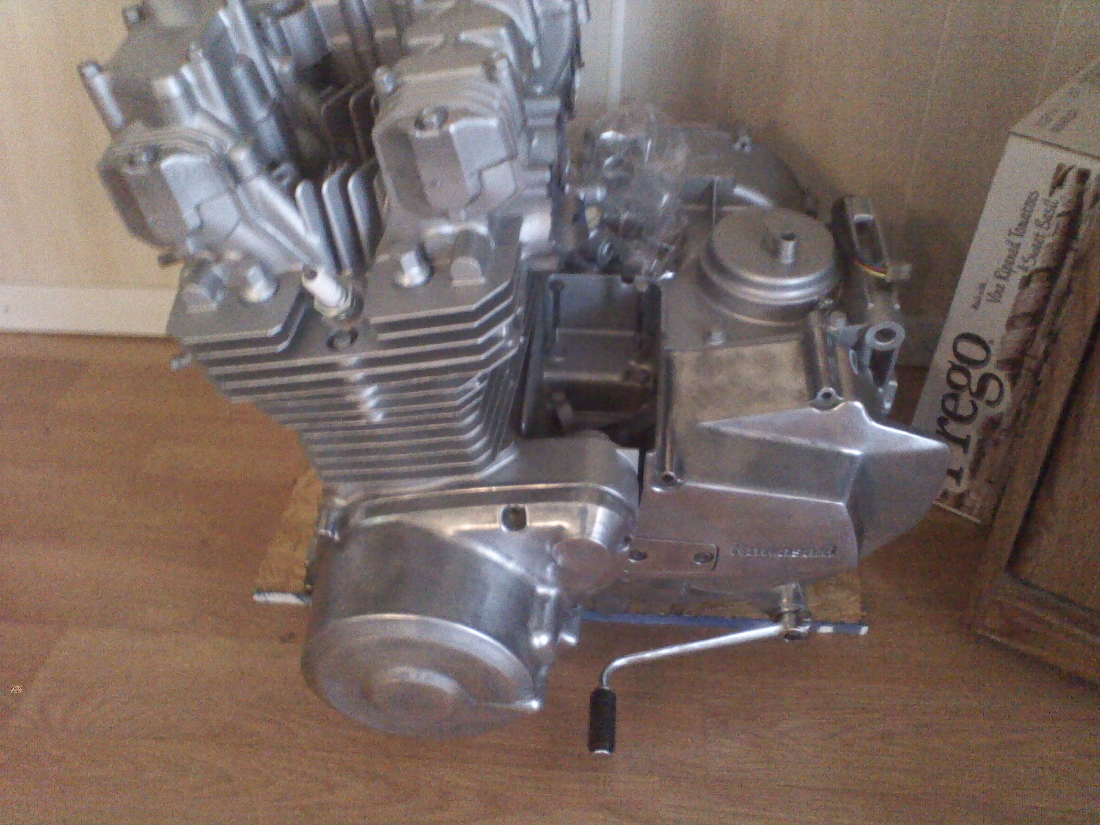

kz650guy123 wrote: Well another reason is that my frame is a LONG, LONG way from being ready. Just want to see her run ;-) If only for a minute or two.
Another thing you forgot to mention. Pics are even helpful in most cases since a pics is worth a thousand words. It's really not hard to do.
You can be the one to break new ground here! Post some pics of your bench setup, along with a tutorial on exactly how to do it, and whatever results you might come up with on this procedure. :-)
My frame was not ready for the engine either after I had it all cleaned up and ready to install.
Sooo, I set it in my LR right next to my TV so that I could see it every minute I was not working on / cleaning up the other parts. Patience is a virtue. lol

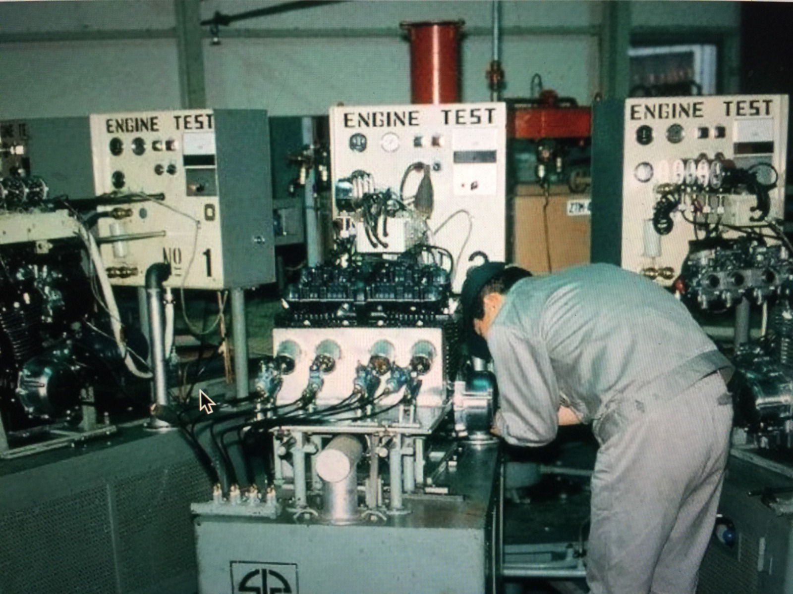

Here is a photo of the Kawasaki engine test area for Z1 engines from back in the day.
