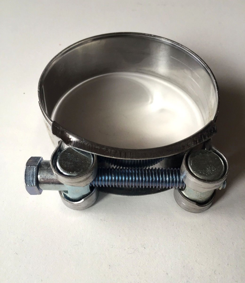

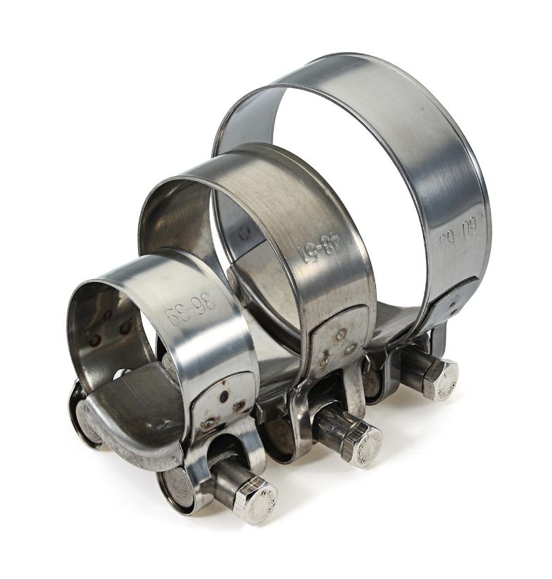

In your case i would try this producct.
and buy good stainless steel exhaust clamps like this. I myself use the same clamp to get a gas tight connection.
