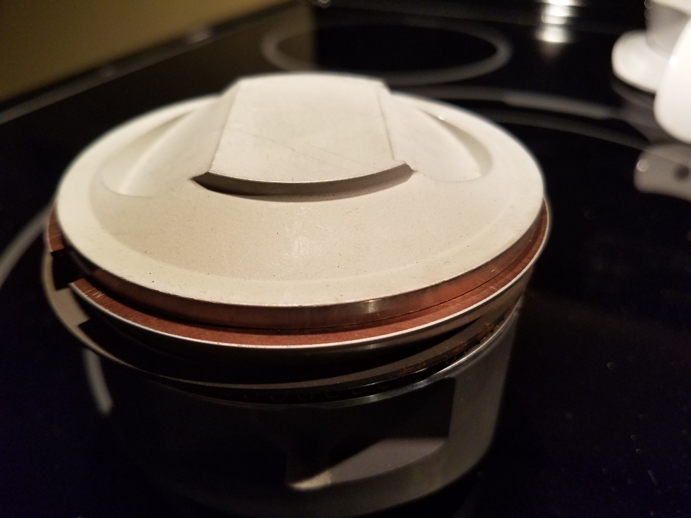

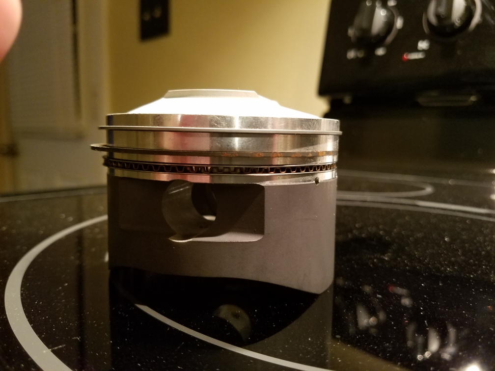

Any chance of posting a pic or two of the MTC pistons you are installing?

They are 10.5 to 1 for 83-84 GPZ1100 MTC. They have 17mm pins

Stock KZ1000 is 3.525. If the pistons have the GPZ pin location, you will need a .055" spacer under the block.
