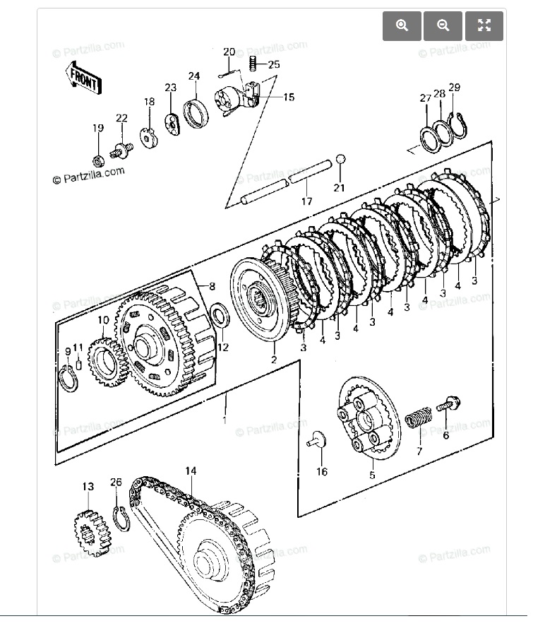

Would assure the ball bearing (#21 on the following diagram) isn't missing, as the bearing can fall out and get lost in the process of removing and replacing the pushrod.

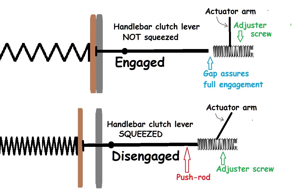

Some of the service manuals are wrong or confusing about which way to turn the adjustment screw toward reducing slack in the pushrod mechanism. I would try turning the screw in the opposite direction to see what happens.
