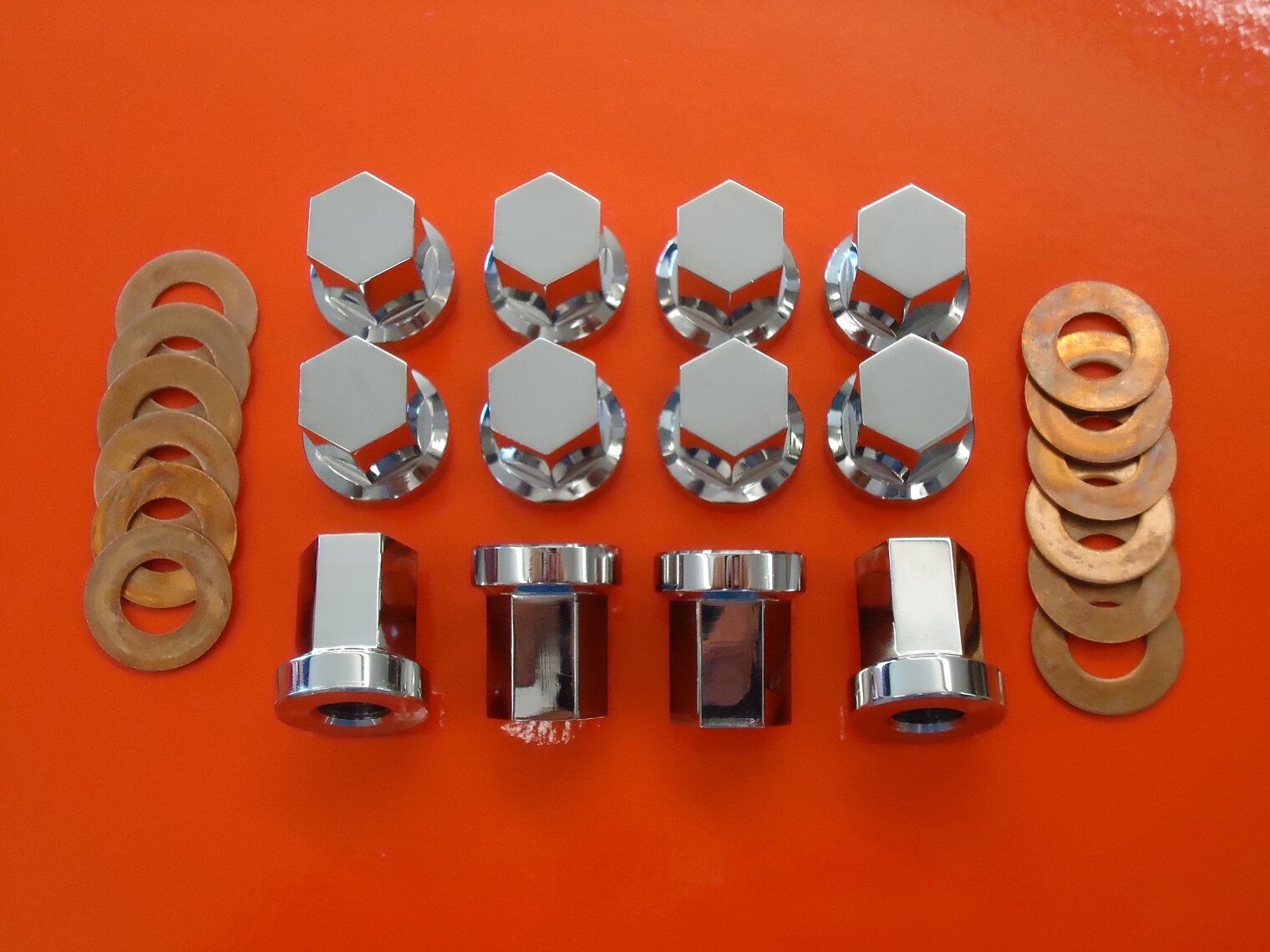

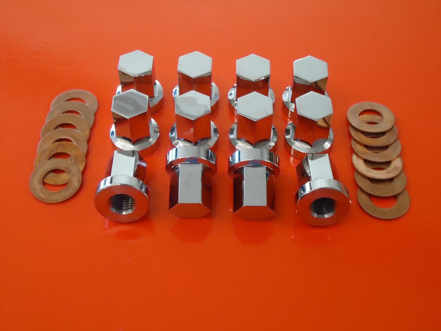

No eBay APP ID and/or Cert ID defined in Kunena configurationSome month ago in the "E-Bay / Craig's List Thread" early cyl. head nuts in Stainless Steel were available.
www.kzrider.com/forum/13-bike-related/60...ere?start=240#791215
0 available at the Moment, i wish i had order a set earlier, damn.

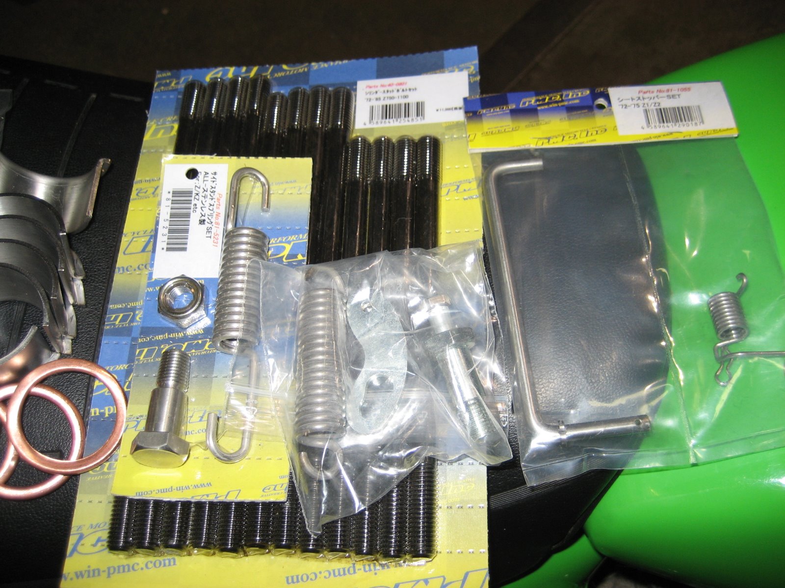

Those APE nuts look like black oxide which is crappy in terms of rust prevention. The metal is likely (much) stronger than stainless though. Take your pick...
Re: Replace Head Nuts
03 Jun 2019 18:10 - 03 Jun 2019 18:15
Nessism your are right about APE nuts but without any (much) stronger APE/PMC [studs it´s a waste of Money!
For normal use SS nuts are the better choise....

The APE nuts are a race part. Made super strong to be used over and over. Much stronger that Stainless steel. The finish is black oxide for appearance. It is not a rust preventive.
