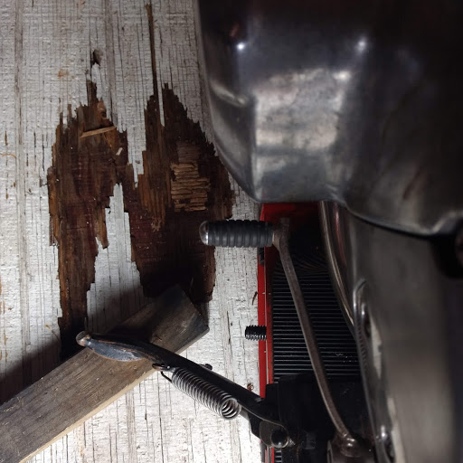

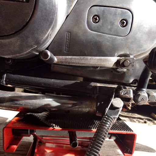

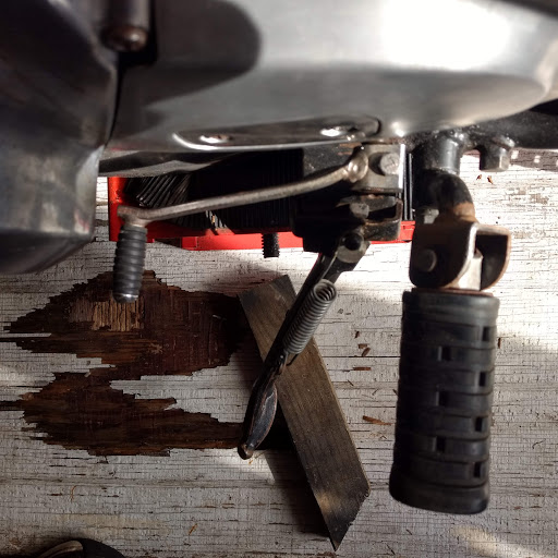

sure, here's a couple more :

Looks like you have strange angle on the end?

It looks bent to me. Why not just straighten it? Ed

650ed wrote: It looks bent to me. Why not just straighten it? Ed
Your right , At first i thought it was bent at the end where you get it with your toes but it ended up being bent down close to where it mounts up... ended up putting it in a vise and tapping with hammer to bend it back out..
