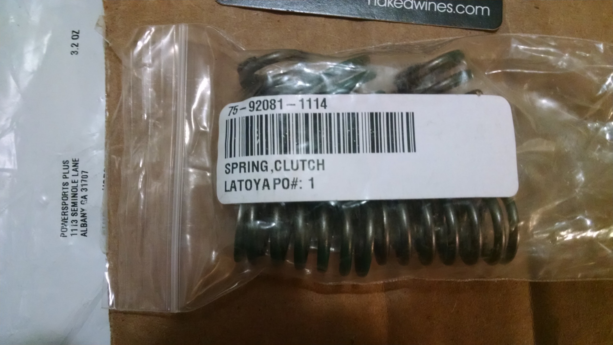

I received a suspicious package in the mail yesterday.
28 Oct 2018 21:18 - 28 Oct 2018 21:47
But, Wheww (sighs of relief) No fake bombs for me, I'm not important enough. lol
... it was just the Kz1100 clutch springs I ordered from Partzilla last week. I know if I still drank liquor, I'd be a flaming alcoholic if I used those "$100.00 off" coupons on $160.00 order, that they keep sending me (WHO buys $160 bucks worth of ANY alcohol a pop?).
I ordered the new OEM 92081-1114. My clutch stared slipping again when rolling on the coals, after I put the Delkovic SS exhaust on my bike. With the cool weather, my butt dyno tells me i added ~10 ponies with the new header and cool crisp air.

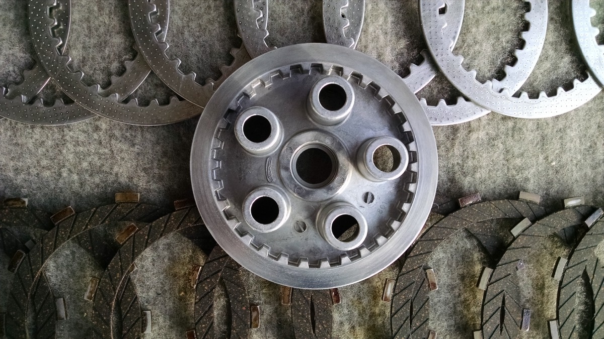

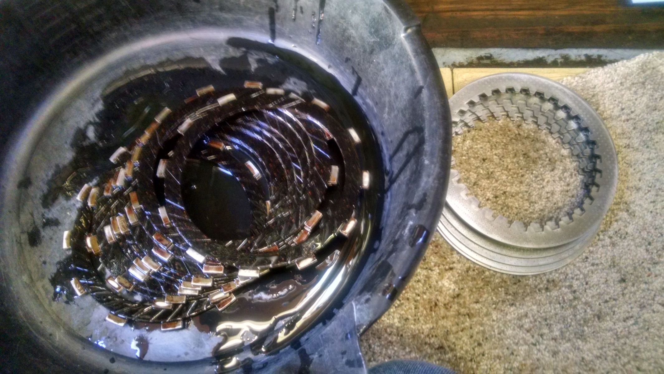

I took the clutch apart again yesterday and inspected the frictions that all measure at .115" (.110" is service limit per manual) They are hardly worn, but looked glazed. I soaked them in Zep citrus degreaser overnight, rinsed and dried, and they still looked glazed, so I laid a piece of 400 grit 3m sandpaper on a flat piece of plywood and scuffed both sides, then scrubbed them again in the degreaser. then I rinsed and air dried them again. After all of that degreasing my hands are completely void of any oil, I sure hope the clutch frictions feel the same.

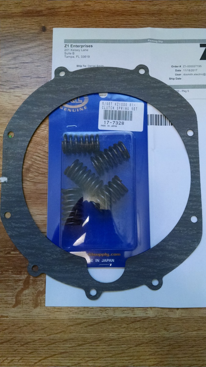

I inspected the springs, but I don't have a spring scale, so i have no way of checking how weak or strong they are. I had already replaced the springs and did the degreaser thing on the clutch ~ a year ago, and had ordered the Kz1100 springs thinking that they might be stronger than the K&L springs I bought from Z1E the last time, BUT, I started measuring the wire diameters and found the new Kz1100 spring wire diameter to be .105". ,, The original stock springs wire diameter measured .110" , and the K&L springs wire diameter measures .115". I realize none ot this means squat, without being able to measure the spring tension. I reused the K&L's based on them having the largest wire diameter. I need a spring scale! :woohoo:

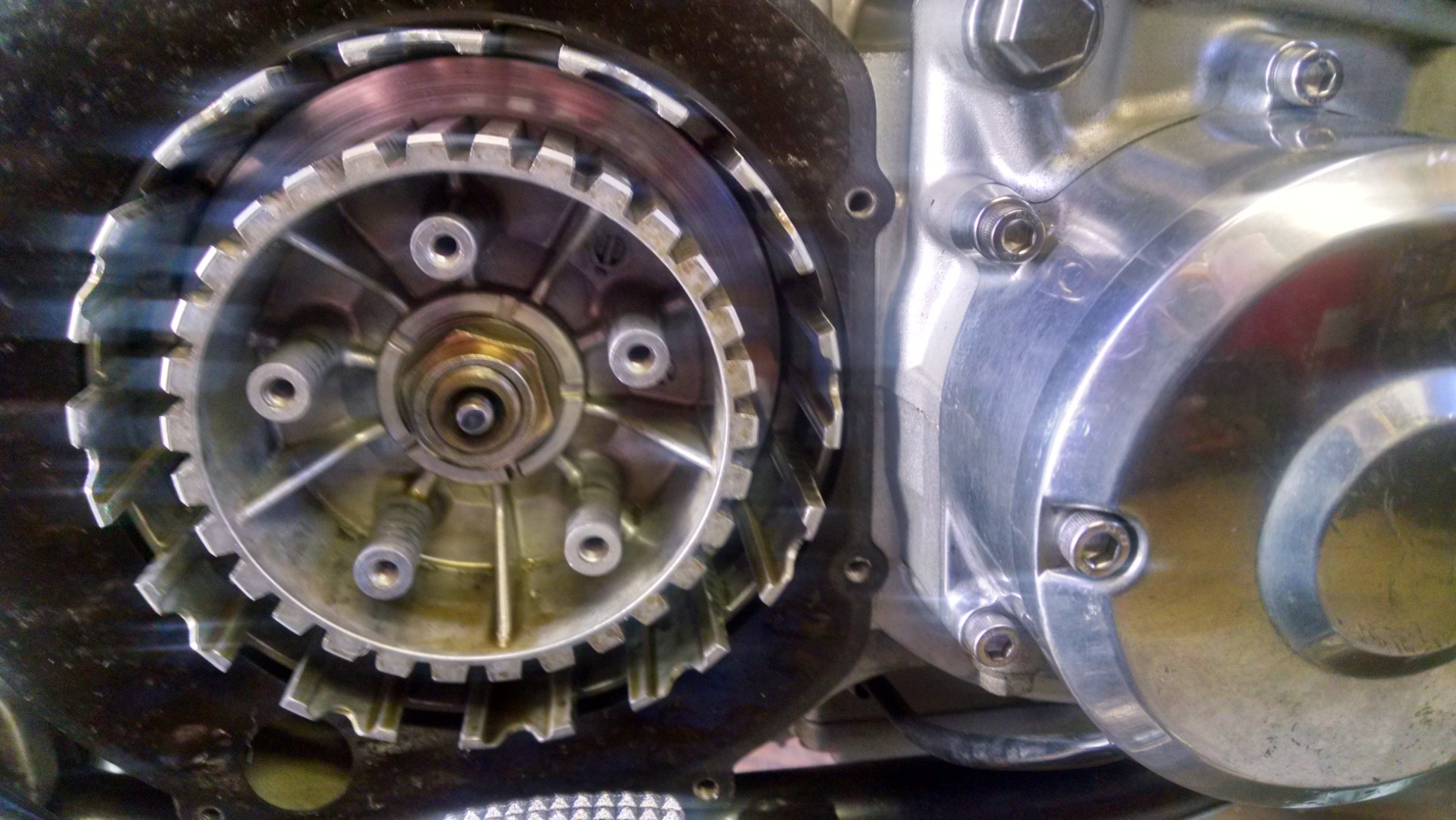

The 1100's require 6 springs, but 5 with the 1000's. I don't get why, considering how much the J-engines are identical.
Also there are two different Kawasaki clutch cover gasket designs that will fit either engine. The 11060-1070 shown in your pic, and 11061-1126.
Is there a particular reason to use one gasket vs. the other?

That makes sense Dave. I didn't know the Kz1100's had a 6 spring clutch basket. My Kz 1100 / 1000 service manual doesn't show it, but I might have missed it too, That would explain the weaker springs. Know anyone that needs 5 springs for a 6 spring basket?

That's what I was going to do Dave. BUT, being the genius that I am, I ordered the Kz1100 OEM springs of which are weaker than the stock springs. The K&L springs should still be good since they are almost exactly one year old. BTW, the above pic is from a year ago when I cleaned them up the first time. I didn't take a cleaned up close-up pic this time around. They didn't get better looking in the past year, unlike myself.

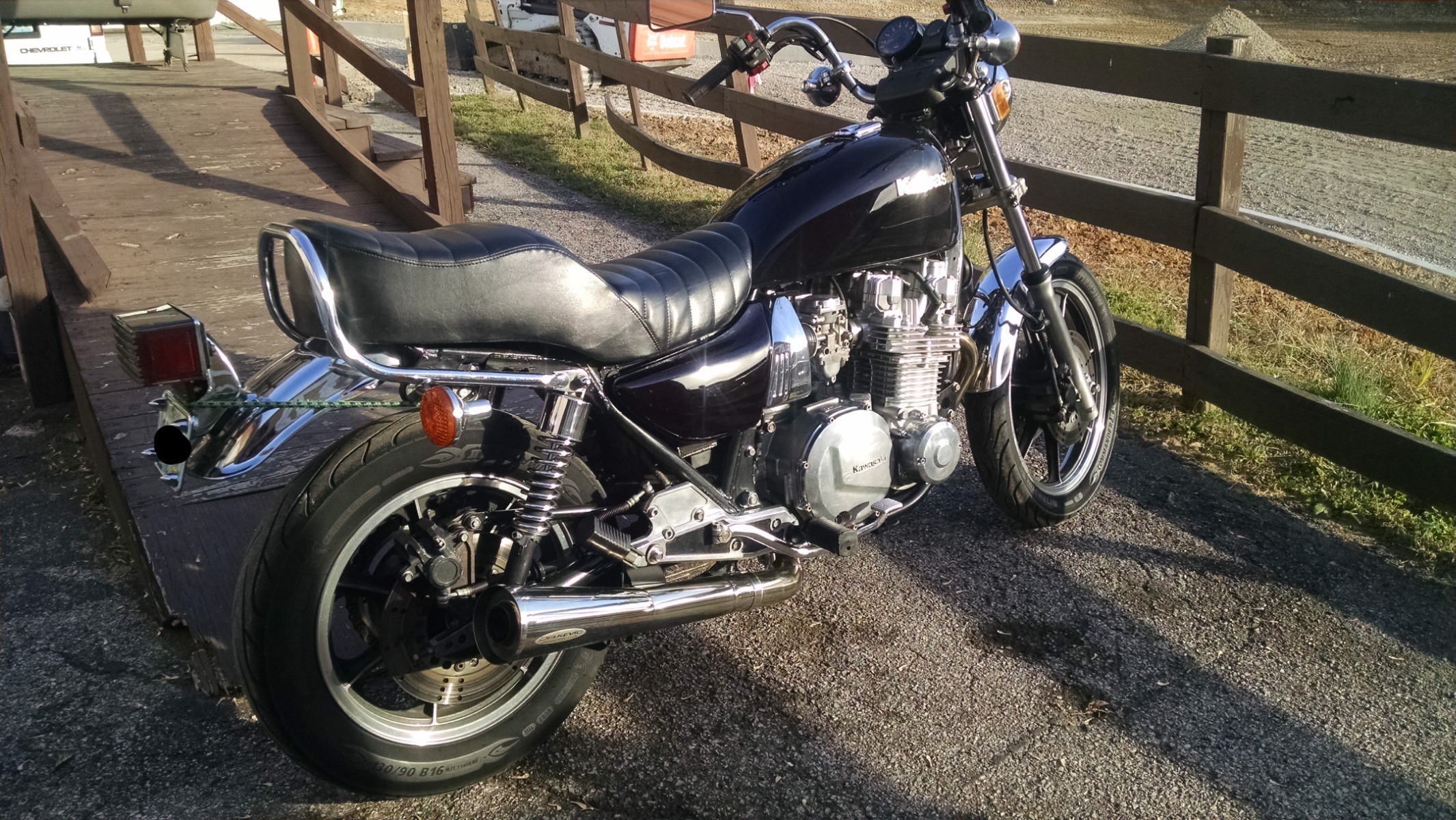

Yes! Beautiful cool fall weather it got to 70 F with clear skies. The bike ran great. No slippage, but I didn't hammer it too hard. With the new header it's not as quiet as it used to be. It is wicked LOUD. lol
I'm just guessing here without a spring scale, that the different part number for the Kz1100 is a different spring. Since it uses 6 springs, using the same spring would make the lever pull too hard for most. (pure speculation on my part) Kawasaki probably used 1 more, yet slightly weaker spring on the 1100 models.
The Kz1100 part number is 92081-1114 The wire diameter is .104" measuring the new partzilla springs
The Kz1000 part number is 92081-1033 The wire diameter is .110" measuring my original springs
The K&L aftermarket springs from Z1E pictured wire diameter is .115"
They are all identical in every other aspect.
I snapped a pic just before I hopped on it last nite.
