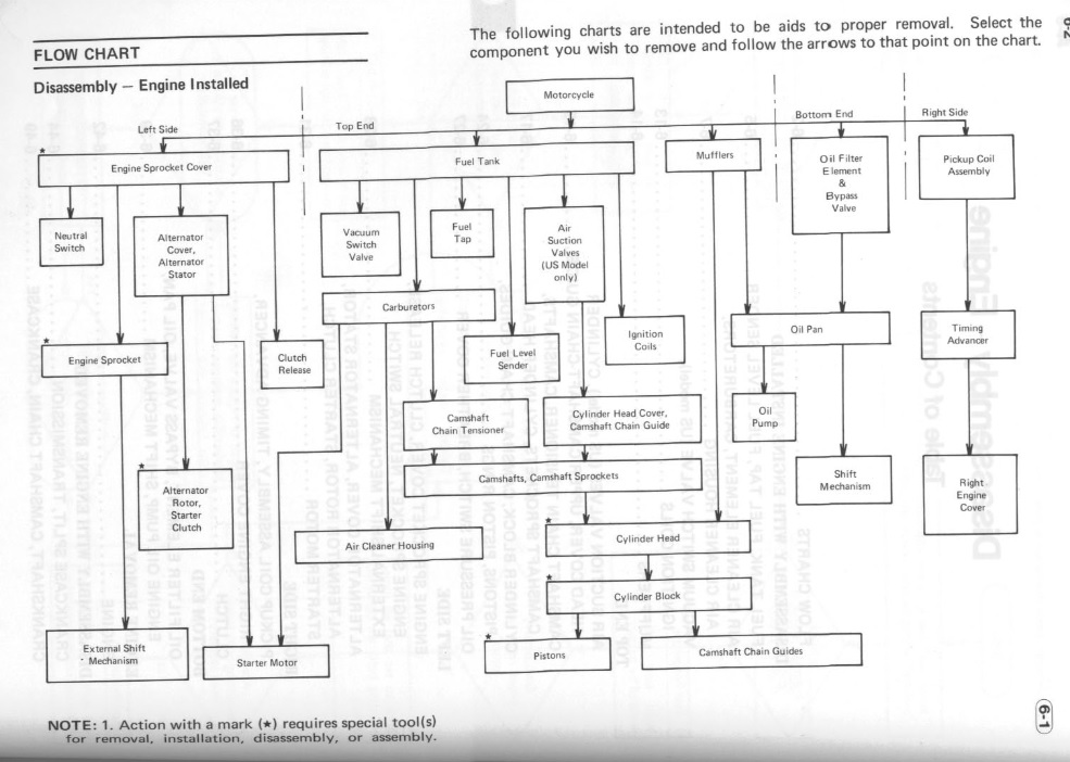

Yes you can.
Download the manual from this site or if you already have one refer to the Engine disassembly - Engine installed section and follow the instructions step by step.
I removed the tank, the carbs, the coils to make space. Then you will need to remove the smog covers and then slide the camshaft cover towards the back of the bike.
Then the pipes and everything else.

Here's a link to the FSM (Factory Service Manual) found on KZr's Home Page > Z Information > Service Manuals.
www.kzrider.com/modules/ServiceManuals/K...Service%20Manual.pdf
See page 6-2:
See page 6-2:
