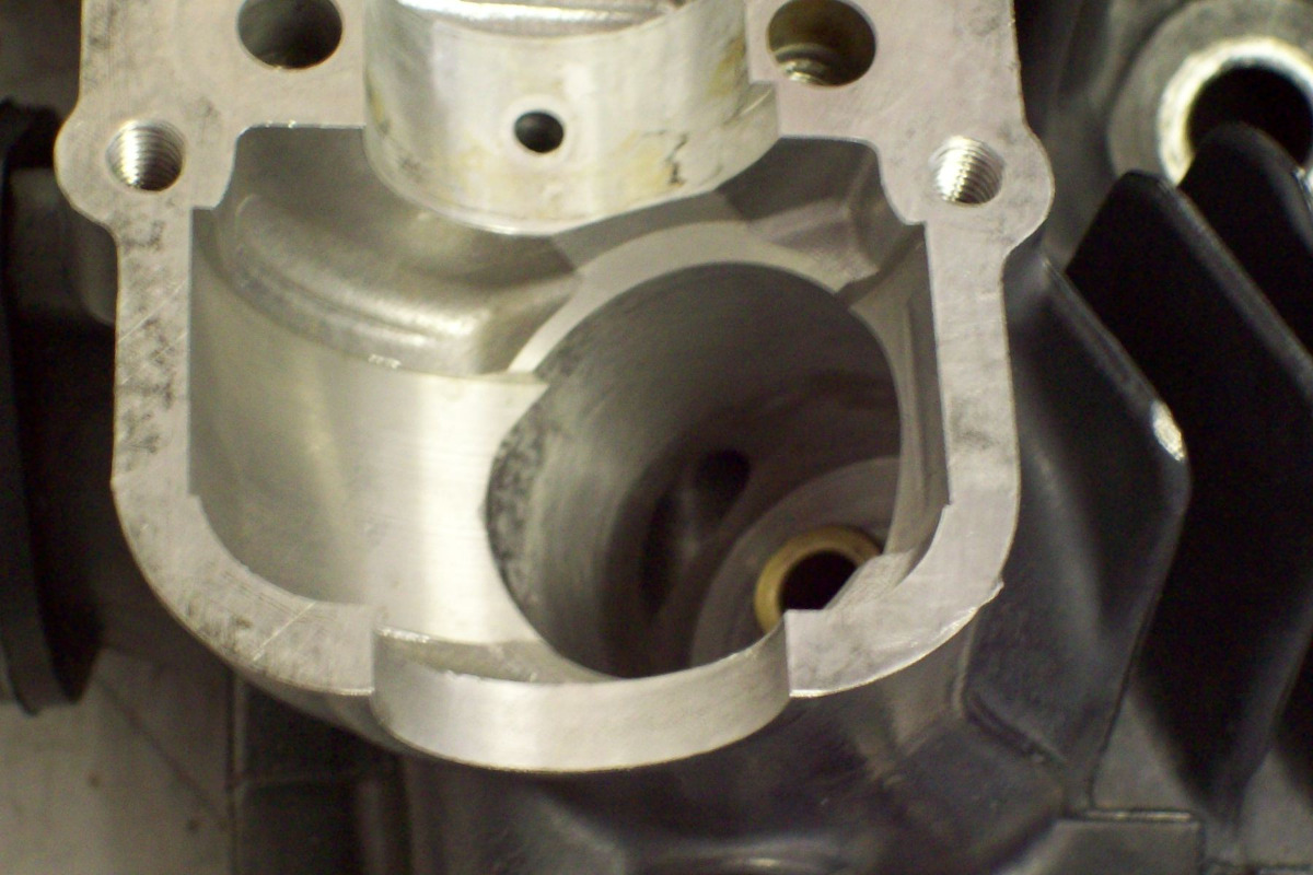

Only remove the needed metal from the thrust sides of the cams in the head. Remove only what is needed to clear the cams. Also check if you need to remove the "X" 's that are cast into the valve cover too!!!!
Just take you time, and you should not have any problems!!! Just make sure you get all the chips out of the head!!!!
This is what I had to do to my head to clear .440 lift cams.

Thanks for the tips guys. basically just as little as you can remove to clear them. Is there a specific clearance I should be going for from the end of the lobe to the head? Looks good Gamma, what'd you use to get such clean cuts?
