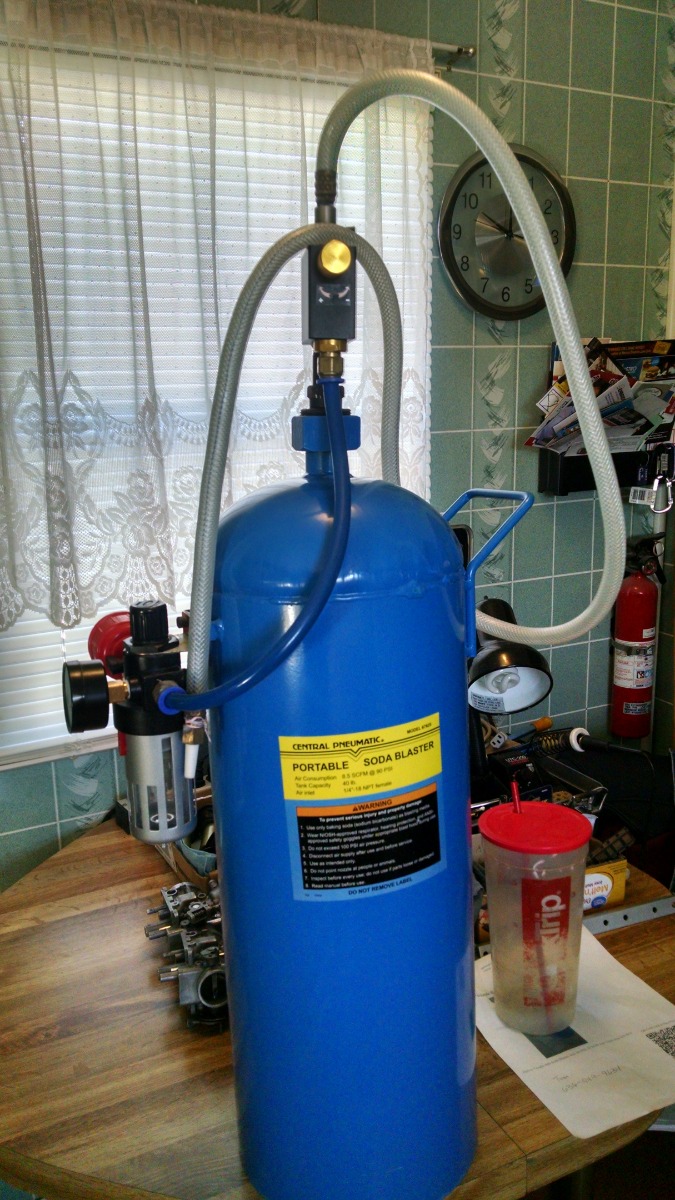

I shucked a freshly rebuilt SBC crank when I was in college (2 year college auto mechanics course). It didn't go 100 miles before the glass bead ate the bearings. (against my instructor's advice) What works for you might not turn out so well for others. (lots of little cracks and crevices) Anyone considering glass bead blasting internal engine parts, should know the possible pitfalls. Soda is water soluble and will not eat bearings.
Mineral spirits is ~7.95 (?) a gallon at HD. 7.95X5=$39.75 readily available everywhere in this area.
Pick your posion. You will be the one paying for the repair.
Harbor Freight 40 LB soda blaster.

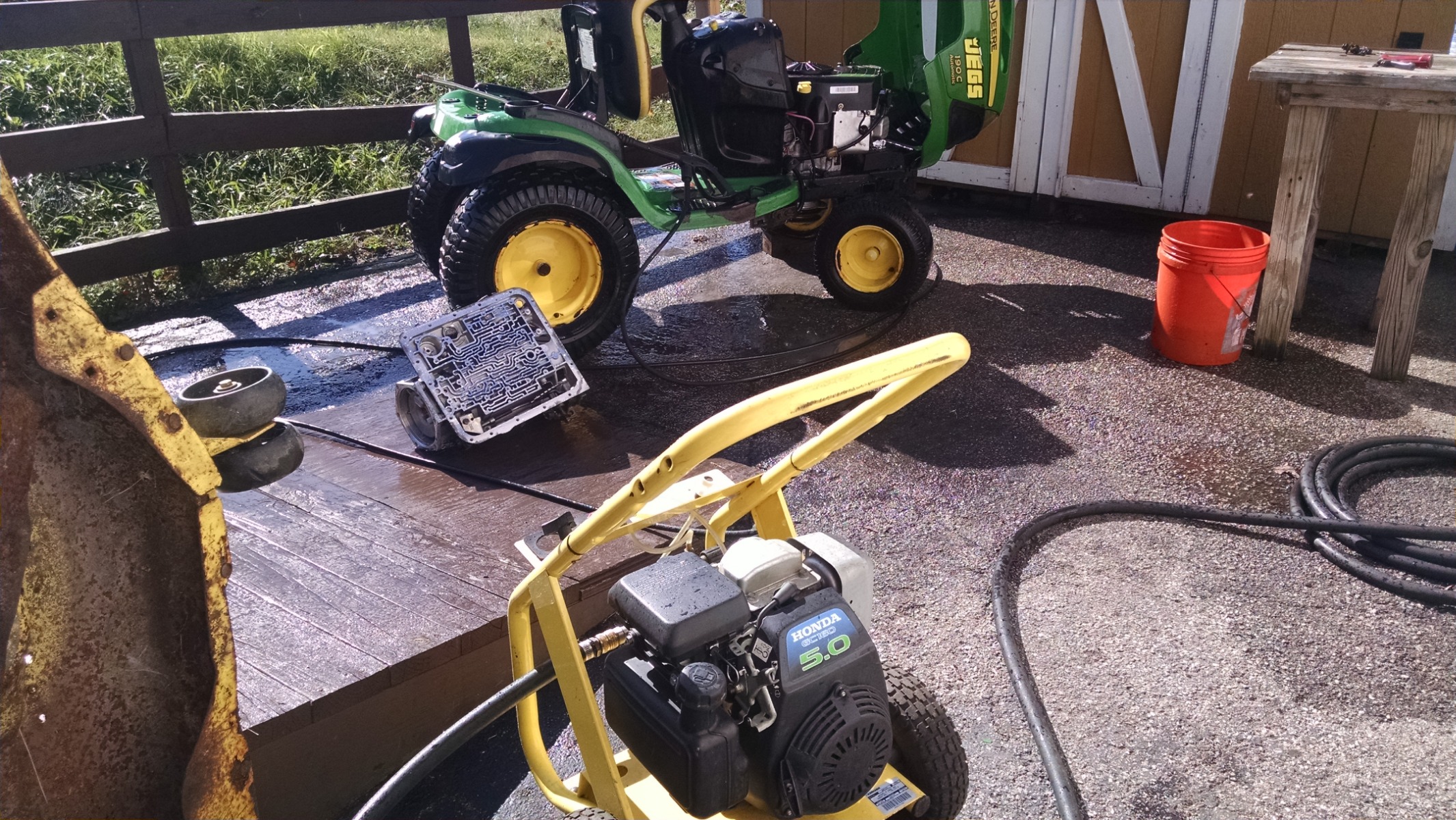

02 Sep 2018 22:30Nessism wrote: You can use simple green and water to clean the cases. Don't even need solvent.
True that! A 2400 psi pressure washer and simple green or engine degreaser will flat clean the stuff up. You may need to clamp it down to something, but I usually just try to lay the stuff on plywood or something, and try not to blast it across the street.
