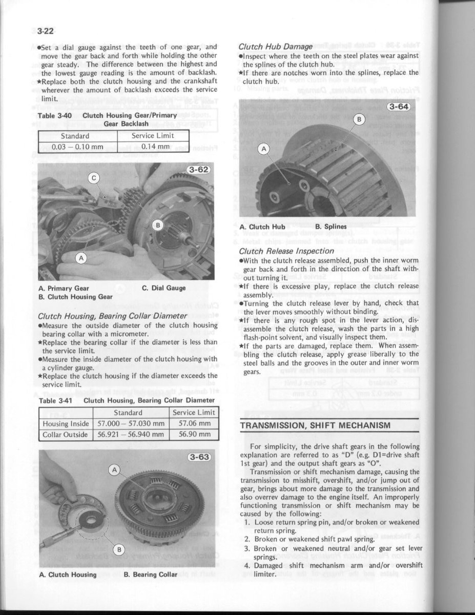

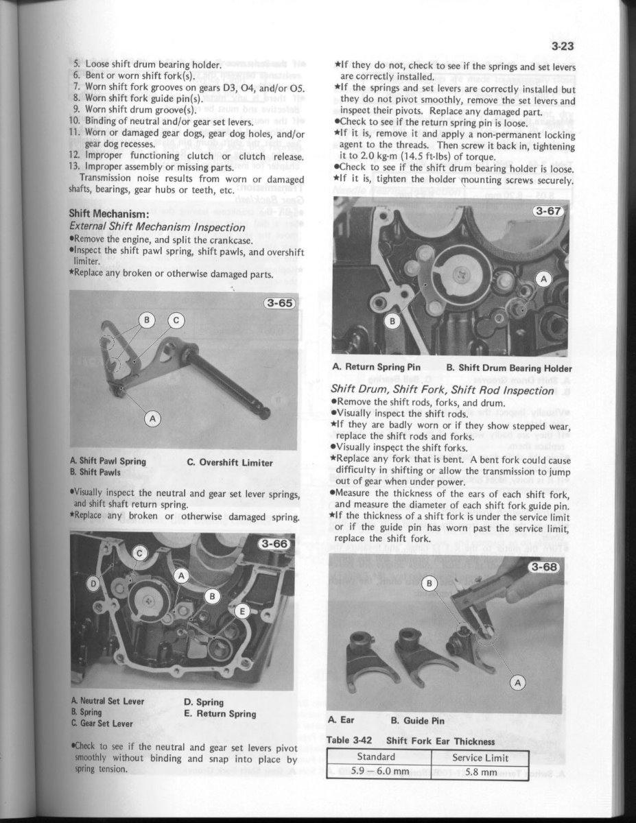

Is pulling the trans cover splitting the case? Sorry to sound foolish
Re: 1982 kz1000 drops itself into first
27 Aug 2018 17:55 - 27 Aug 2018 18:00
Last edit: 27 Aug 2018 18:00 by Scirocco.
