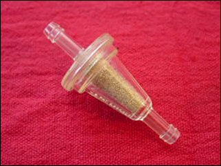

The type of filter that flows with a gravity feed fuel system won't filter very fine (like that type with the gold stone inside), so it doesn't surprise me that rust dust is getting through. And by virtue of finding rust in the carbs that's evidence that the tank is not properly clean, even though you may think it is by peering inside the tank through the cap.

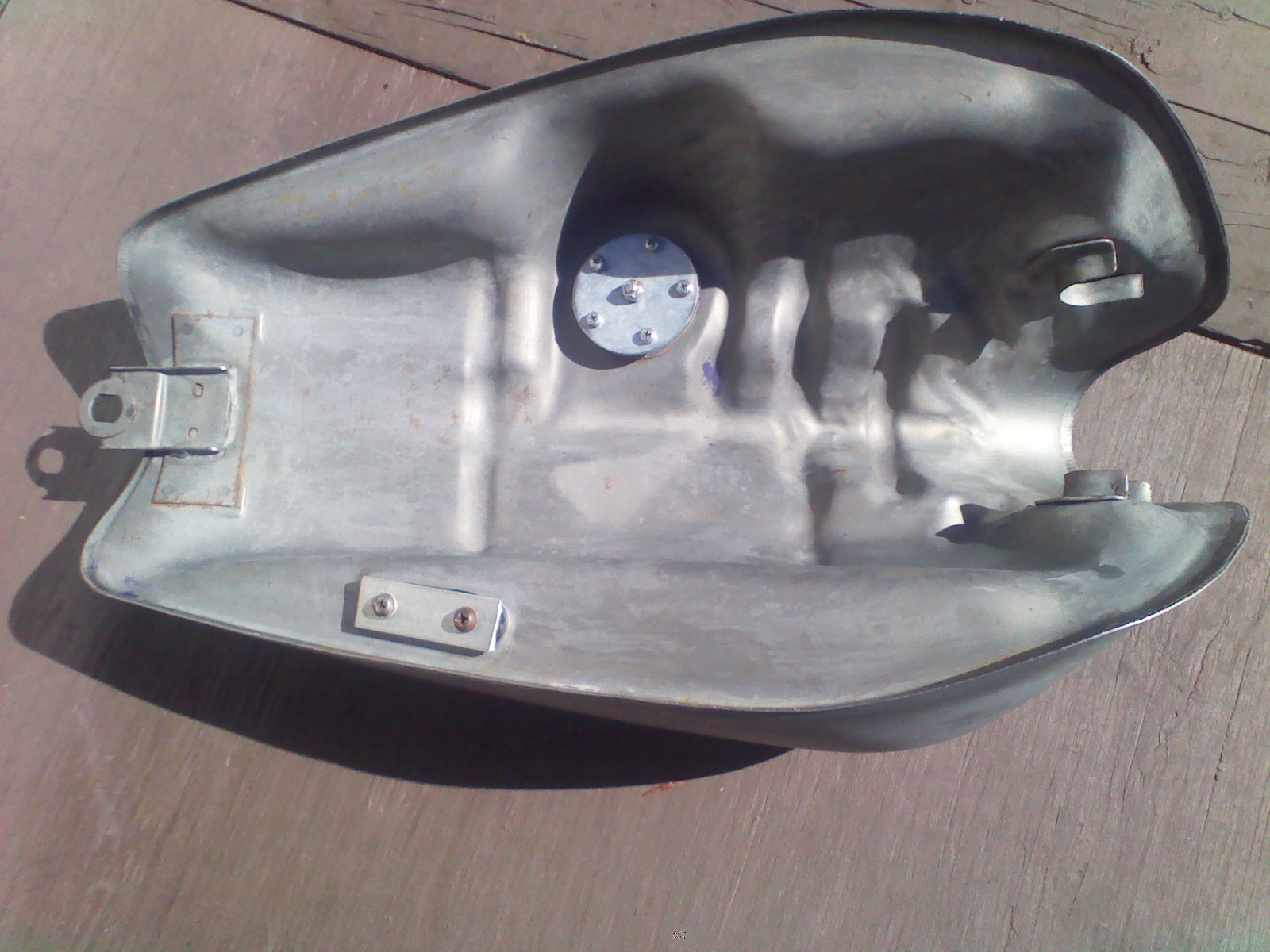

I'd derust the tank first thing. Evaporust works good and is safe for the paint. There are other derusting products that will work just as well and are cheaper, but they are harsher. Before derusting you have to fabricate plugs for all the various openings such as the petcock hole, main filler, and any fuel gauge that may be present. There are tons of derusting threads so I'll stop here and encourage you to search out more info if you need it.

Derust the tank for sure. After that use a good fuel filter. I use a Golan Super Mini 5/16" fuel filter (70-312G 5/16 Barbed Fittings). They are not cheap, but one will last a lifetime; I got mine from ronayers.com. They use a stainless steel filter element that can be cleaned. They filter out very small 10 micron particles but still pass fuel at a rate of 6 gallons per minutes – MORE than enough for any bike. They are very small so they fit well under the tank. Also, I used a 5/16” stainless steel elbow to make the bend from the tank to the cabs so there is zero chance of the fuel line pinching. I got the elbow at a place that specializes in propane supplies. Ed

in chasing this demon, I hope you aren't causing more problems for yourself in the fuel / air department from your mis-diagnosis. OR sealing a bunch of crud into your gas tank for eternity by coating it without actually removing the rust and scale first. Coatings are meant for leaking tanks. I posted a few links to some good non-toxic gas tank cleaning articles a while back. For cheap too.
Metal rescue is kinda pricey, but it works well. There are others that are cheaper, but it will not harm the paint, unless it has ferrous metal in it. (red iron oxide). The "wood bleach" stuff is cheap on ebay, but I have never used it.
