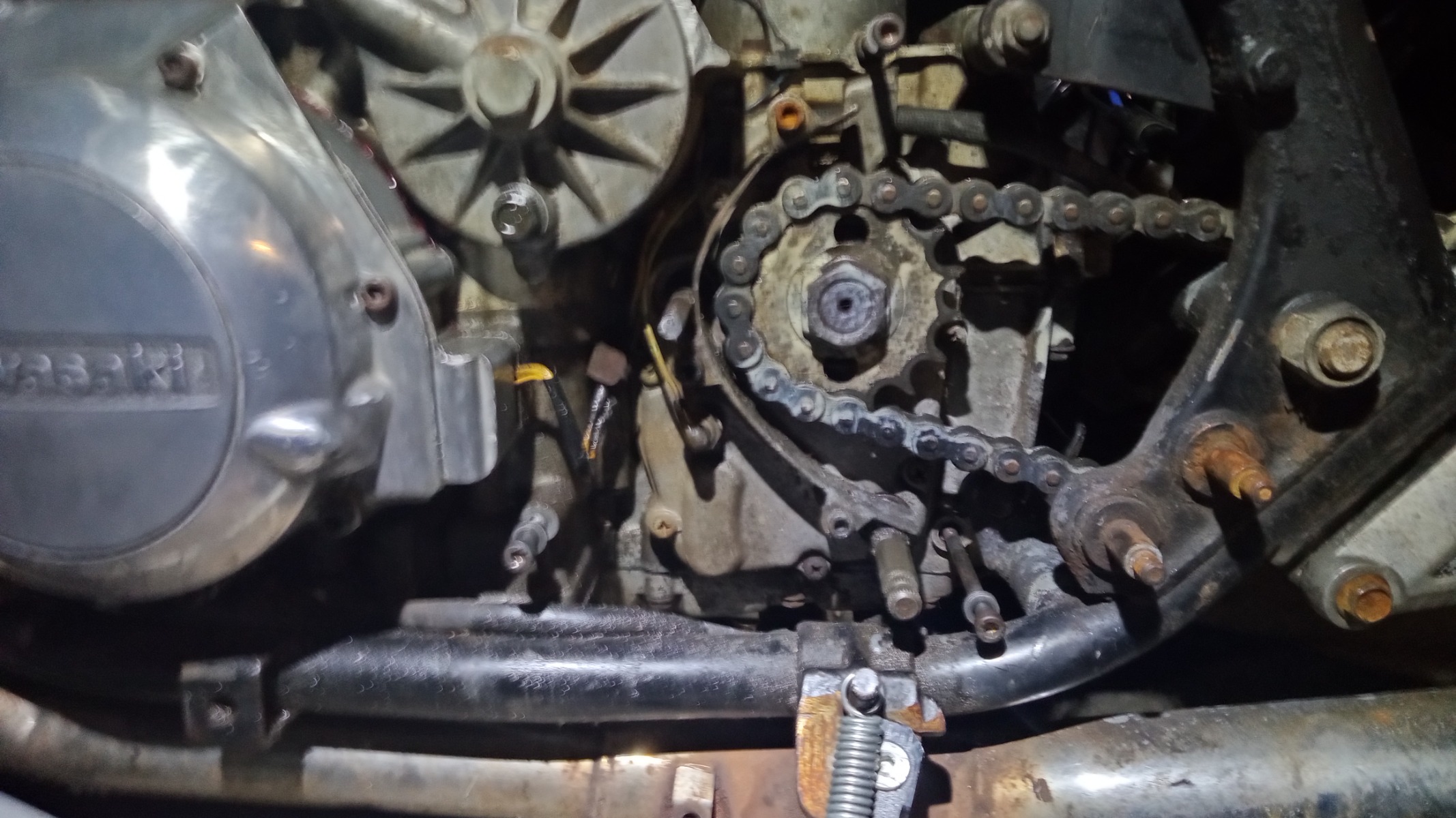

Somebody know about a step by step guide install hydralic clutch to kz750 engine?

FYI I did get this working with zx9r master and slave cylinders. There are a few details in my KZEFI project post.

Did you happen to measure the stroke length that is required for the mechanism?

I'm trying to make one to fit my 82 750 m (CSR) do you have any reference material as far as measurements or anything like that I'm having trouble I've measured them manually with a caliper and I think because of the front the diagonal distance between the bolts with spacers and not is giving me off measurements so
