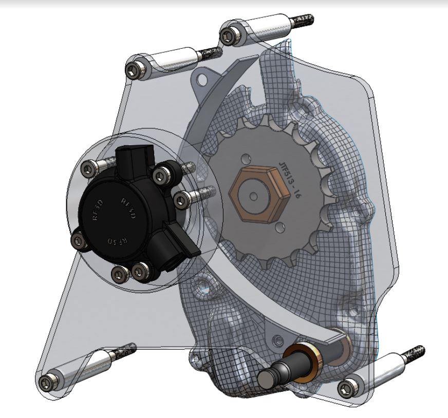

Weird things happen when you stare at your bike too long. The previous owner had ditched the electric starter, leaving a gaping hole in the side cover. The mismatched / road-rashed levers looked goofy. I had just installed an APE HD clutch and push rod roller kit. And there was an Honda RC51 clutch slave cylinder in my parts bin...

A "nice" uprising sun Japanese war flag design.
Who made this hydraulic sprocket cover???

Thanks, I designed it in SolidWorks (top picture) and my buddy machined it out of 6061 aluminum

Hey Grant, if you're still active on here by chance, could you send me a drawing with the bolt pattern of the kz650 clutch cover? Thinking about using a zx9 slave on mine.

Hey Saablord, I can send you dxf or step files - let me know if you can work with those.
I haven't had any problems with the hydraulic clutch in last two years and it worked first try (but I did spend a fair bit of time reverse engineering all the components first). I'll agree it has greater potential for catastrophic failure than a cable, but I have no more cable to lube or adjust
This hydraulic unit was used by Honda for the better part of a decade, so I guess I'll trust it to work and have replacement parts. Not that any of this is reason to do the switch. I really just did it so see if I could.
I'm not sure that style actuator linked will be that simple since we don't have that nice lever arm on our bikes

19 Jun 2020 09:06 - 19 Jun 2020 09:06I use Inventor so either would work... send both? thank you! It will save me so much time.Hey Saablord, I can send you dxf or step files - let me know if you can work with those.
...Yeah that style of slave (i opened the link in a new tab... now it works) would have to be mounted to the lever on the existing clutch rod actuator... sounds complicated and ugly.I'm not sure that style actuator linked will be that simple since we don't have that nice lever arm on our bikes
