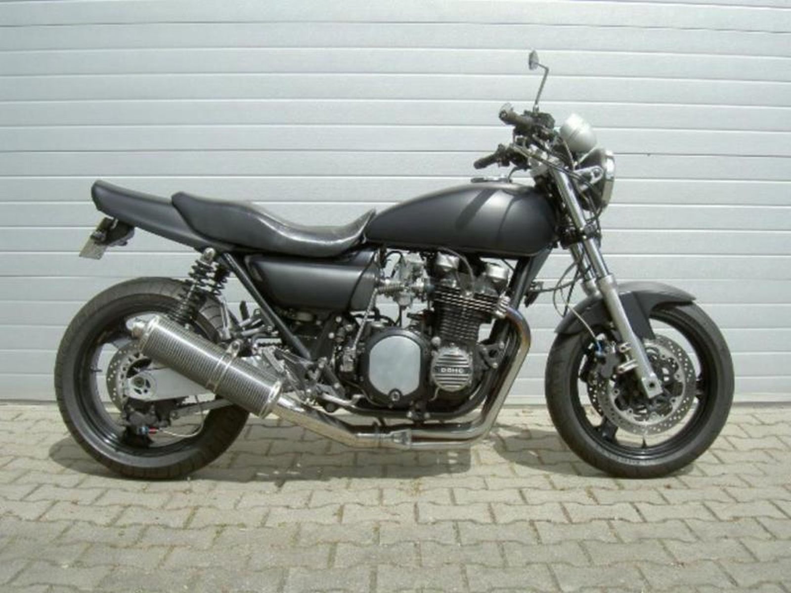

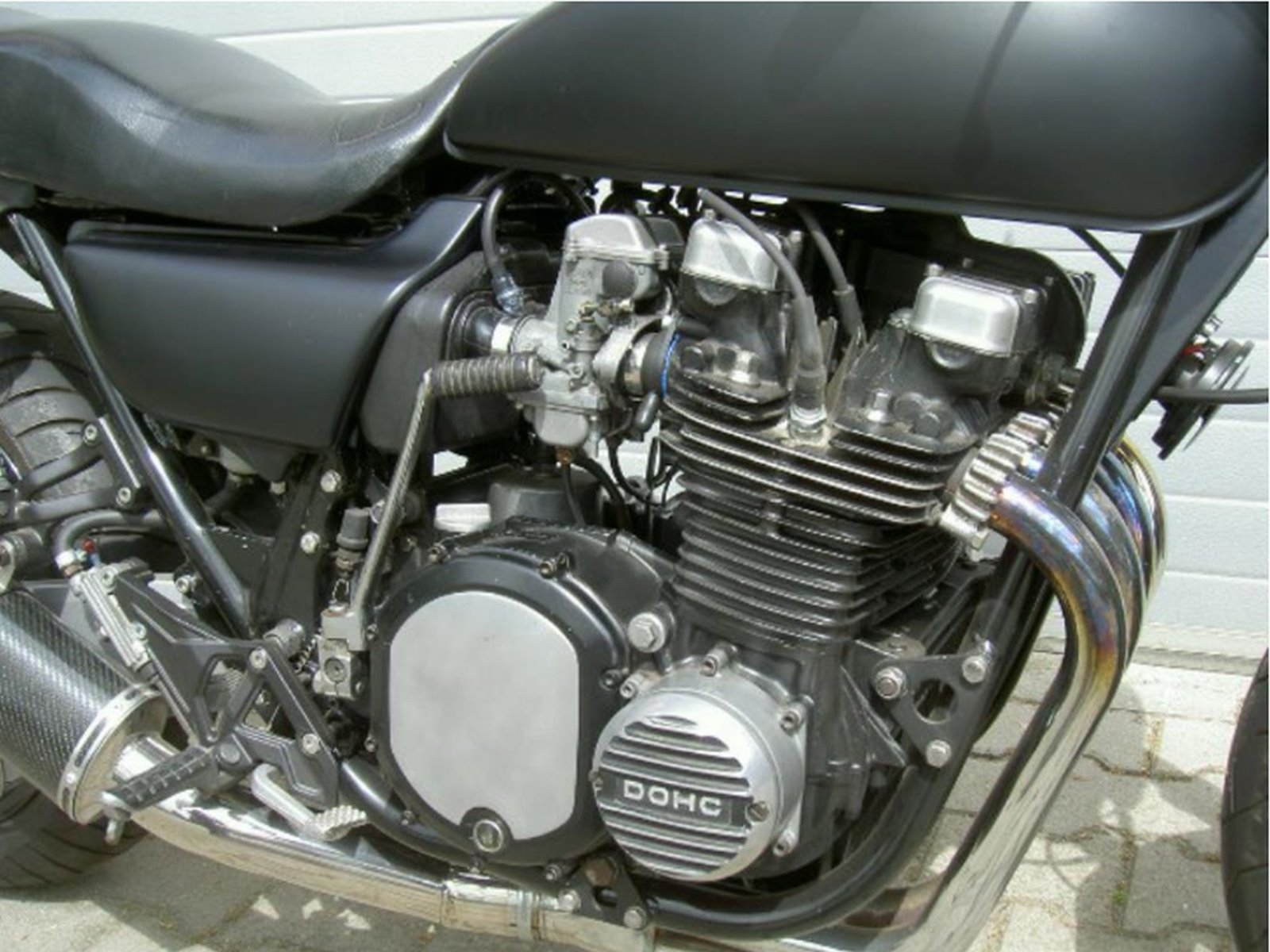

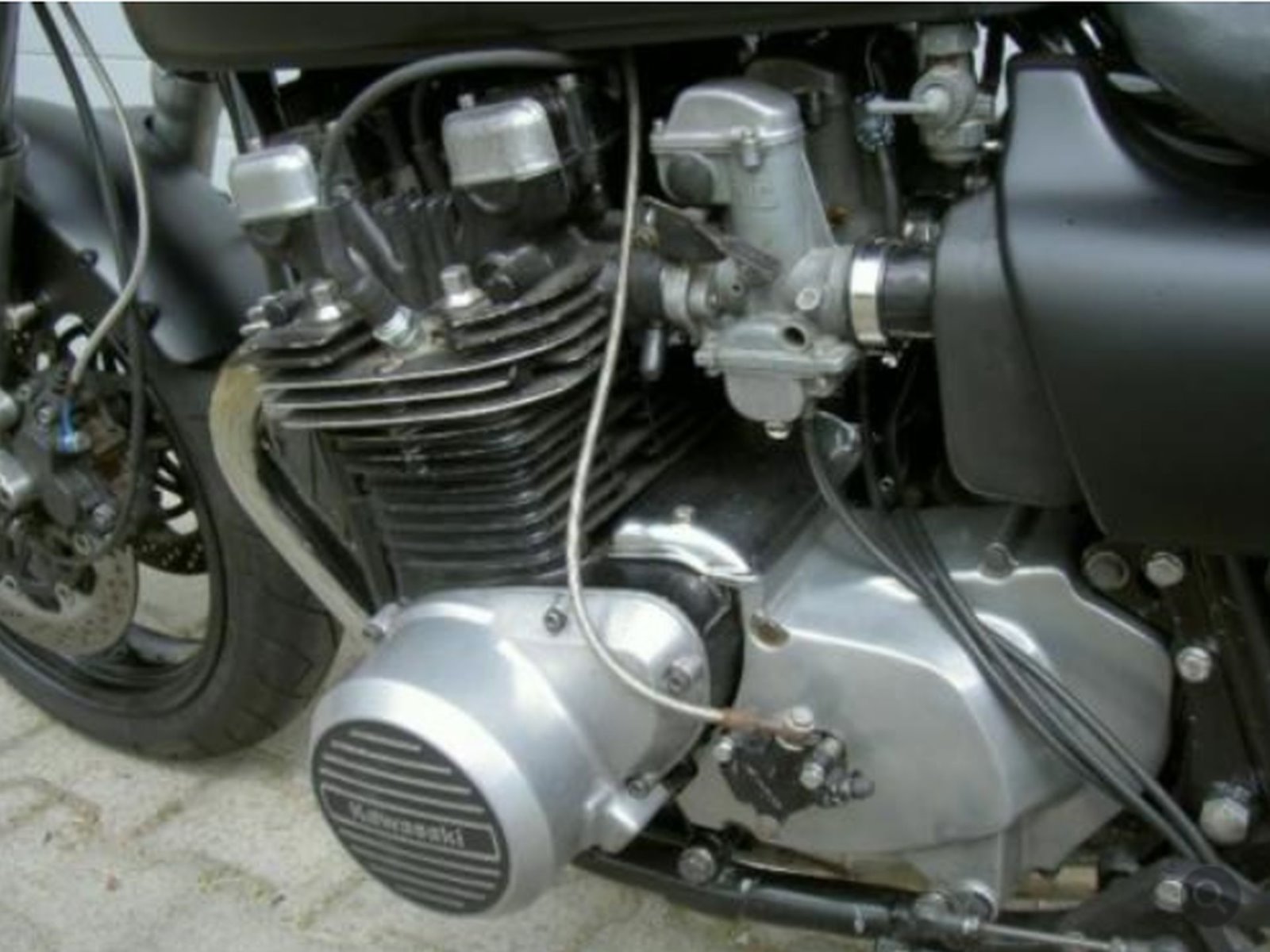

This is a MKII engine looks like.
Look at the rectangular form of the valve cover
16 tooth cam chain sprocket on the crankshaft.
32 tooth cam chain sproket on the camshafts.

Sorry Devin74
It´s not my bike, picture source is an evil bay private selling platform
www.ebay-kleinanzeigen.de/s-anzeige/kawa.../659388798-305-17442

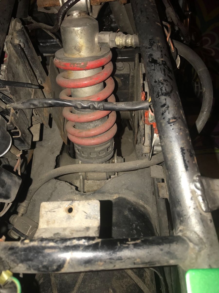

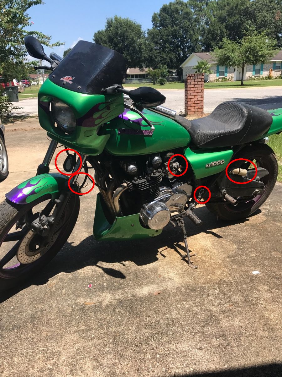

One is side marker hanging down one is the fuel line unhooked one is the remote reservoir to the shock I just threw the body parts on for a pic in the middle of paint and rewiring mount Dana coils etc here it sits now
