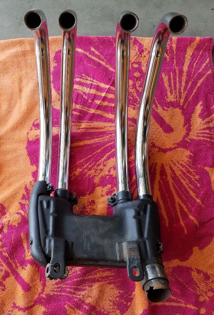

Thanks for the tips everyone. Just to add a visual, here is a picture of the Z1R header. This is not mine, I borrowed this pic from Ebay.
That's not necessarily true. If there is something corrosive on the inside, like an acid for example, I believe it would continue to eat the metal without oxygen.
I'm reluctant to use a strong solvent, as the collector box is painted black. The paint isn't perfect, but I'm not interested in removing it at this point. But I'll try to take a look in the output port and see if it's painted inside. If not, it seems like spraying with a solvent like carb or brake cleaner probably would wash out any combustion leftovers.
Maybe something intended to remove carbon from an intake would make sense. Do they make throttle body cleaner?
As for coating it for storage, anyone have any experience with Boeshield T-9 on chrome or painted surfaces? I happen to have a full can of the stuff.
boeshield.com/why-boeshield/
Here are some of the claims: "T-9 will not harm paint, plastic, rubber, fiberglass or vinyl. It can be used on engines, wiring and belts. T-9 is nonconductive and will not cause short circuits, so it’s also safe to use on electronics."
My guess is that it would be hard to get off of the inside, and then what? Does the wax ignite the first time start it up?
