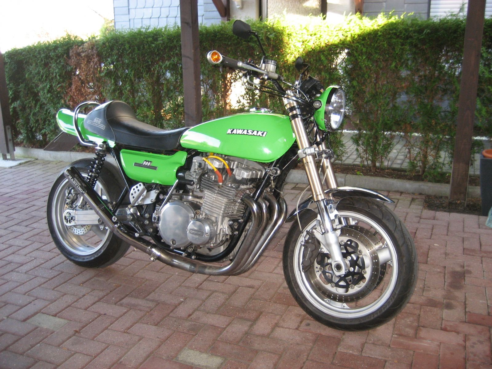

Thanks guys, sounds reasonable to keep the 630. Is there a supplier you would recommend for the offset sprocket? Here are pics of my bike. I have owned it since 1974. i am currently putting a 2005 ZR7S front end and rear wheel on!

A really nice hot bike you have!!!
Is it a stainless Delkevic race exhaust system on your bike?
I am located in Germany, a company called Krüger & Junginger made and sells offset sprockets.
How many offset do you need exactly for your front sprocket???

Thanks! Yes its a Delkevic Stainless exhaust. I really like the look, "old time Yosh". I measured this evening and I believe 12mm will do it. I really like the upswept appearance of your Marving pipe!
