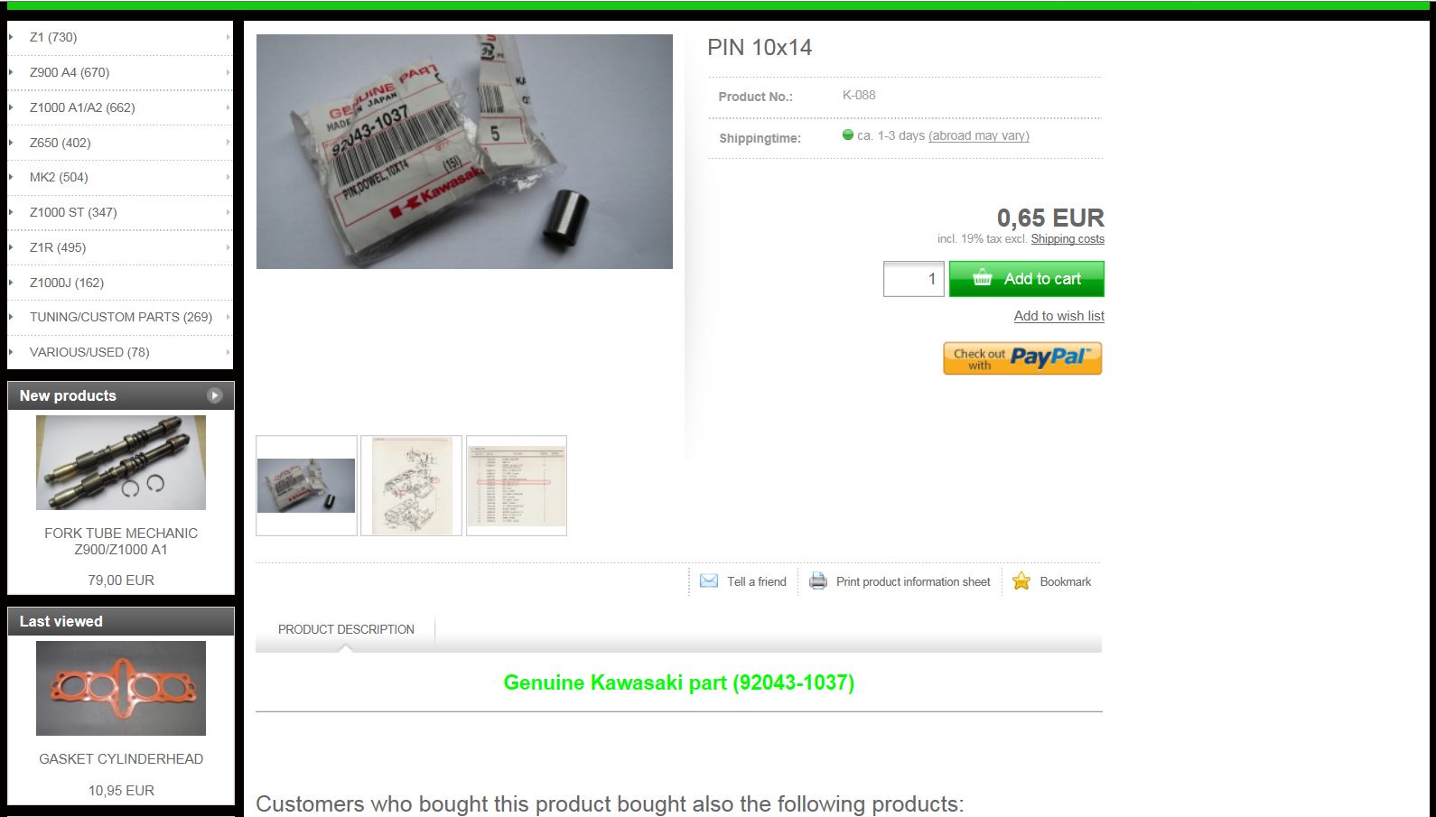

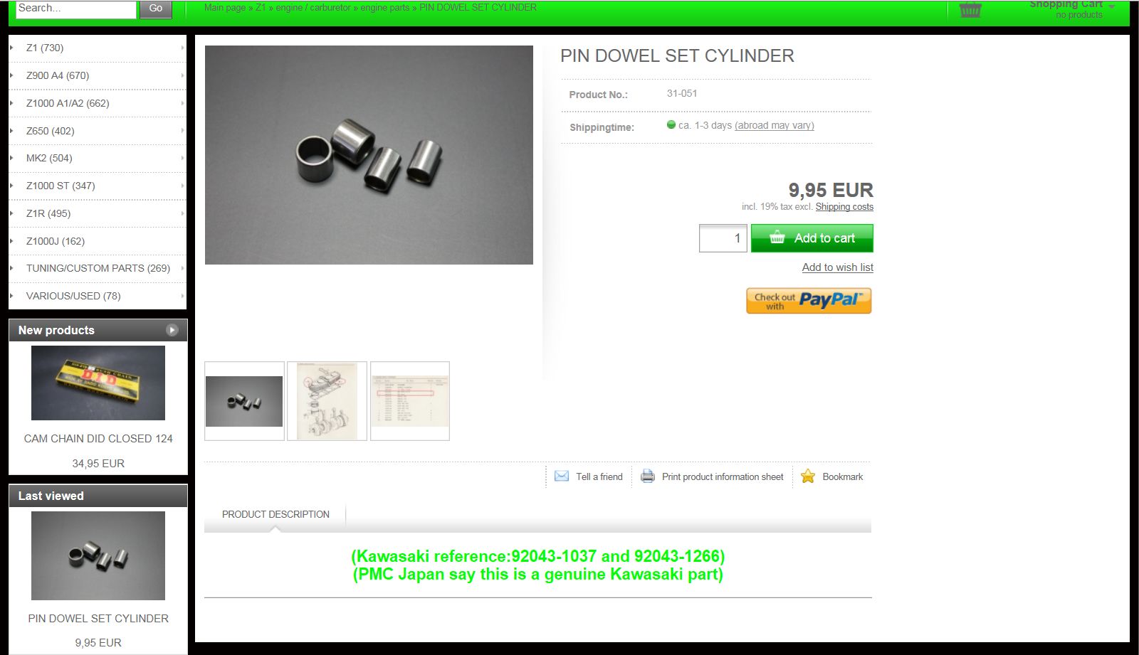

Re: Need part# on head knock pins
09 Jul 2018 15:13 - 09 Jul 2018 15:15
TexasKZ, excellent!!!
Kawasaki #:92043-1037, 10 x 14 fits in the cylinder and the crankcase.
Kawasaki #:92043-1266, 11 x 14 fits in the cylinder top and the cylinder head.
Lesson learned :whistle: :whistle: :whistle:
