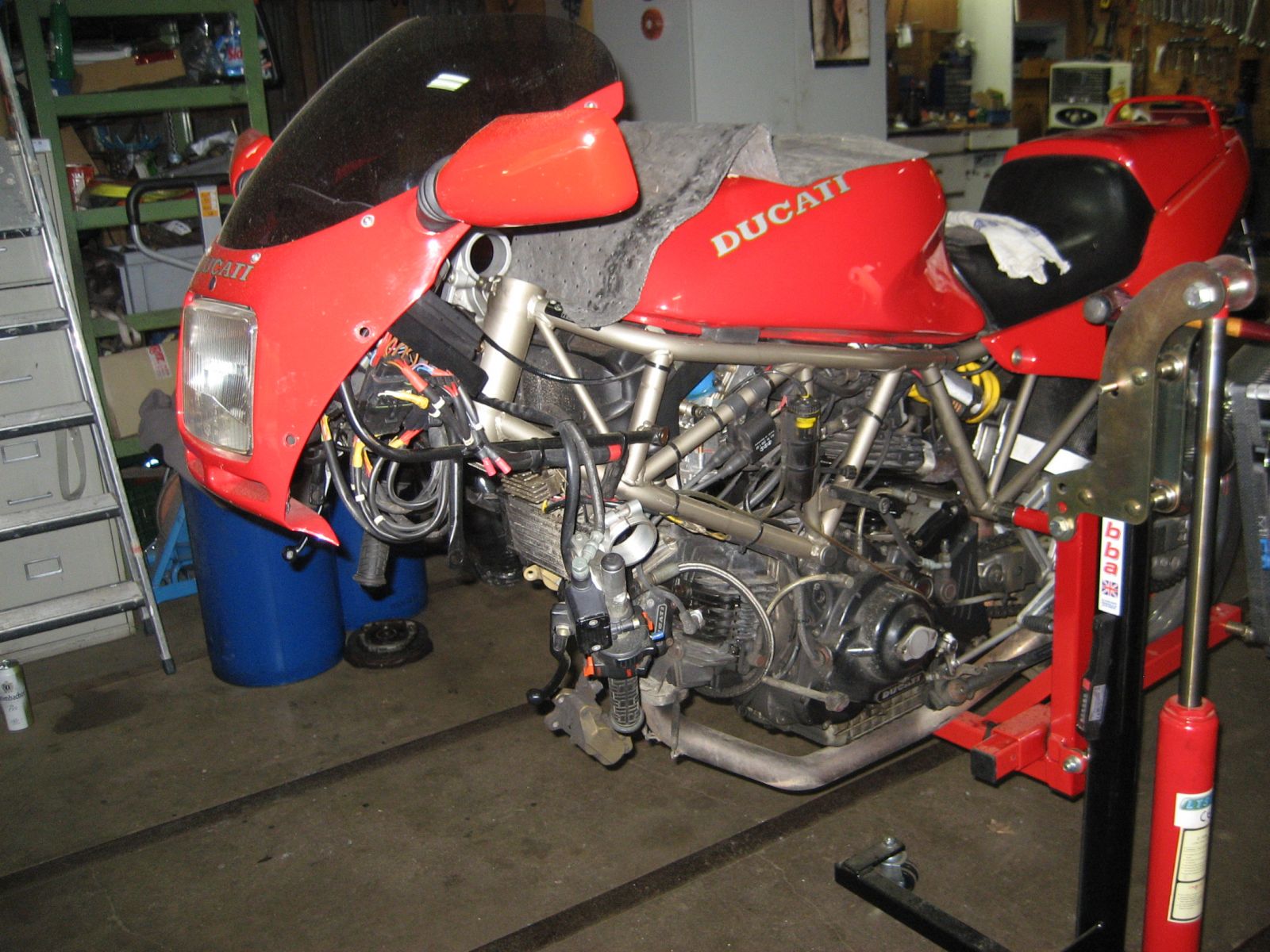

Trust me, i will it figured out this month how much parts are possible. :whistle: :whistle: :whistle:
I let you know after i re-newing the timing belt and adjust the valve clearance on the DUCATI.
Michael
Michael
