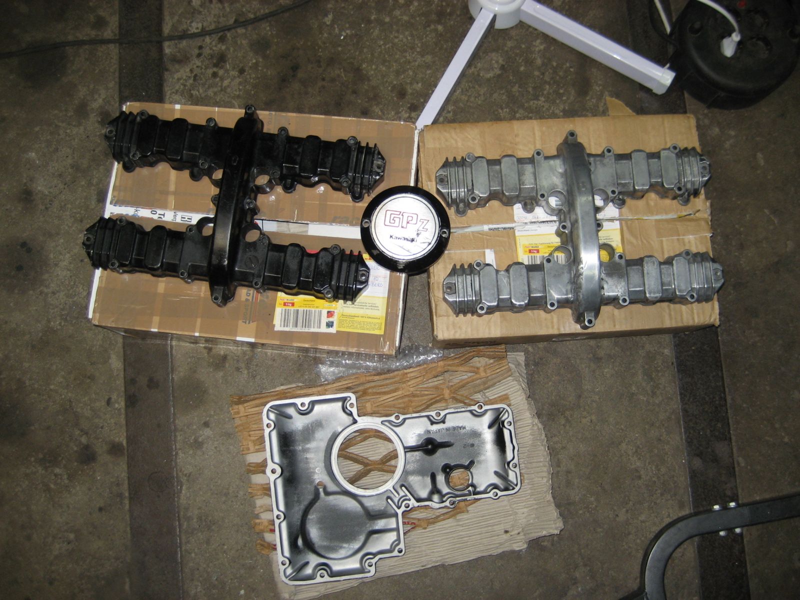

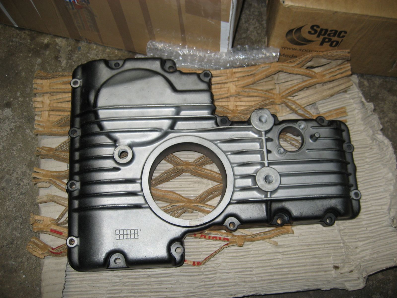

Got a free oil pan but what kind of bike it belongs to???
04 Jul 2018 15:01 - 04 Jul 2018 15:03

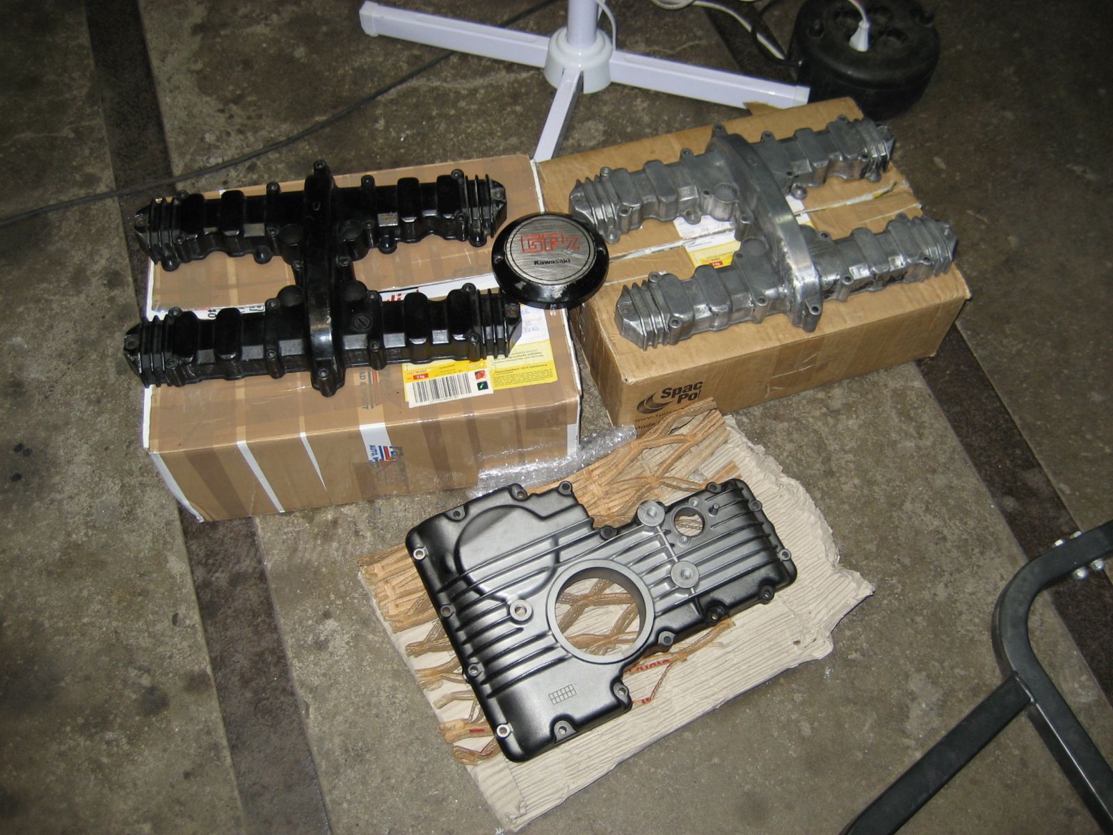

Got some non smog valve covers and a free oil pan/ignition cover add on.
Which bike do fit these parts, GPZ 750/1100???

No eBay APP ID and/or Cert ID defined in Kunena configurationThis one from a GPz 1100 looks pretty much the same, but it isn't identical to my eye. I think its from a ZX1100.

Cam covers fit all non kickstart 1000J/GPZ1100 type engines.
Ign cover is Geep 1100 but will fit all Z1 to GPZ1100.

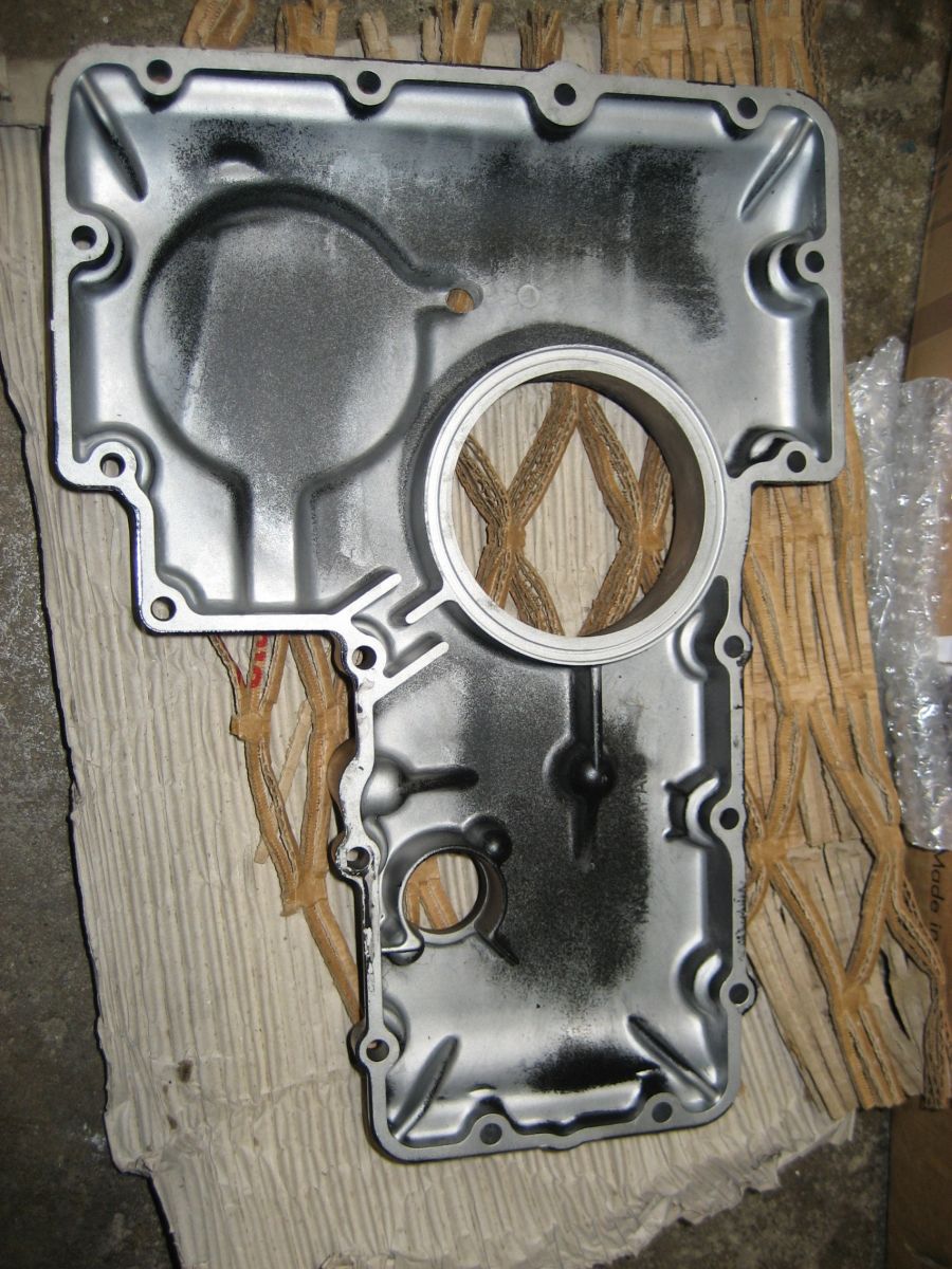

Oil pan is GPZ and will fit all Z1 to GPZ1100.

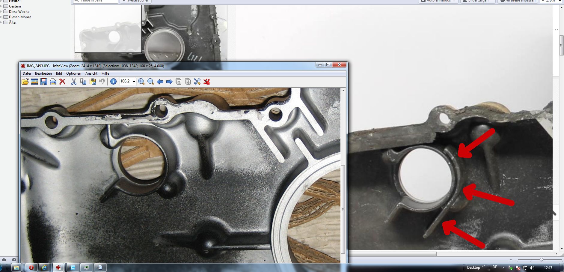

The only difference to my oil pan and the eBay oil pan is an additional fin in the casting of the oil level sensor housing. It looks strange to me.

The oil filter & drain plug orifices look different as well.
