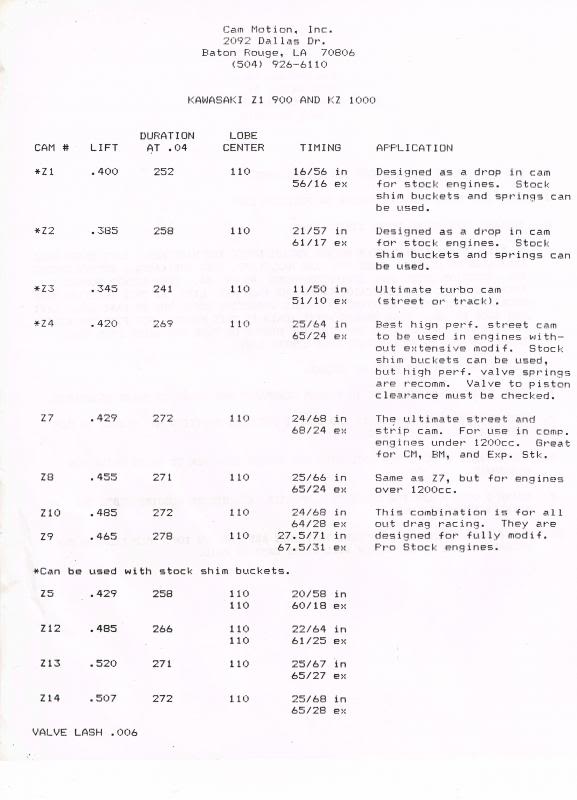

Here's a list of Cam motion specs.
7 and 8 are halfway down the list
Should tell you all you need to know.
