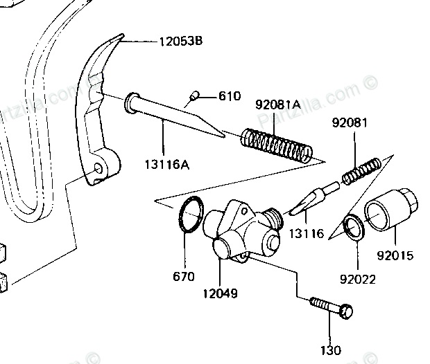

Well that's the thing... I've got this noise coming from the front of the engine. I think maybe it's an exhaust leak but it seems like it's getting worse, so it made me suspicious that maybe the chain wasn't being tensioned properly. When I pulled the cap off the tension pin appeared to be sticking out around the suggested 5/16" but then I thought I'd rotate the engine (with the cap off) so the pin was sticking out a lot further than that when I put it back together... And I thought having the pin sticking out further meant that the auto-adjust was basically reset to where it could start taking up the slack again. It was just a thought...

I would double check the tensioner. The pushrod stop (13116) only moves inward to prevent the tensioner pushrod (13116A) from being able to move back.
The amount the pushrod stop sticks out only gets less as the chain wears never longer, if it sticks out further than it did previously then the cam chain will be set loose, also the sliding surfaces can wear unevenly over time preventing auto tensioner from working correctly to take up the excess slack. when backed out that far.
The factory service manual says to apply light pressure to the stop while turning the engine over slowly to set the tensioner.
