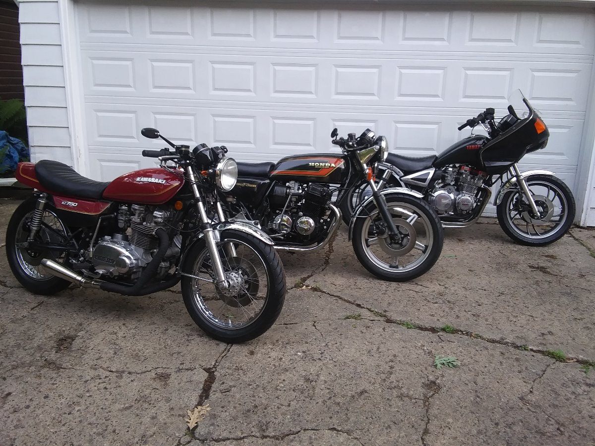

I will check the compression and do a balance test. I tweaked the idle screws last night (out on Right, in on Left) and the temp difference seemed smaller. It does not smoke at all so I am hoping the rings and walls are good. I broke it free with a 50/50 mix of Marvel Mystery Oil and used oil (used oil has some acid in it). I kept topping it off over 5 weeks and tugged (gently) on the crankshaft bolt once a week. Went to tug on the crankshaft on week 5 and it just started moving. This is the second motor (see the Yamaha I got for free attached) that I used this method on and it worked both times. Both had sat under a tarp in the backyard for more than 10 years so they did not look this good when I got them!! Thanks for the feedback.

Yeah, that seat foam is pretty ugly. Just got the seat finished up last night so I took a pic with its "brothers". The frame and seat pan have been shortened 4" but the seat still locks and flips up like the original.
