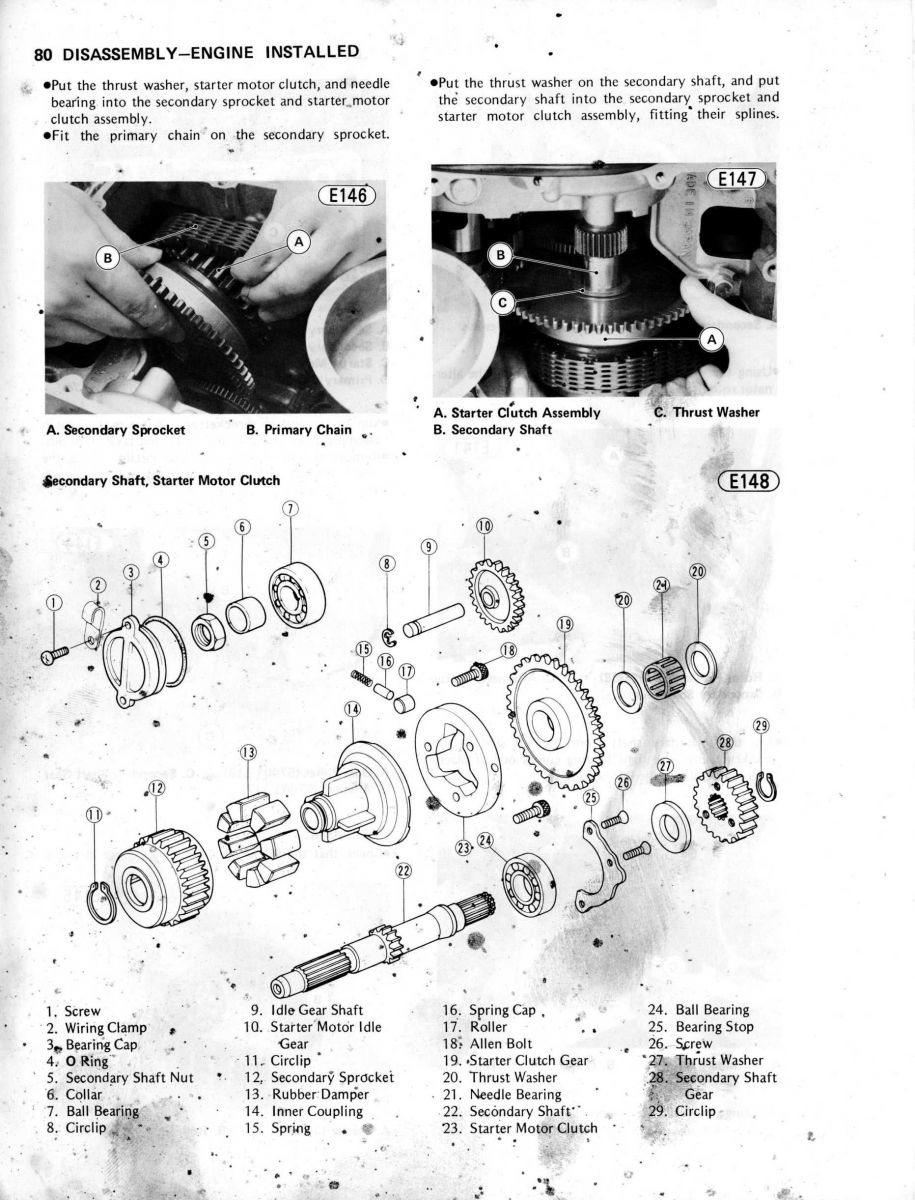

Hey guys! Still looking for some help!
Starter clutch was slipping.
Starter itself is fine. I replaced the large starer clutch gear, as well as the rollers and springs.
Starter is still slipping. My uncle is doing his damndest to find the issue, but we've no ideas as to what to work on/replace next.
He took apart the piece where the rollers were housed in, and i've uploaded it for your review. Is there something wrong with this piece?
I've tried to inquire for access to the archives, and I haven't had a return email as of yet
Thanks so much for your help!

Re: HELP! - 1981 KZ750(E1) Starter Clutch Issues
12 Jun 2018 11:55
- ryanlewis85
- Posts: 27
12 Jun 2018 14:07
Hey Scirocco!
That is indeed the gear we have replaced. Unfortunatley, I do NOT remember those grooves on it, as in the top most picture.
Is there a reasonable argument to assume that would be the culprit? How confident are you?
Thanks so much!
Thanks so much!
12 Jun 2018 14:34
How have you determined which parts are actually turning and which parts are not turning?
Do you have the oil pan off so you can see gear #10 and #19 turning?
12 Jun 2018 14:35
A metal to metal traction and/or form closure need a specific pressure/surface roughness to engage together. Low pressure = more roughness / High pressure = less roughness!
It is to get the right balance of both, plus the oil medium need a specific grip additive to support this.
Pics of the gear???
Pics of the gear???
12 Jun 2018 14:39
I passed that along to my uncle. I'm sure it will resonate with him.
Sounds like it might have to do with how "tight" we put it on there or something. We honestly barely understood how the mechanism even "grabbed" the other one....with only rollers!
I'll reach out to my uncle to see if we have those "notches" on the gear...I have a feeling we do not
12 Jun 2018 14:59 - 12 Jun 2018 15:01
I don“t know if your starter clutch gear is new or used but a little sanding can act like a miracle.
Pics be before sanding please....
12 Jun 2018 15:44
If the gear is new I don't understand what could be wrong with it.
I agree with pulling the oil pan and spark plugs, and then hitting the starter while watching what happens.
