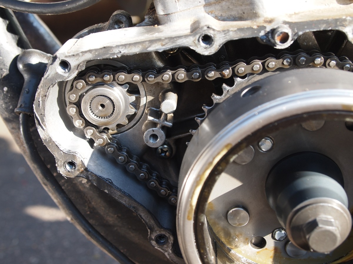

As you can read I have taken the spareparts away. I can find that the freewheel goes what I find wrong It has easy to move counterclockwise and hard clockwise
It should be reverse as now the starter moves as an elecrtric engine not driving the engine to start. So what is wrong has earlier owner change spareparts.
Shall it have the rotor a cut -out cocket "krysskil in swedish as the crankshaft has. Thabfull for helping answer I newly bought the bike and the electric starter does not work but the kick is okey.

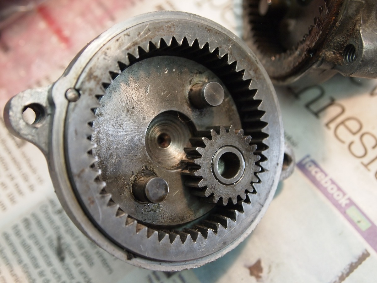

Tog den starten och det visade sig efter denna att 2 planetdrev som skall sitta mot drivande axeln dvs lilla startdrevet som i sin tur driver det stora kedjehjulet innanför rotorn.

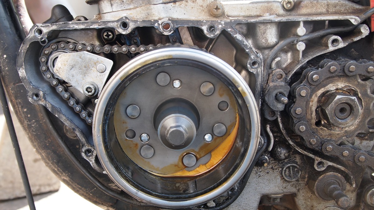

Monterade av motorkåpa stator rotor o startkoppling. Såg en liten smula av krysskil på vevaxeln Fanns inget motsvarande uttag på rotorn.

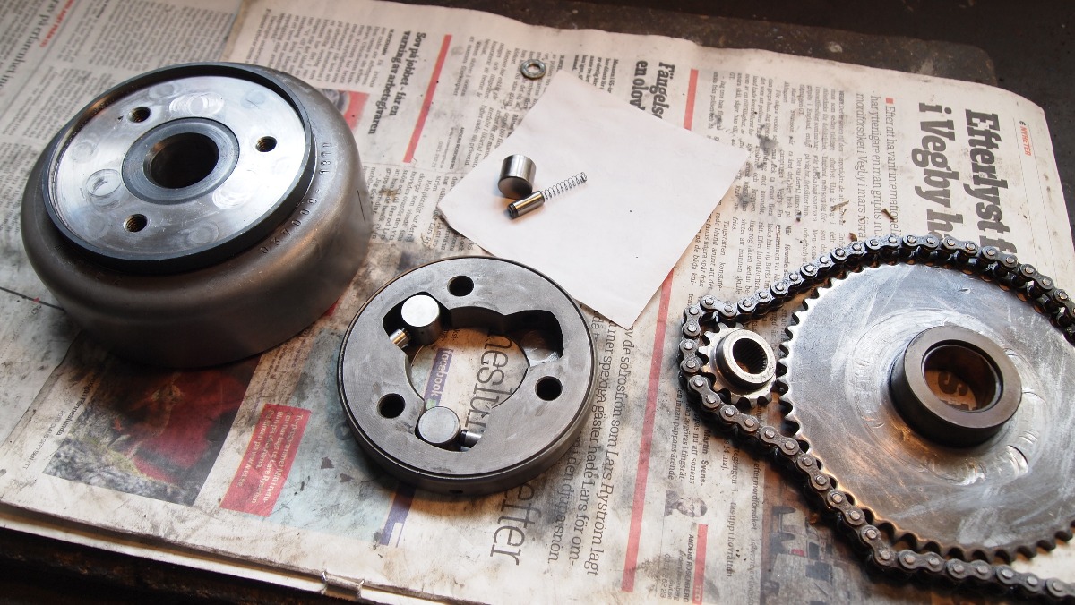

Frikransen sitter på rotorn med 3 insexskruv försänkta. Vevaxeln driver moturs och samma med startmotorn. Har provat startmotorn separat o den funkar riktigt.
Frikransen går hur lätt som helst moturs men är fast medurs. Tycker det borde vara tvärsom. Man kan ej sätta frikransen fel p.g.a de försänkta hålen för skruven.

Took the start and it turned out that 2 planetary drives to sit against the driving axle, ie the small start drive which in turn drives the large sprocket inside the rotor.

If it is chain driven then it would turn in reverse. As long as the motor doesn't drag then it is the clutch. Most have a roller and ramp style that depends on the spring tension to jam the roller against the flywheel race thus turning it.Weak springs or a roller with a flat spot could cause it to slip.

It sounds like he's describing the one-way clutch spinning in both directions, and the symptom is the starter motor freewheeling and not turning the crank. I think?

Weak springs.
