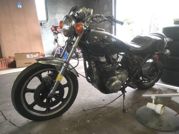

Craigslist in Buffalo, NY. WTF? Mixed Batch of what the ??? parts! Calls it a 72 Z1 with a transferable registration. ( New York bikes were not titled until 1973) Z1A frame #'s (28,074) re-stamped into a 76 KZ900 frame. Looks like a 76 KZ900 engine. (might be a good engine?) Ruined a swing arm. Ruined a front LTD fender. Only thing good is the front Lester mag.
Call this guys # and give him a WTF?

At least he isn't wanting a lot of $ for it. But even his firm asking price at $800.00 might be high with no carbs or exhaust.
