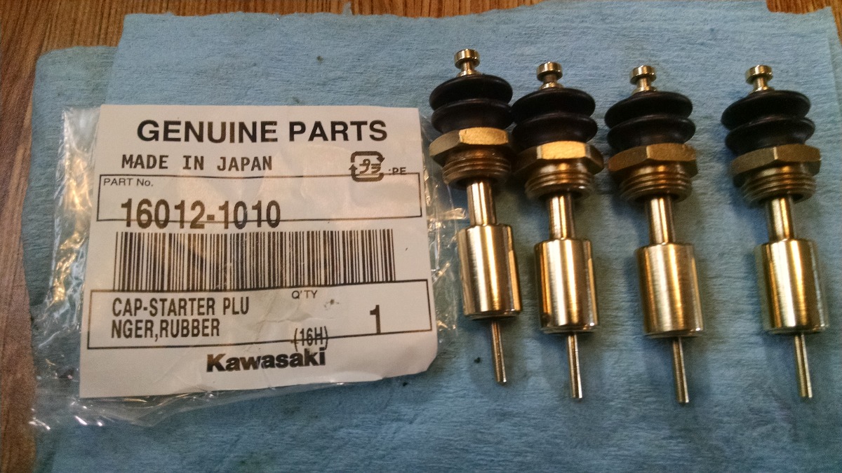

Probably one of the truest statements I think I have ever read on these motors. "Simple yet complicated". My carbs are the stock 81 BS-34's, I think?? My bike is almost completely stock, or as close as I can get. The pic was last January after a complete tear-down, soda blasting / cleaning, SS fasteners, and replacement of the fuel enrichment plunger caps. Expensive little devils, they are. (says yoda) IMO 60 bucks for 4 little rubber booties is kinda pricey.

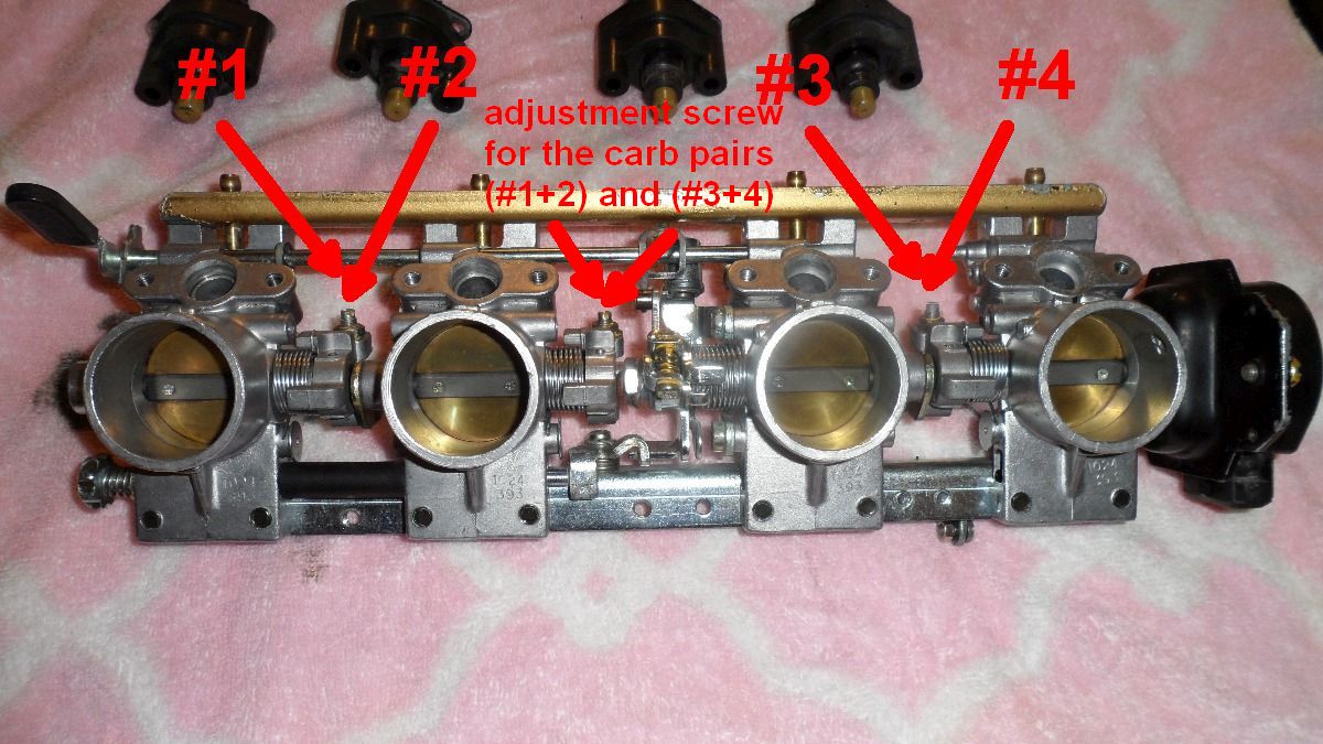

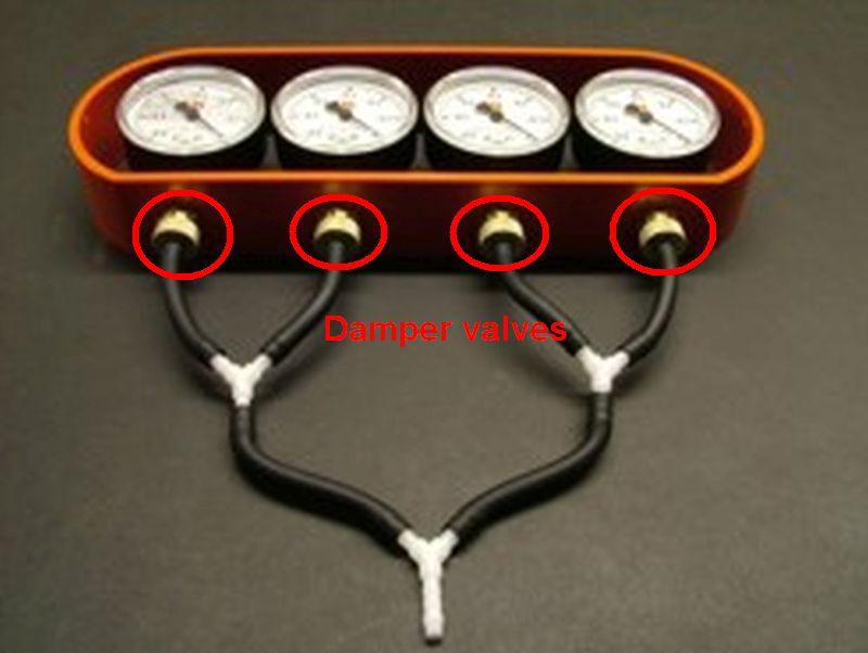

A quick guide to sync the carbs:
first sync #3 with #4, (#3 is the master, all other are the slaves)
then sync #1 with #2 ( independent with #3 and #4 values)
then sync the pairs (#1 + 2) with (#3 + 4)
do little 1/10 turns only, every little turn interact with the other carb vacuum.
Repeat the steps until you get the minimum difference on all carbs.
Close the damper valves to reduce pointer vibrating to a minimum but do not totally close them.
If a carb sync seems to be very difficult to adjust or the values on the vacuum gauge change every time you pull the throttle could be a sign of a vacuum leak at the intake boots, a leaking valve or bad compression by piston rings.
A misfire during a carb sync or a fully open damper valve,(shaking pointer), can easily destroy your vacuum gauge mechanic.
One special note before you do a carb sync is to do a sync test on your vacuum gauge to verify all clocks showing the same value on one vacuum port.

Thats some pretty solid info thanks. i have them set all across the board perfect but i didnt set them to the master i just made them all even. Should i redo it then?
Re: Can this be right????
24 May 2018 15:43 - 24 May 2018 15:49
If you have even vacuum readings with even compression/ignition timing everything should be okay. The self sync test of the vacuum clocks required.
