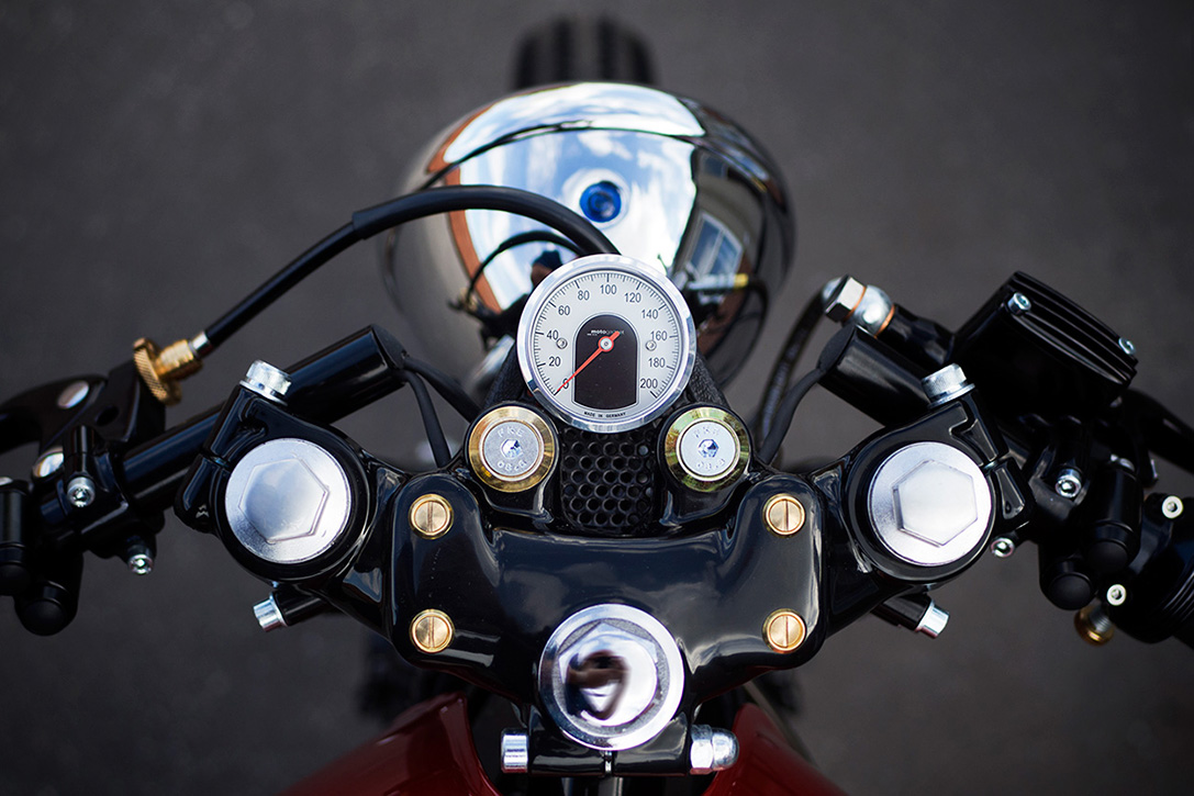

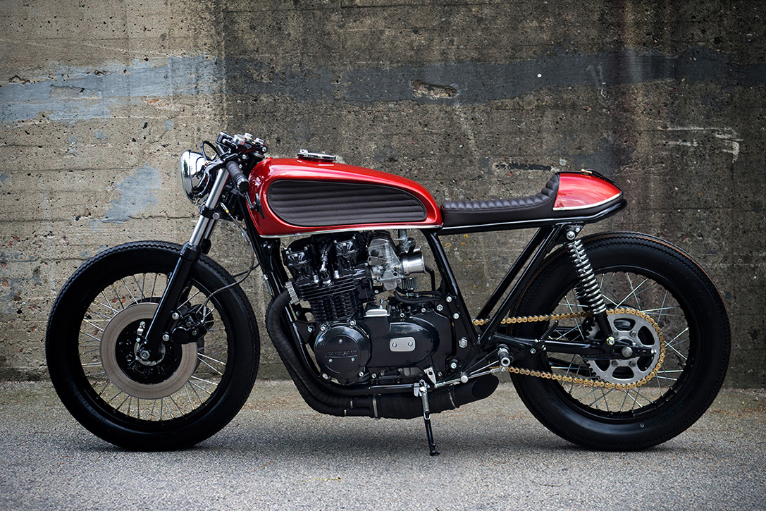

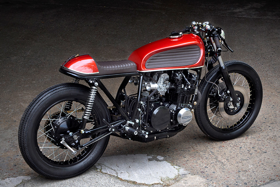

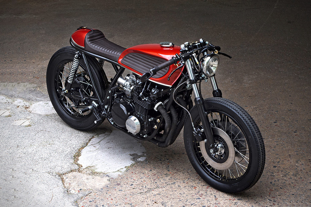

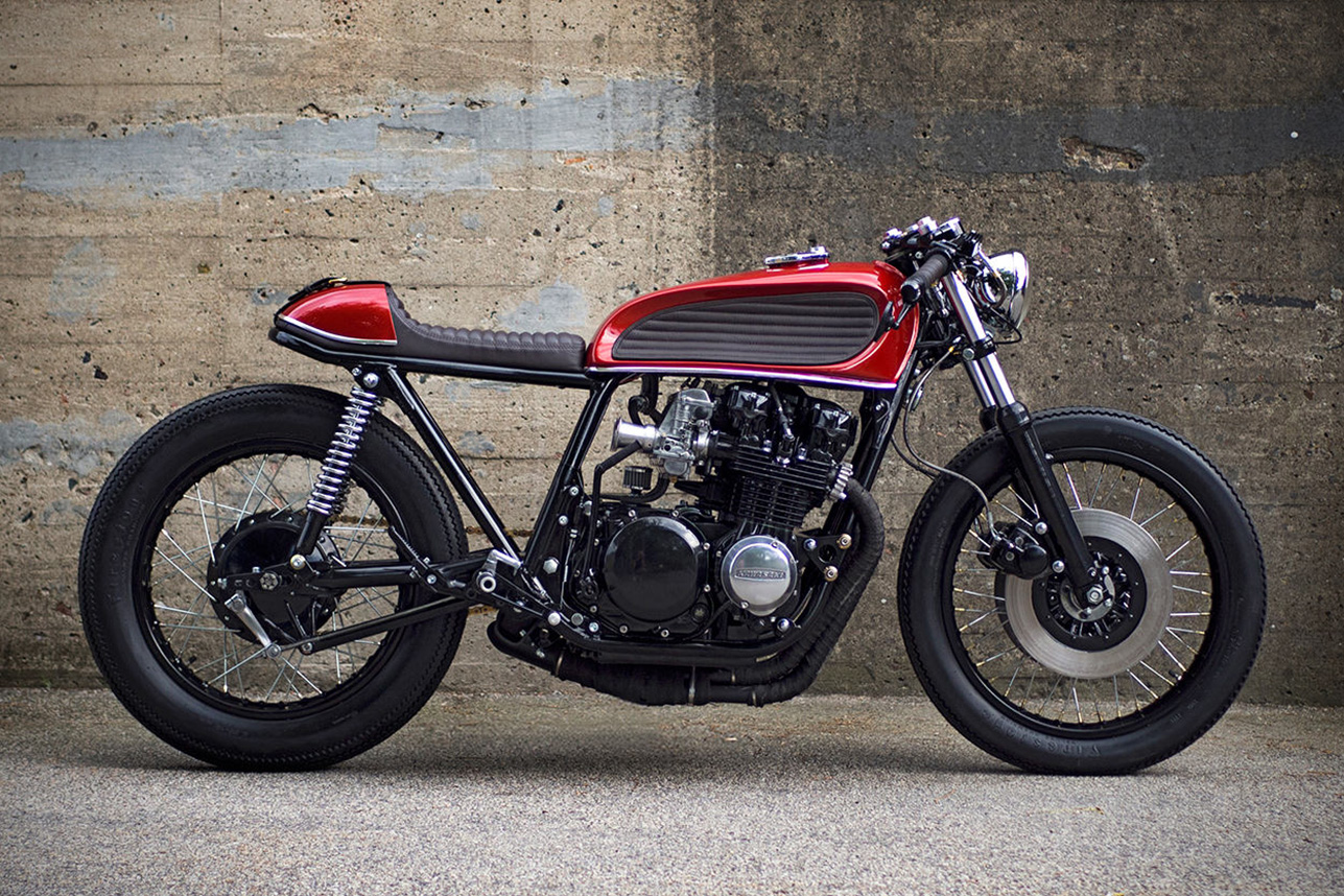

Google can give you a lot of inspiration like this:
hiconsumption.com/2018/03/1978-kawasaki-...by-paal-motorcycles/
Michael
any ideas on where to find parts?
The most parts on custom bikes have to be self fabricated or modified.
Some parts like handle bars, headlights, rear lights, grips, mirrors, etc...
can be bought from other models or manufacturer.
I think, first you have to know how should your bike look like later, this is your goal.
Some sketches,drawings, or take some pics of your bike and do a photoshop session.
Create you 650 mod with your personally taste and budged
