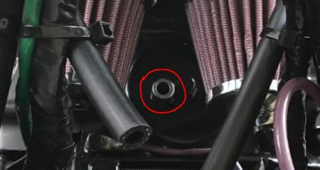

I have measure the port to be 15mm, do you think a fuel house with 13mm house should be able to enter the 15mm port ?
The Oil breather port on the engine, I have measure it to me 15mm, do you think a petrol hose

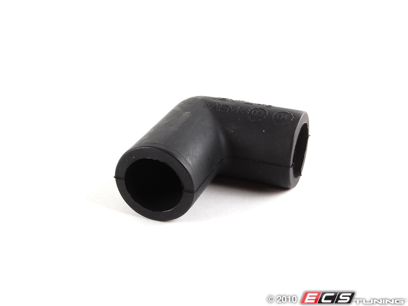

DoctoRot wrote: It should work. On mine I got a 90 degree PCV rubber fitting so i could angle the hose away easier.
Thank you, my plan is to use these hose and also use rubber house on the two vent port on the carbs ending up the 3 hoses around the battery so no water can come into the engine/carbs when cleaning the bike.
