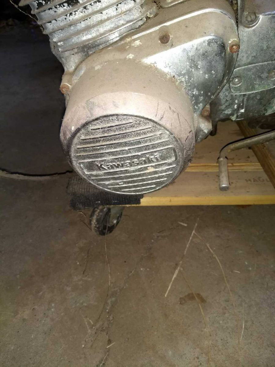

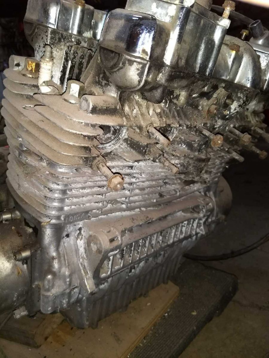

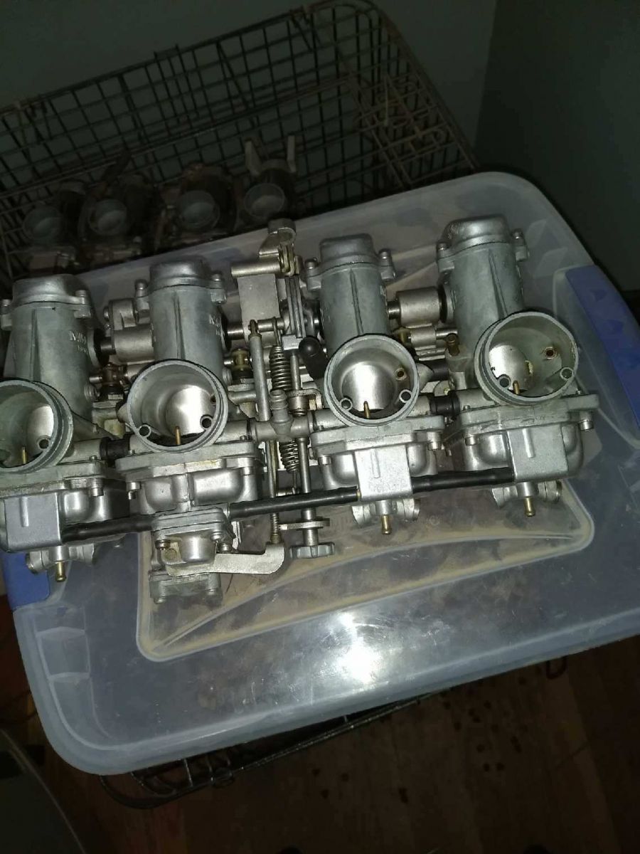

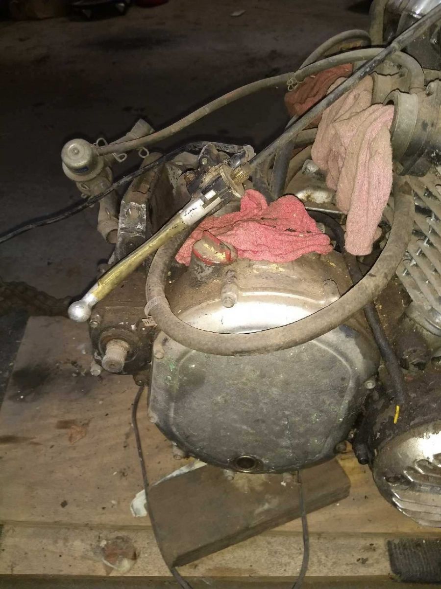

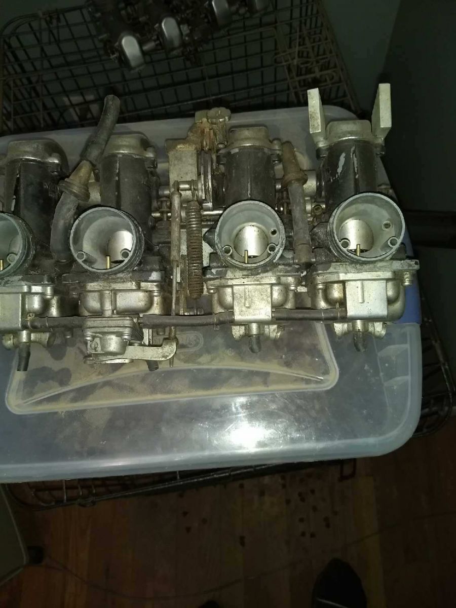

Looked at engine. Not Mark II. # 754611. Small pin crank. 30 teeth cam sprockets. 3 big chunks out of the smog head. The 2nd set of pumpers were the crap 26mm. The 28’s were not professionally done.
I said I did not even want to make offer, it would have been $100. It had points still. The only thing it had good, was that it turned over! Plus it was oil clean inside the cam cover. Oh well had to try. Spent an hour in a cold garage. It was only 33 degrees out!

Yes, it was small pin. I took off cam cover and counted the teeth! 30. This happened to me about 10 yrs. ago. Guy said MKII it was not. Got burned.
Here is Zedder #'s for 78LTD:
Year & Model '78 KZ1000-B2:LTD
Frame No. Range KZTOOB-507531 - 515536
Engine No. Range KZTOOAE057037 - 057066 &
KZTOOAE058797 - 075473. (This one was 074611)
Right before the transition to MKII's for 79-80
Here is craigslist ad! No Pictures! buffalo.craigslist.org/mpo/d/kz1000motor/6551344507.html
He says off of a drag bike! Don't think so LOL! Yea' drag, dragged out of junk yard!
Poor Guy has health issues, he was selling everything he has. Felt bad for him. These were his phone pictures. I did not want to take any pics in a strangers garage with my phone. But You get the gist! looking at this one.
