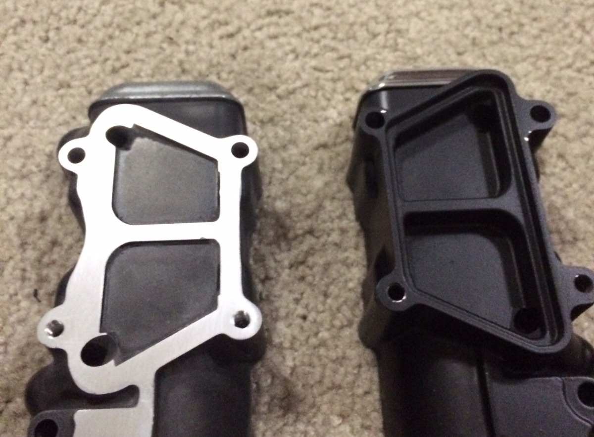

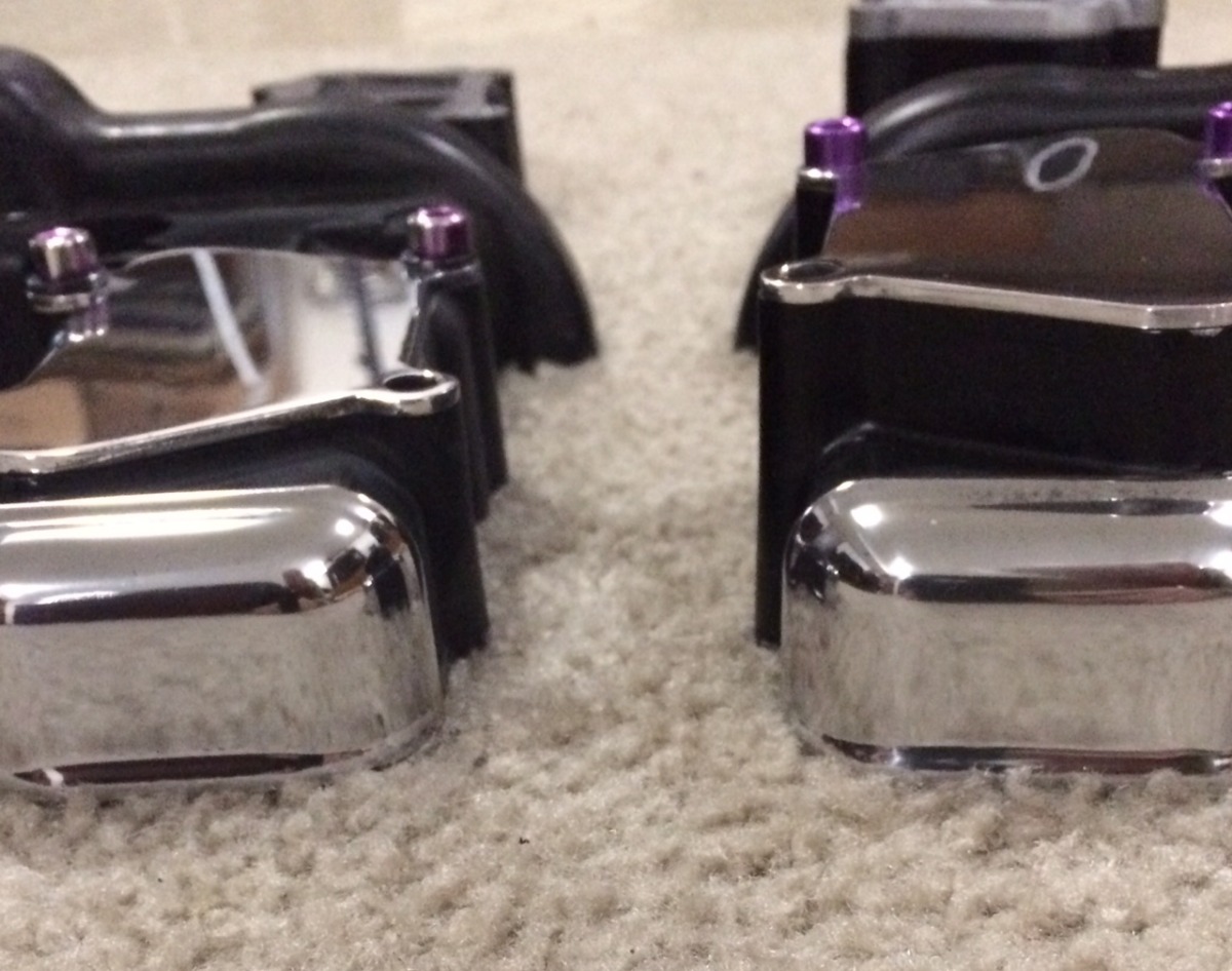

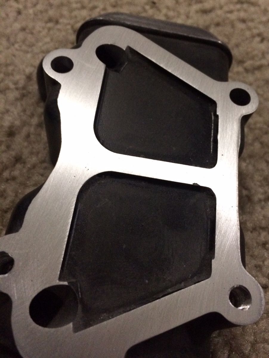

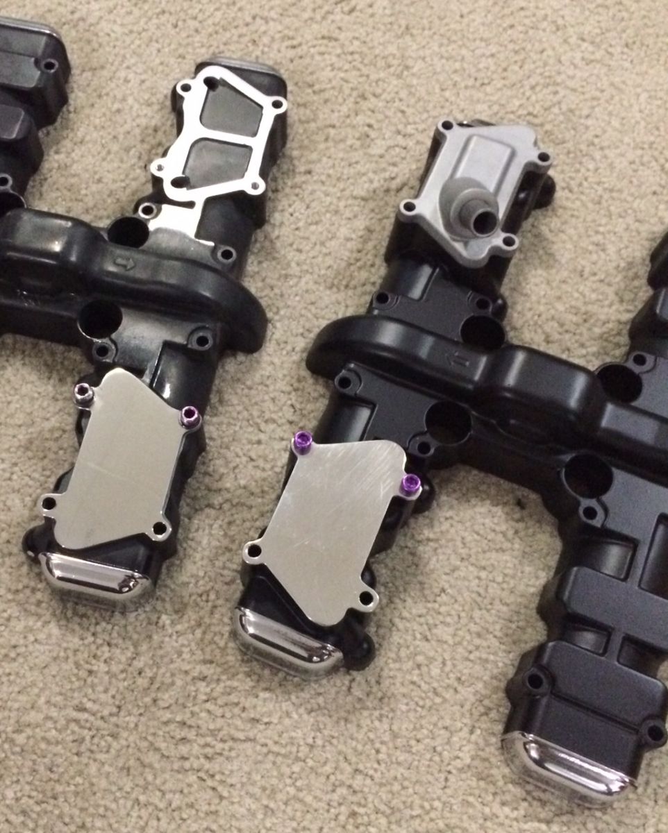

I know these heads and valve covers are ugly after the originals! They are selling a little cheaper on eBay than the old originals.

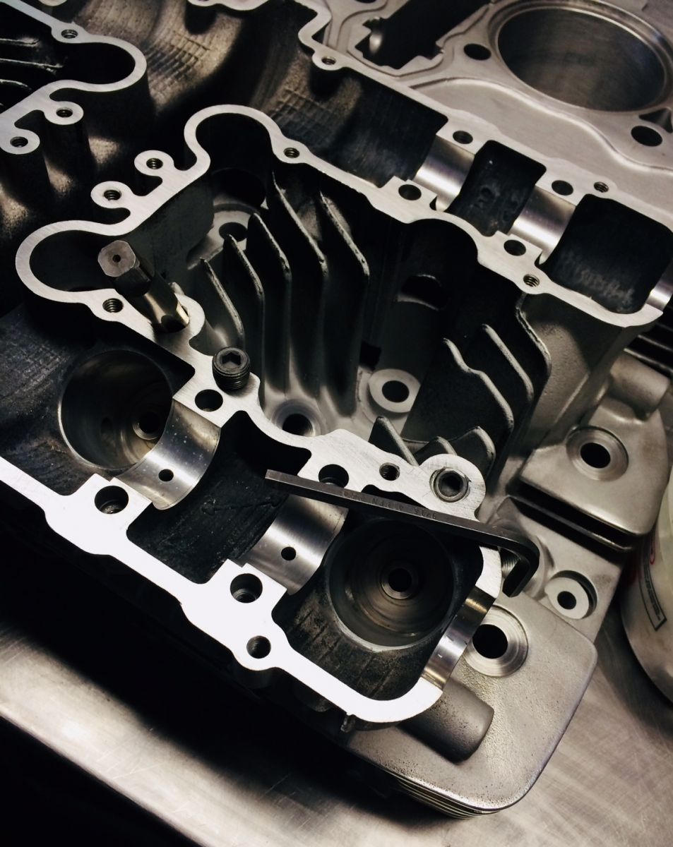

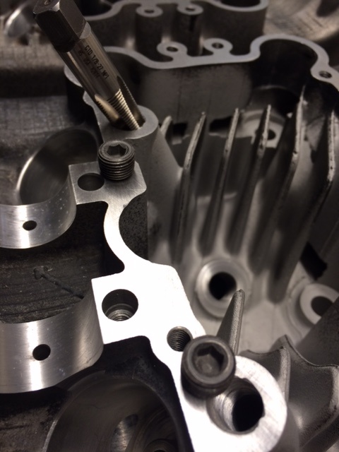

I have 2 complete heads that I am working on. These can be used on all 73-80 engines. I took a valve cover and milled down as low as I could go. Then put some flat 1/8" aluminum cover plates on. Had to tap down a 1/4", the 2 holes that were milled down. And I tap the air holes with 1/8" NPT standard pipe tap and use small screw in plugs to close the hole in the head. You just have to use a correct cam chain tower that works with the valve cover. So Guys looking for a head for the early 73-77. Can use a smog head. I did this when I seen a RARE - Canadian or European valve cover sell for $134 on eBay. Without that ugly lug on top of the cover.
Just something I did Friday playing with the old Bridgeport Mill.

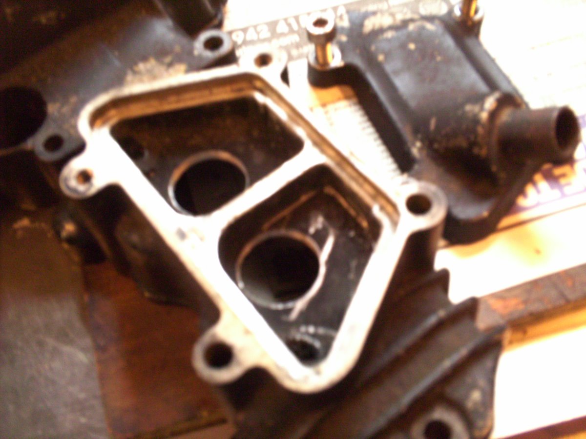

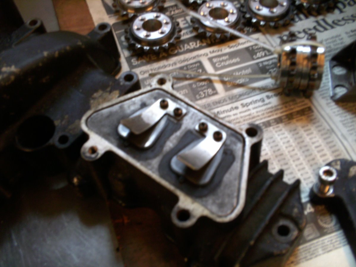

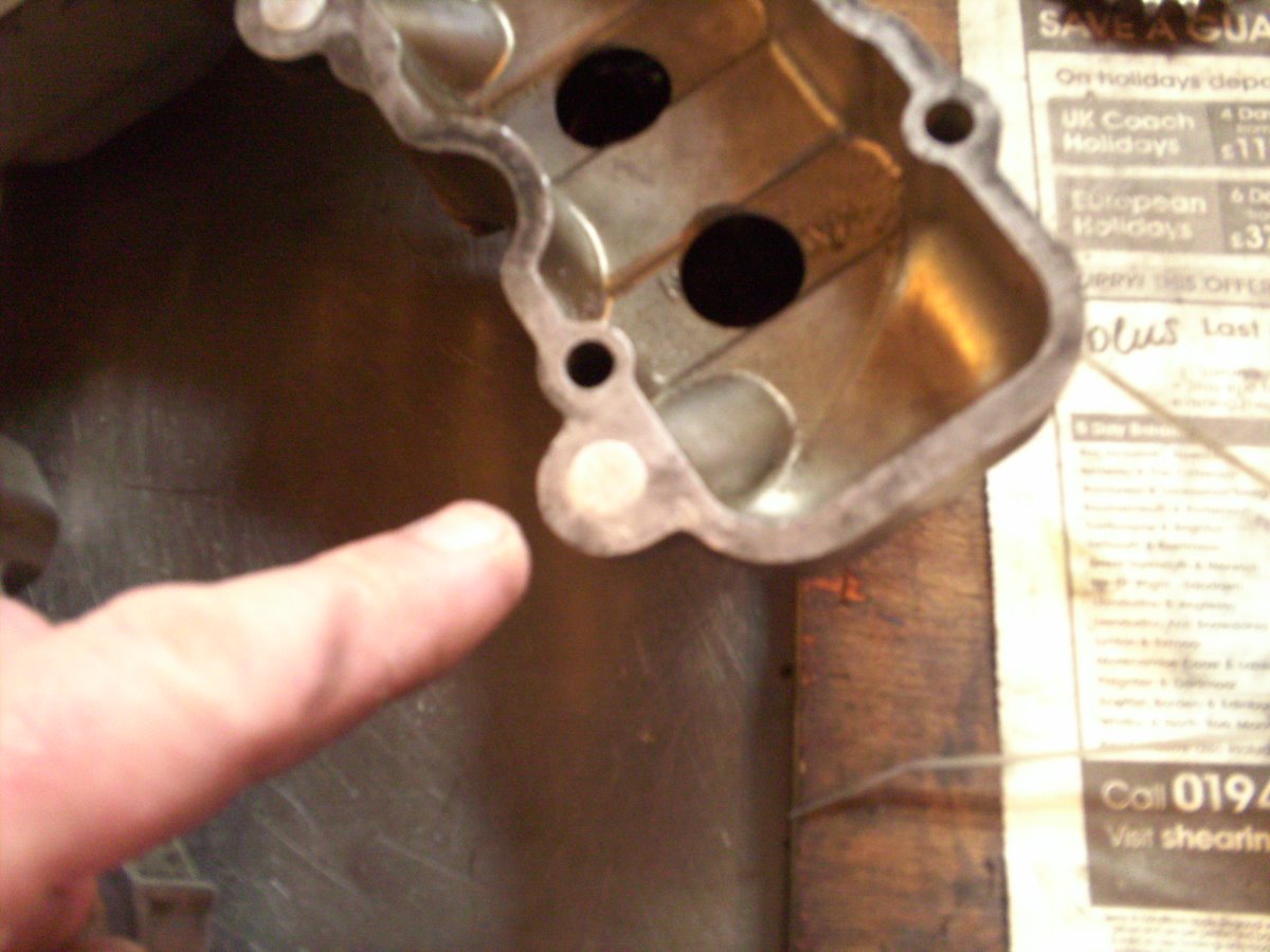

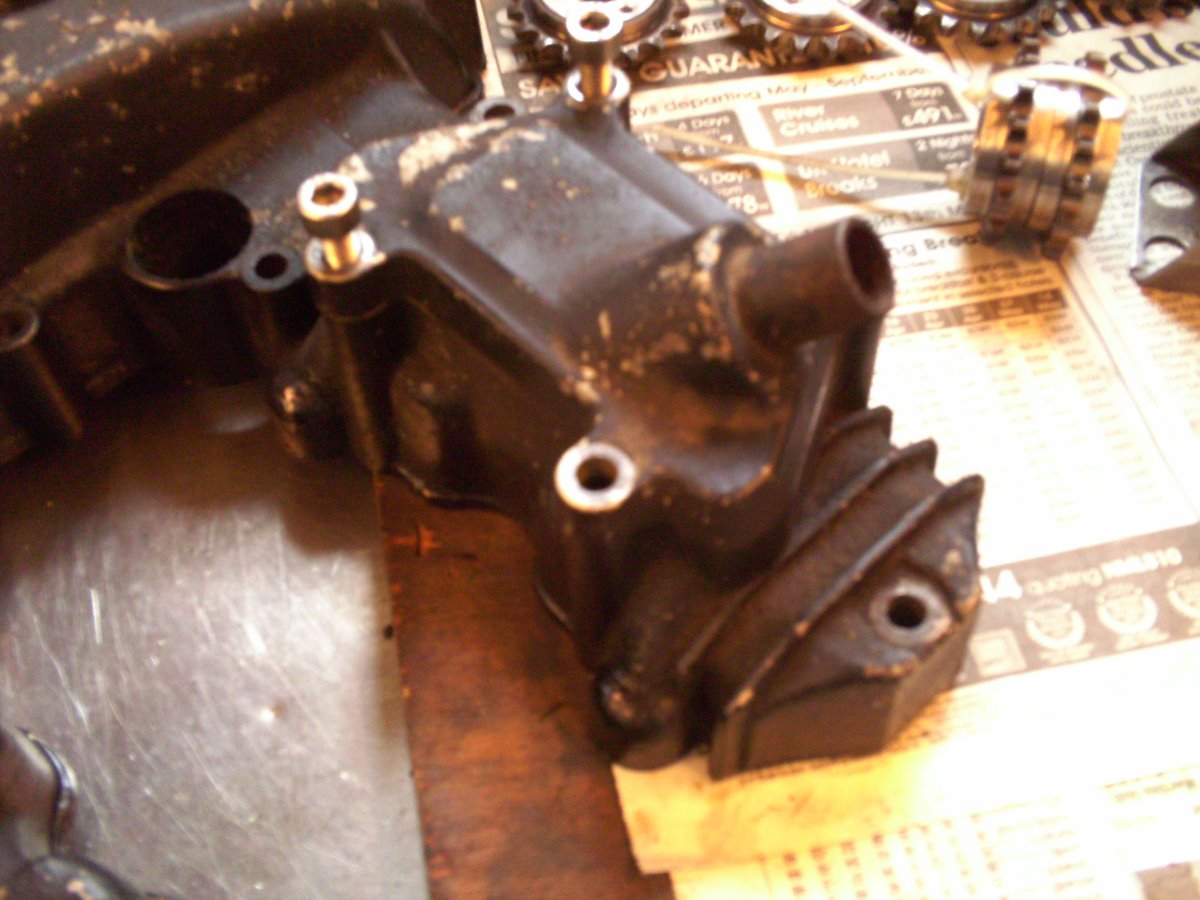

This is what I do with mine to make them even more useful.
Plug the head and camcover so the the chambers are now sealed.
Bore a couple of holes in the floor of the chambers above the cam caps to avoid oil splash.
Re-fit the reed valves upside down.
You can then re-fit the stock caps and voila! you now have a one way top end engine breather.
It almost as if Kawasaki wanted you to do this.
You can also do away with the reed valves and fit some gauze to trap any oil mist and then fit some billet style caps with earls type hose fitting for a tricker look.
