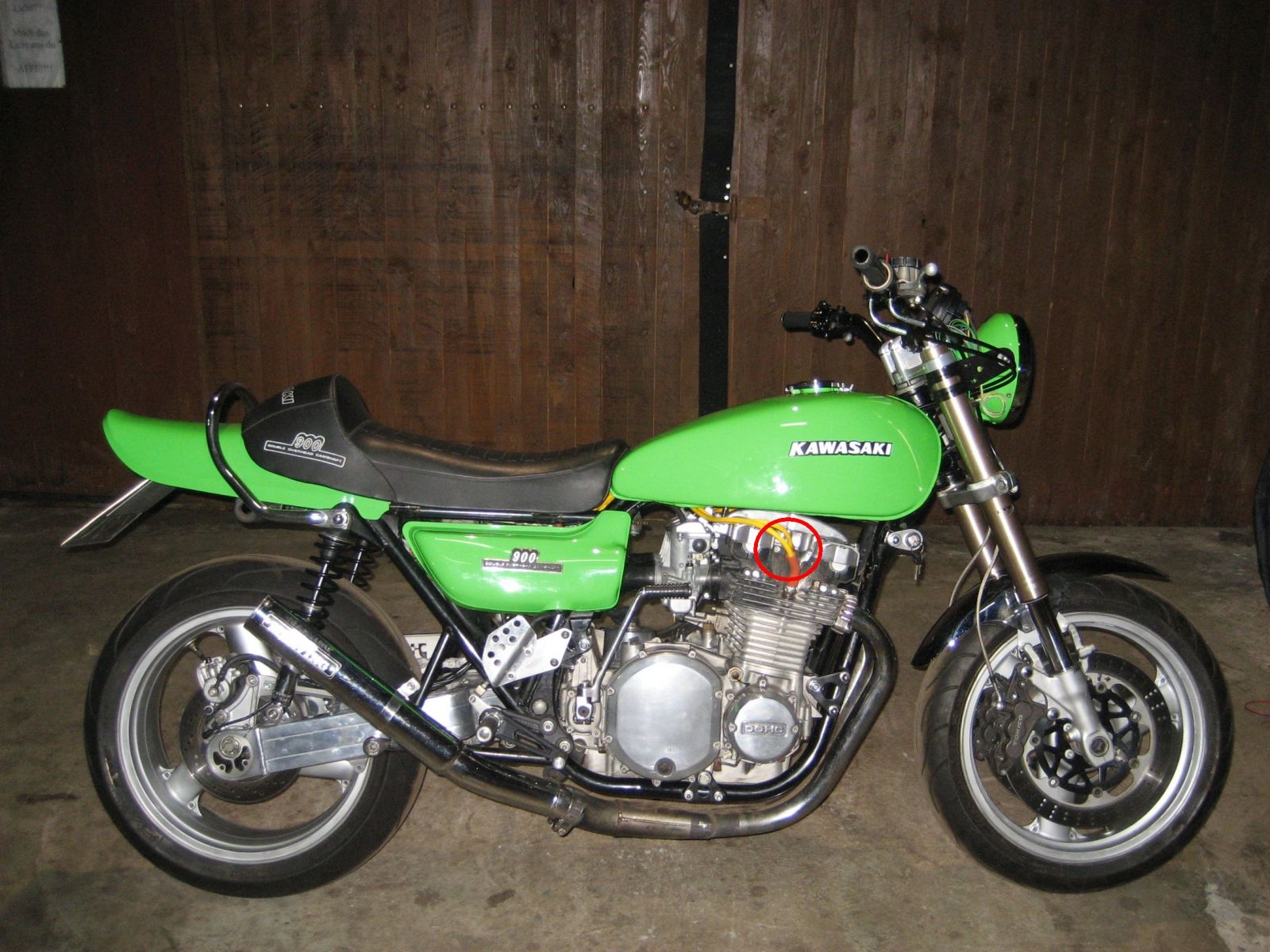

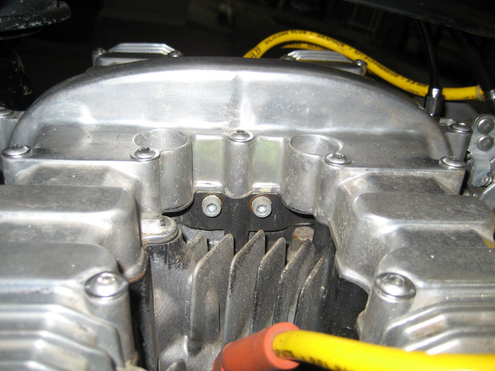

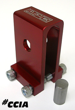

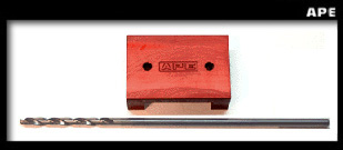

For a "J" Head you need a cam chain tower mod (APE)
The "J" Head on my bike.
The APE parts you need or made your self like me :whistle: :whistle: :whistle:
kzzone.com/sprockets.html
