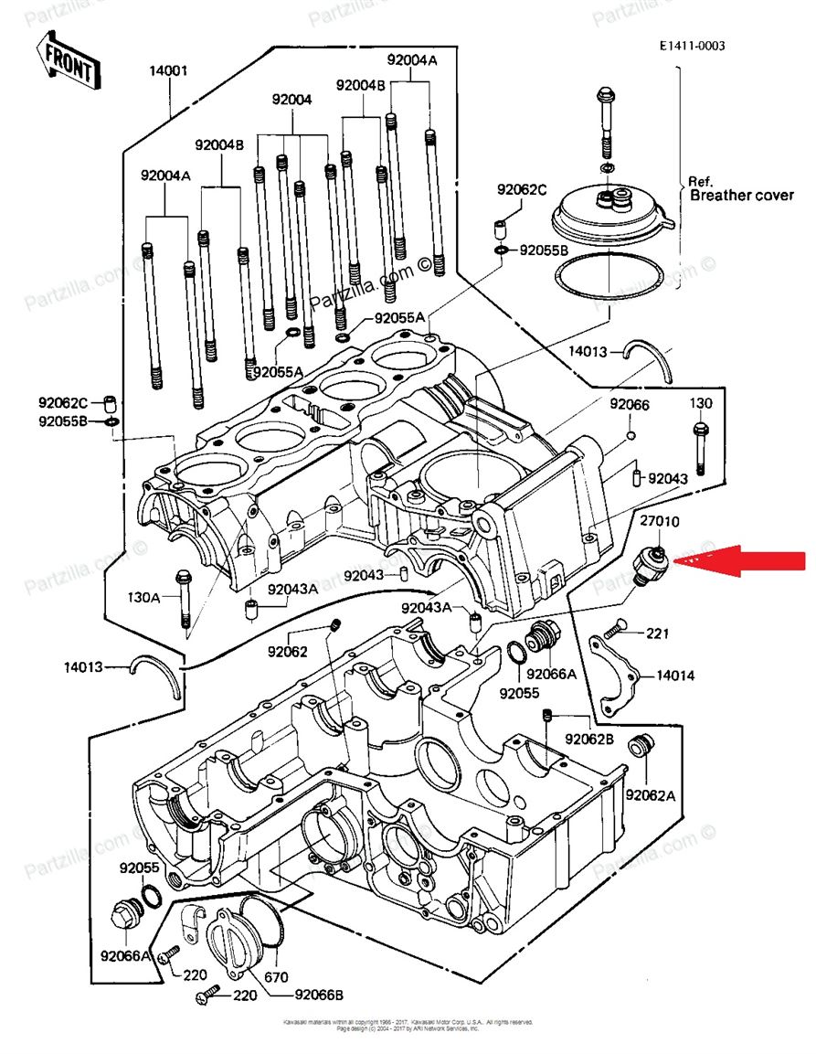

Kawasaki call it a switch assembly .
The wire is part of the loom not the sender and is attached with a small bolt, you may want to fix the wire first
part number is 16144-006

No. 27010 in the below schematic
