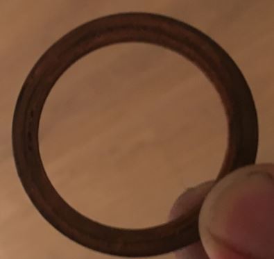

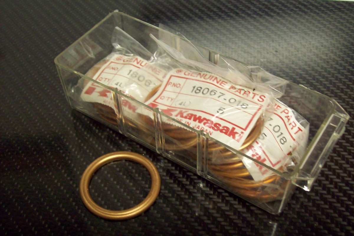

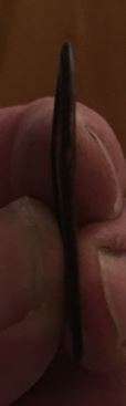

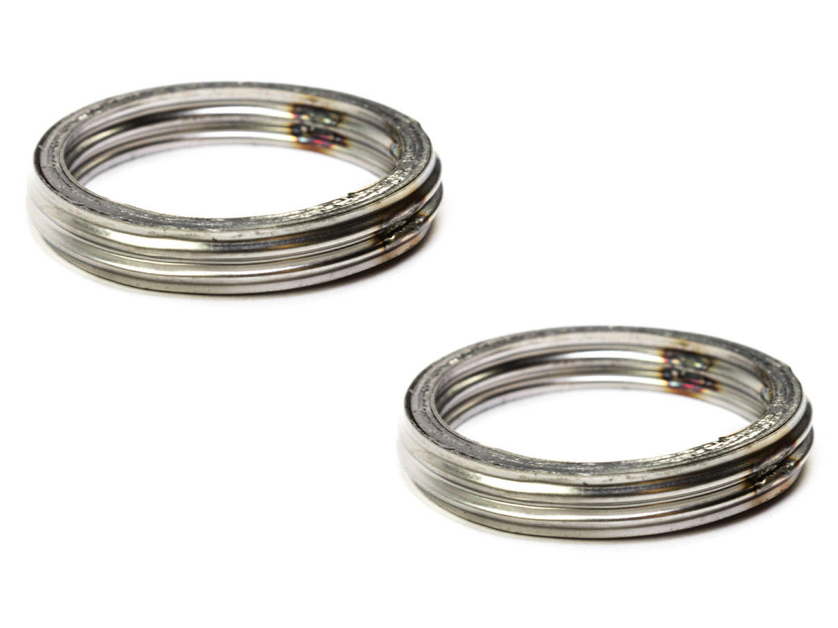

Hi,
When I removed the mufflers it was two gasket for each outlet. One thin, see attached photo and then a thick.
These:
And these:
Is there any point having two ? I was thinking only have the one of each (last picture) ?
The thick was used so It was thinner then the picture, but I don`t have picture of it....
Is there any reasons to use two gaskets ?
These:
And these:

The exhaust gaskets squished flat by the first use, (one time use only). Some exhaust ports had a lot of carbon on the sealing surface and are uneven. To be sealing the blow by hot gases it is a common "mod" to get the gap closed on the exhaust port and exhaust header with a second used or new gasket.

On my 750 with OEM exhaust I spent a LOT of time trying to get the exhaust to seal with only one gasket but failed on a couple of ports. I kept telling myself that I must be doing something wrong but the same thing kept happening. I finally installed a second gasket and the pipes sealed up beautifully. The OEM Kawasaki gaskets are thin and it doesn't take much misalignment to result in a leak. As mentioned, Suzuki gaskets are much thicker, almost twice as thick. That should tell you something right there.

So, if one were to want to use the much thicker Suzuki gasket...anyone have that part number??
