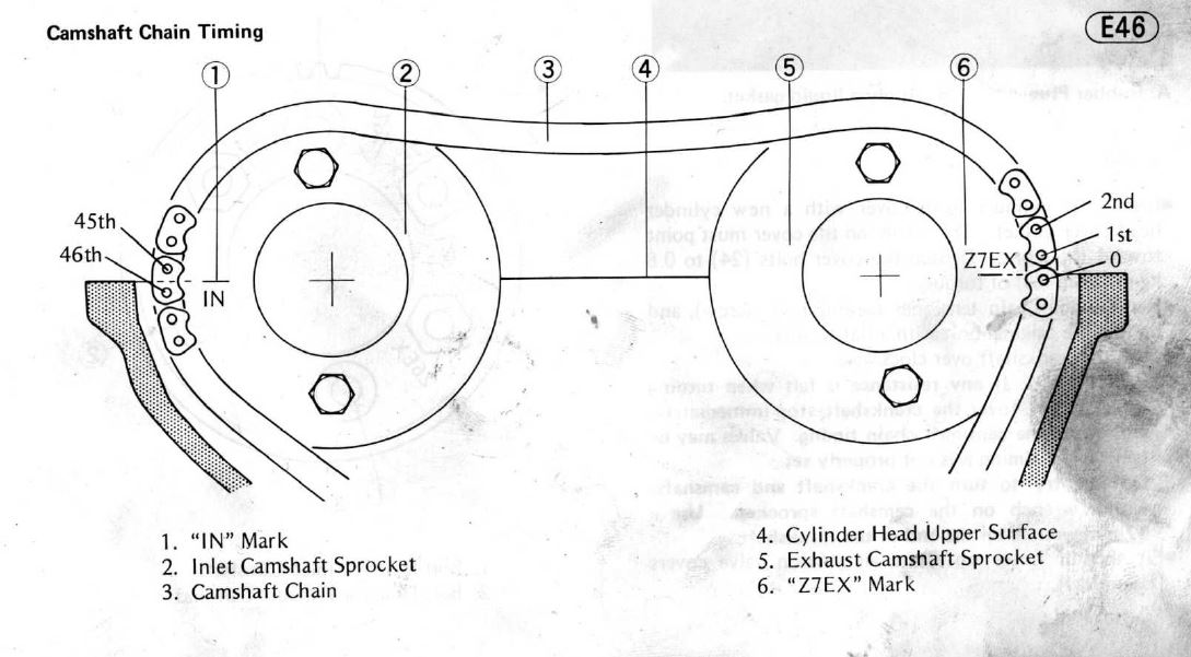

So over winter I decided to tackle adjusting my valve clearances. Come spring time I couldn't find the correct camshaft timing marks online and contacted kawisaki of USA and made a post. I got a few very helpful replies on the forum and from kawisaki. Even still the bike won't run. It seems like the cam timing is out cause the bike started once and ran on what sounded like 2 but was very rough. It had to be started with tons of ether. I have spark on all 4. I tried bump starting but it resulted in some coughing. I don't know where to go cause, according to the pictures kawisaki sent me I should be good. I set it to top dead center, put intake cam marking line level with the head, same with the z7ex mark on the exhuast cam.

The cam setting process is the same for all the 750's and 700's. Did you download the manual linked in your last thread?
1) put the engine on 1-4 TDC. That means align the 1-4 T mark with the indicator on the crank.
2) pull up on the cam chain and drape it over the exhaust cam. The hash mark should point down a little at this point because when the cam is tightened down the mark will come up.
3) count the chain links and install the intake came as appropriate
4) after cams are tightened back down in the cam caps double check everything carefully.
Before installing he cams it's important to remove the cam chain tensioner cross wedge and spring. After you put the intake cam in place and get all the cam caps installed and snugged down put the wedge and spring back in. Then rotate the engine over a couple of times to make sure you have free spinning. Lastly, align 1-4 T again and double check your cam timing. If everything is right then remove the wedge and spring again, install the valve cover, and lastly, install the wedge and spring one last time.

That's what I did, I'm going to pull my cover and check my work but that's exactly what Kawasaki and the manuals from last thread said. I'll probably clean carbs too just so I know my fueling is tip top.

Sorry for the delay, I had to handle midterms first but yesterday I got down and dirty on my beauty. So the cam timing is fine, the T mark is lined up and both the cams are lined up with the 45-46 pins between them. Just for shits and giggles I pulled a spark plug and used a straw to see if I was truly at TDC but its not. There is another mark about 40 degrees before the T mark and that is true top dead. I don't know if it has something to do with the ZN700 not having a mechanical advance like all the other bikes related do.
