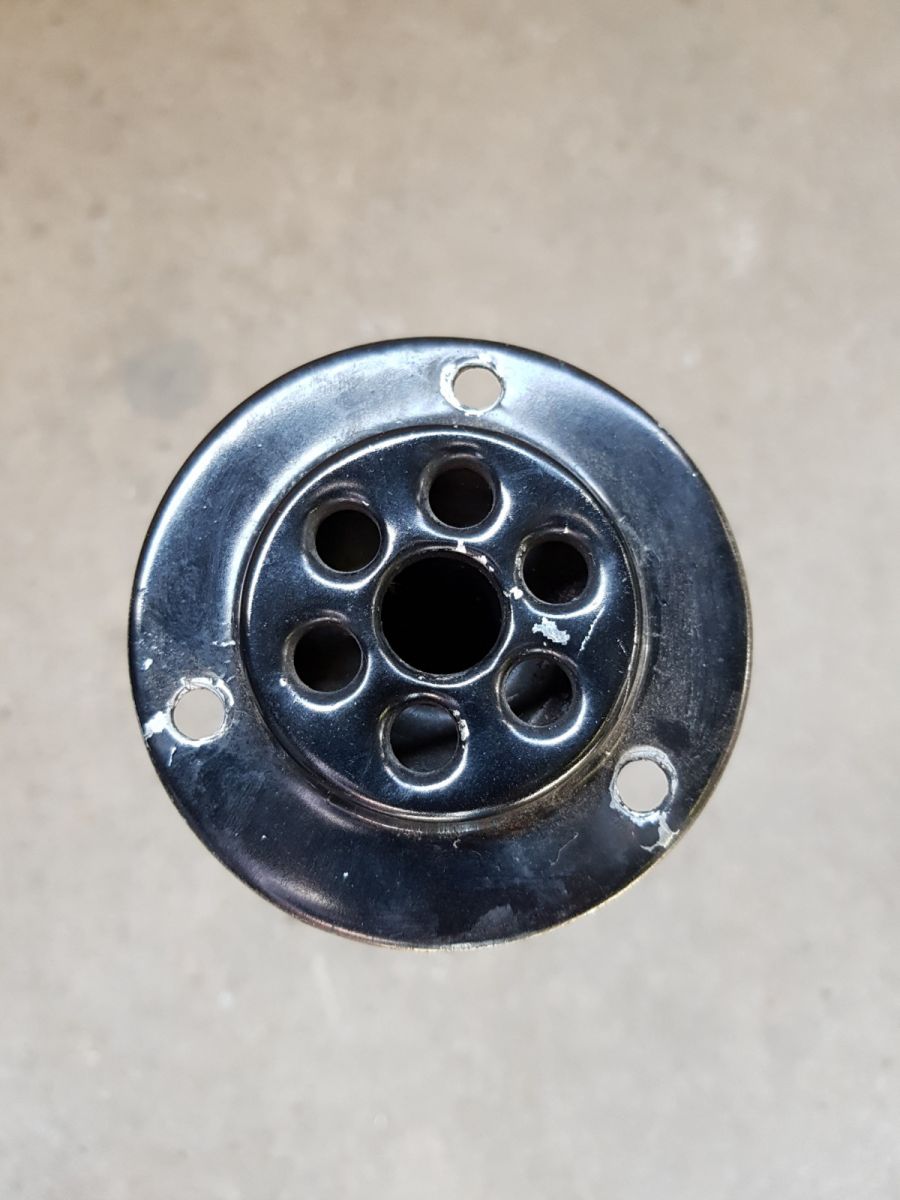

I found a stock exhaust system for my 81 KZ440 to replace my beat-up set. I pulled the baffles and found the packing is almost gone in both mufflers. Any tips on repacking the exhaust? Any products you would recommend? The only thing I know is that I need to use 4 stroke exhaust packing material.

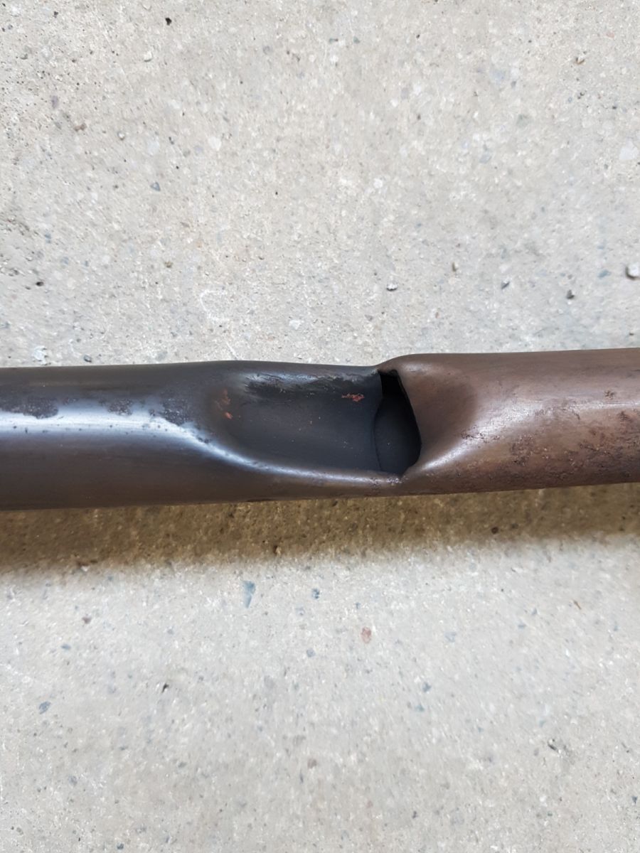

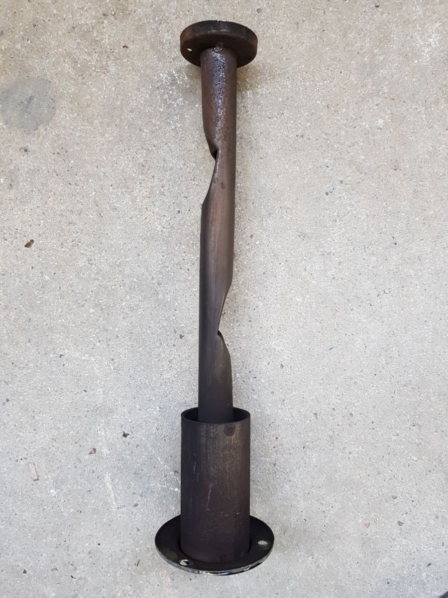

My concern is, does this type of baffle actually use any packing at all or does it run using the cuts in the baffle to retard the exhaust?

The Jardines had a series of blocked tubes, no packing.
