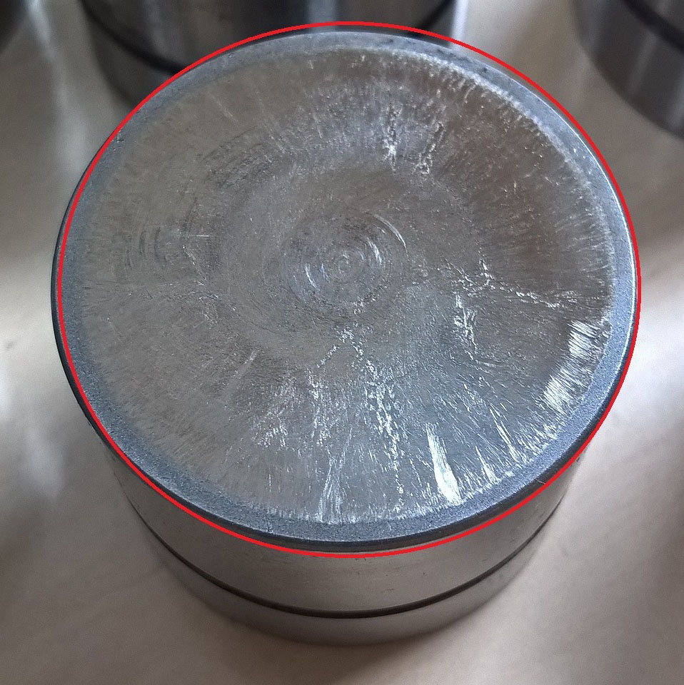

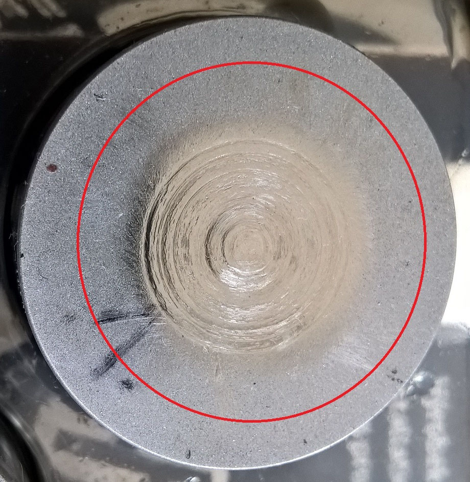

Have you check your bucket surface are even over the diameter and have no wear in the middle???
gordone wrote
The valve clearance is not the same under the cam for the whole surface. Typical more clearness in the uppersite side. Surface as on top of the bucket and surface of the cam.
Last edit: 27 Feb 2018 14:12 by Scirocco.

Re: Measure Valve Clearance
27 Feb 2018 22:23Scirocco wrote: Trust me, the valve clearance will get 2-3/100 mm tighter after 500 km.
gordone wroteThe valve clearance is not the same under the cam for the whole surface. Typical more clearness in the uppersite side. Surface as on top of the bucket and surface of the cam.
No, but I haven`t so large markers as you have on your picture, but that is possible worse case ?
If I turn the bucket. the point change...
Normally the point is on the end of the cam and not on center if you are looking at the cab surface.
I will see if I can find new buckets for a ok price.
