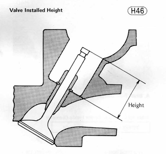

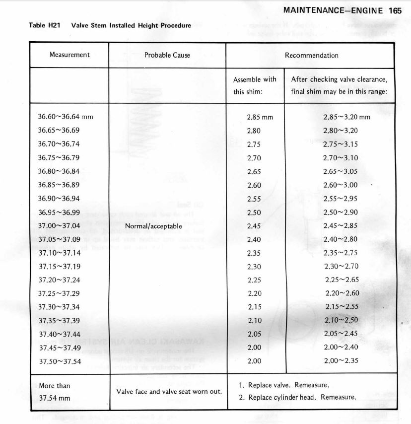

Bummer. Sounds like someone either neglected maintenance and damage occured or a valve job was done and the machine shop didn't tip the valves to put the installed height to the proper window. Table H21 in the factory Kawasaki service manual details the proper valve height. It's customary to tip the valve stem to control height after cutting the seats and/or wear in the engine.

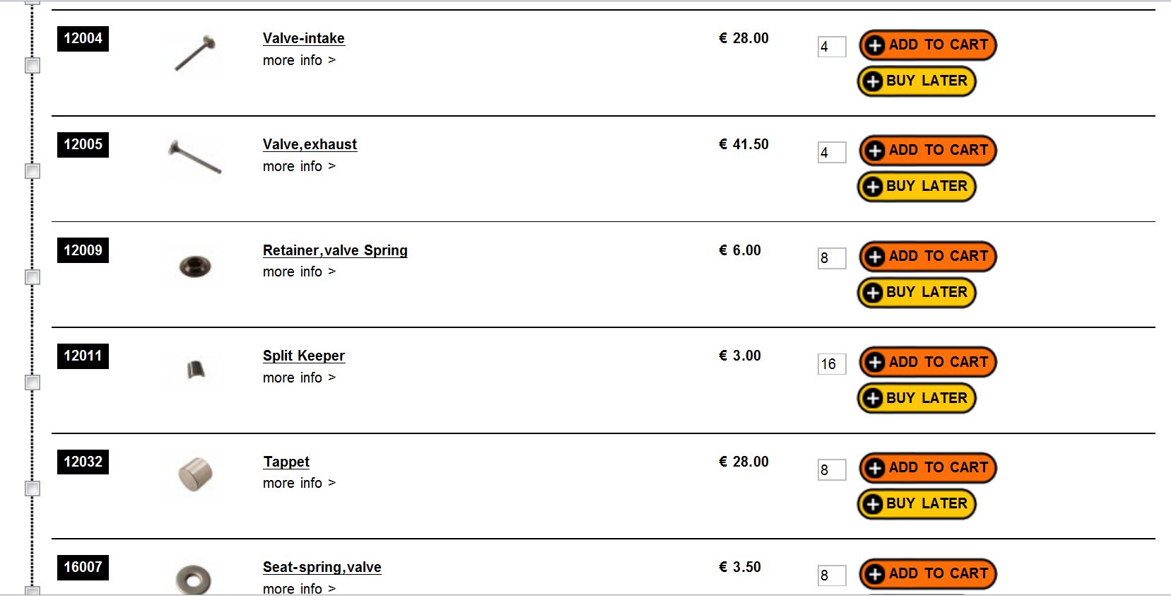

Valves are available@
www.cmsnl.com/kawasaki-kz750r1-gpz-1982-...st/8650.html#results
but new valve will not cure the bad valve job done to the valve seat rings, (seats rings are cut to deep and need to be renewed).
better buy a cheap used cylinder head from evil-bay.

Advise against grinding valve stem tips as these are hard finished in stellite.

HUH? LOL "tipping" is commonly done. If that won't work larger valves are called for.

The kawasaki service manuals specifically advise against it, as the valve end is hardened.
I would guess that unless the ground surface is heat treated again, there would be rapid mushrooming of the valve tip.

As Steve states, it's common procedure to grind the valve end to gain clearance. There is a warning in the service manual for my 750 about this but the reason being there could be issues, if the valve is cut too much, where the valve keepers would stick up above the end of the valve and that will cause problems. There is no reference to a hard coating on the valve in the manual. Further, Jay, owner of APE Racing, has posted here on this subject before and they tip the valves regularly. They even go so far as to cut down the valve keepers so they don't stick up above the valve in more extreme cases. Apparently they service a good many KZ Police bike heads and this is what they do to keep them on the road.
