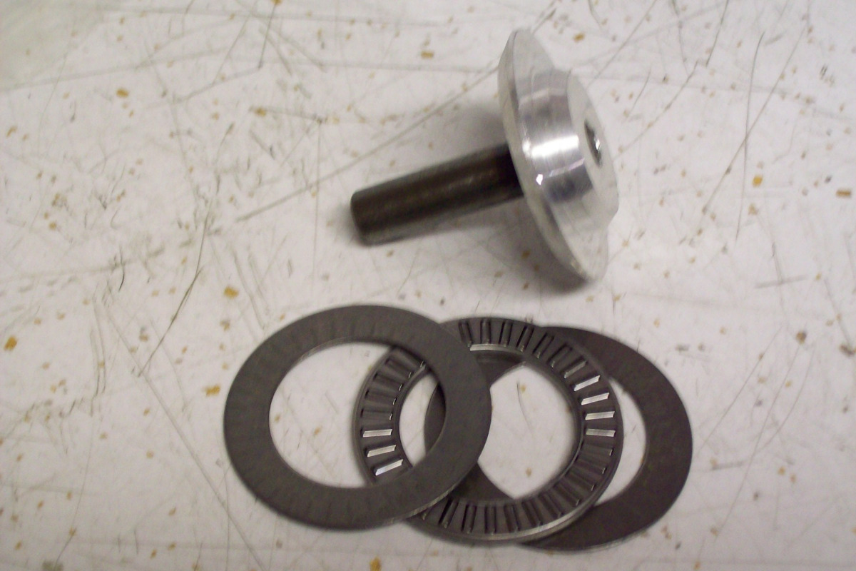

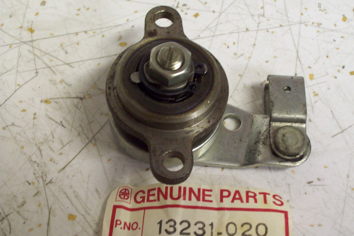

The needle bearing clutch pusher is a must in the Z1/KZ1000 clutch. The only other weak link in the clutch set up is the early model clutch release assembly. That white plastic release that came in the '73 to '78 models is a joke. Replace it with the ball bearing clutch release assembly from the '79 to '81 model bikes (part # 13231-020) With those two parts and a well lubed and properly routed O.E.M. clutch cable that clutch is damn near bulletproof!!!!!! You would not believe all the clutch cables I have seen on KZ's that are resting right on the exhaust header in my days. Most aftermarket clutch cables are pure junk. Pay the big bucks and buy the REAL Kawasaki clutch cable.

This is the best clutch release Kawasaki ever made for the KZ's end of question!!!
This is the clutch pusher you want to get.

My bike does have the release mechanism you pictured. Have worked on bikes with plastic worm drive releases and they always seem to be an 'Achilles heel' . I was a bit put off by all the little balls when I first saw it, so just washed the thing well in my tank and lubed up real good. Should I even attempt to disassemble an d clean?

Yea, you don't want to take the late model clutch release apart if you don't have to. There will be little steel balls bouncing all over your work bench!!!! I do the same wash it in the Safety-Kleen and just force some grease down into it.
