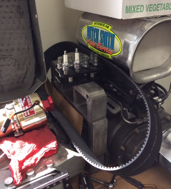

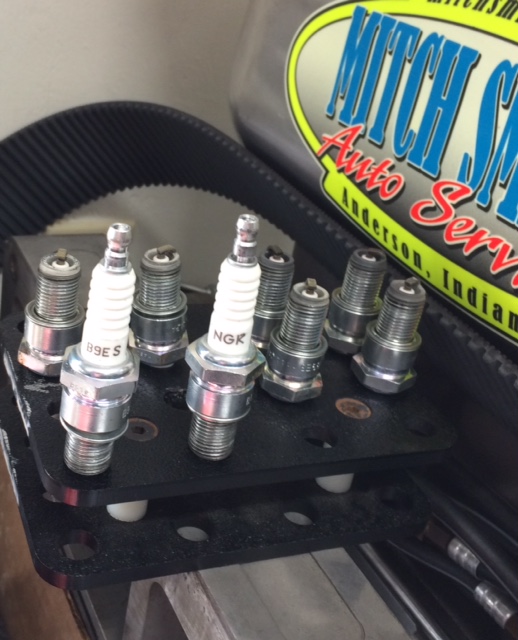

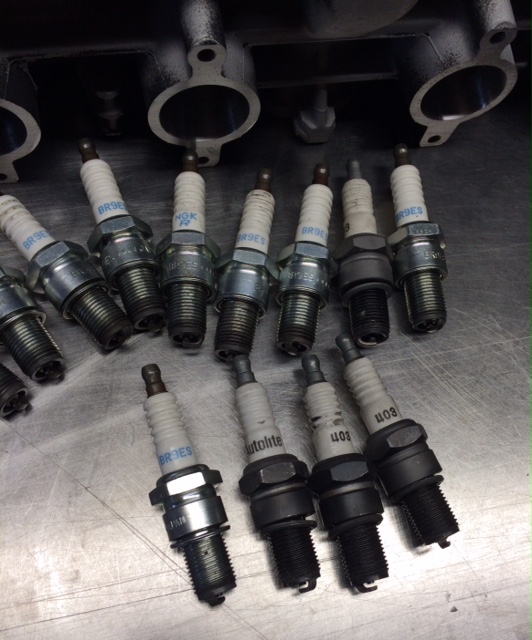

Was looking at the spark plug thread. Realized we run NGK '9' in the old Hemi Blown Gasser. Burning Methanol, 1500 HP engine.
I started saving the NGK plugs. Run them about 15-20 1/8 mile passes.

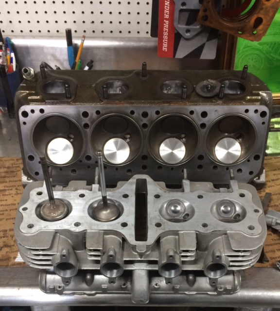

Not much difference, 2 Hemi heads! KZ1000 & 1955 Chrysler Hemi 354 Little bit bigger on the valves
Plus I used Autolite 403 plugs. Awhile back "Rock Auto dot com" had closeout sale on the Autolites 403's for 97 cents a piece.
