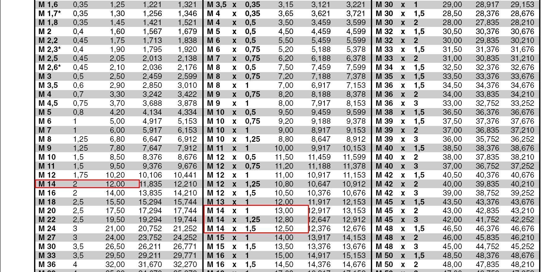

So, if I need an over-sized oil drain plug that would be an M14-1.50, ...correct?? If so, then what size drill bit do I need for M14-1.50??

Re: Oil pan drain plug/bolt stripped
05 Mar 2018 10:14
Metric ISO thread 14 x 2,0 you have to drill 12,0 mm
Metric fine thread 14 x 1,5 you have to drill 12,5 mm
I add a drill chart for all kind of Drill-Ø for Threads and Minor-Ø of Nut Threads
Michael
Michael
