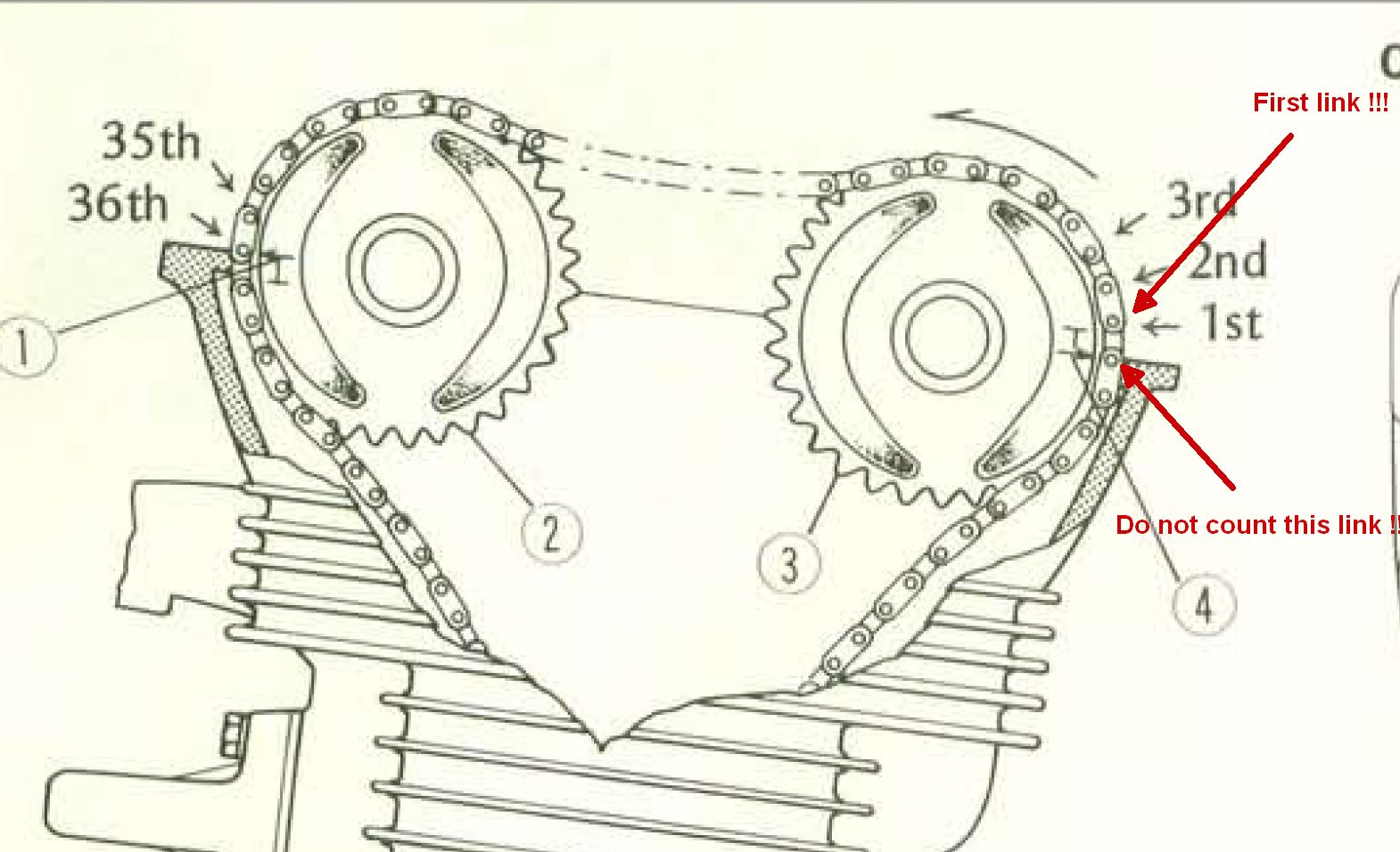

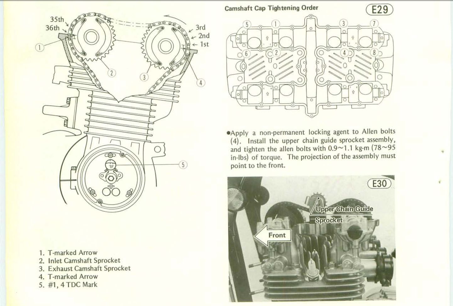

If the piston TDC is on the "F" mark, ( ignition firring ), your cam chain timing is one link off !!!

Yeahp. that'd do it. Im guessing a valve mustve been out of sync and got a bunch of crap on the seat. Maybe slightly bent? But the mating surfaces looked pretty even on the valves.
