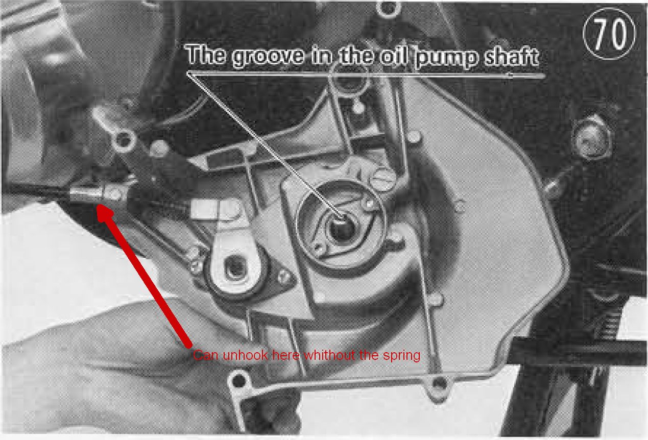

Is the push rod forced back out by the clutch itself? YES!
The spring on the clutch cable is for reducing the slack and hooked it up
in the clutch hub lever mechanism so it don“t get loose if you lost the cotter pin.
