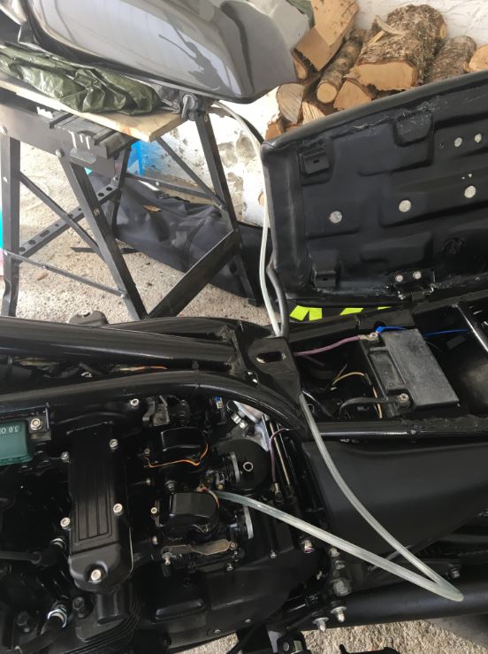

Today have I done a function test on the petcock, I suck on the vacuum line and the gas comes out as it should.. so the petcock is working, I have also tried to start on "PRI" without any success.
I have also tested with another fuel hose same problem, I used a one you can look through, and the gas goes in for sure...
I took out the carbs today and open up all from the button and I have used carb cleaner and high air pressure for cleaning. The only thing I took out was the air/mix screw and the needle for the flow height. The jets I just sprayed with carb cleaner and high pressure air...
I found the problem why the carb 1 has no gas in the reservoir yesterday, I have mounted the needle wrong yesterday when I tried to clean the carb first time (yesterday).
I installed everything again, and the results is the same....

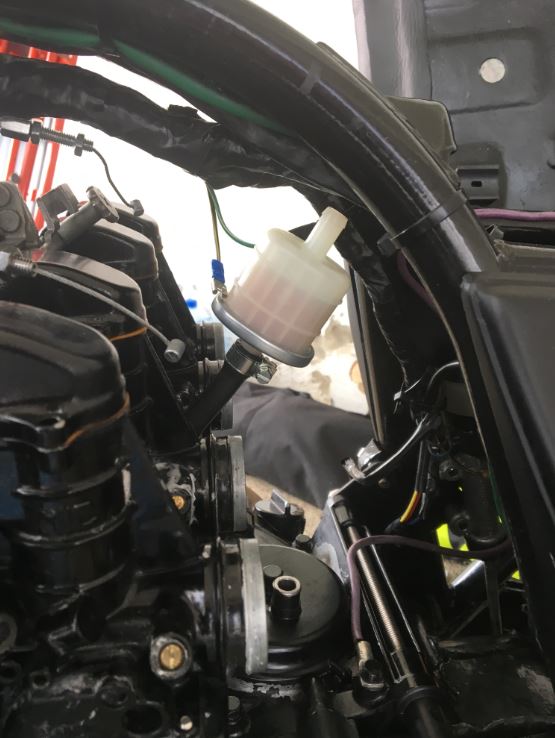

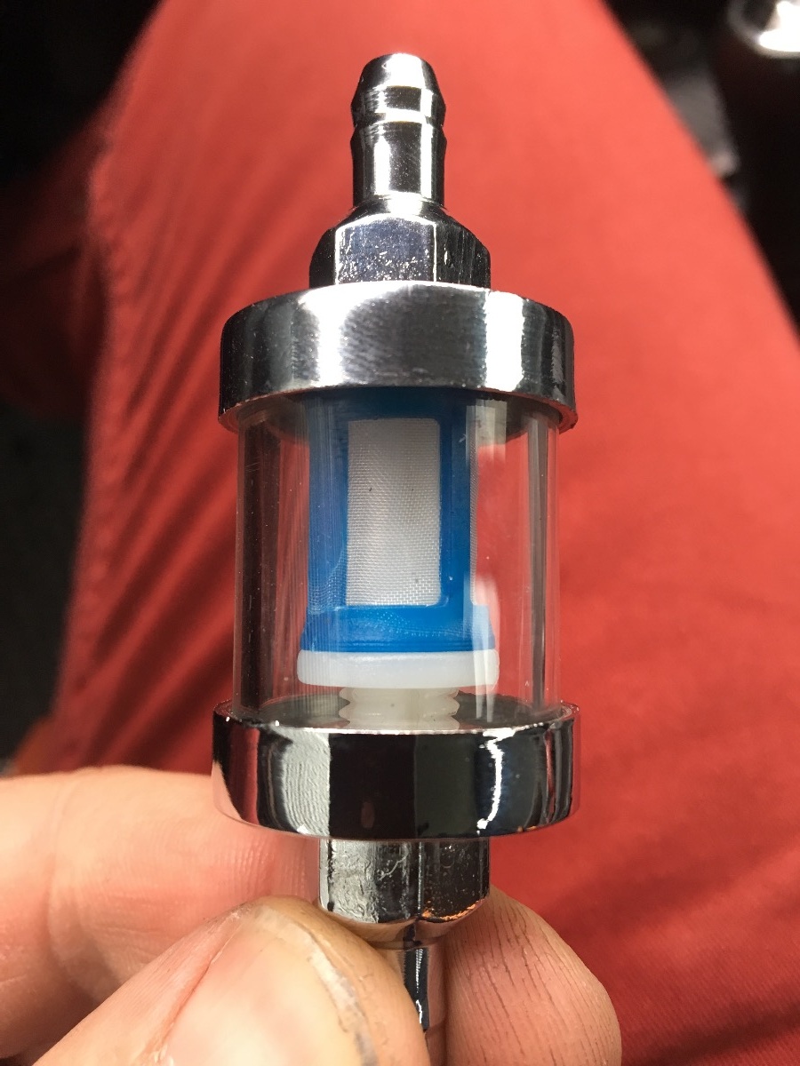

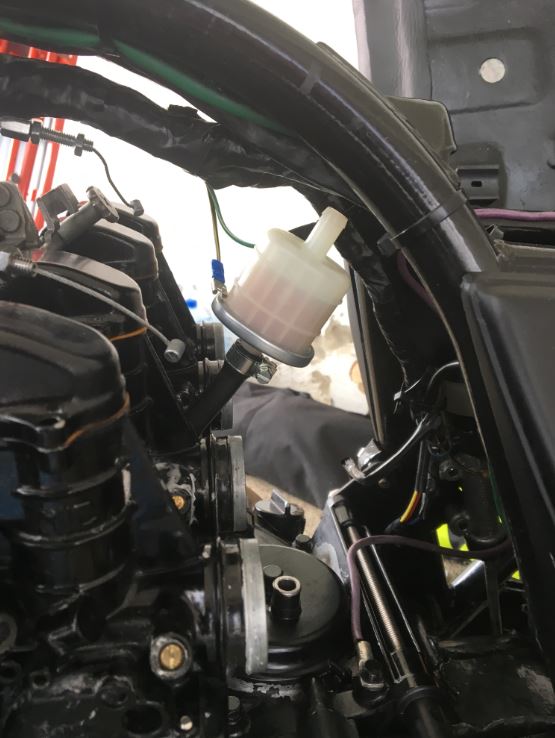

After I had tested with start gas, I purchase a quality gas filter, wanted to just remove all potential problems.
I empty the tank it was around 10-11liter of petrol, I have fill 5l x 2 after the start up so it cannot been much left from before the start up...
I filled new gas approx. 1 liter shaked and empty again.. did the same one more time. Fill up with fresh patrol.
Cleaned the cabs, but these time I took out the jets and also "choke?" the plug you are using when you start up on cold engine, gives some more gass or something?
And then I tired to start up with cleaned tank, petrol filter and clean carbs... and then bike started ! hehe

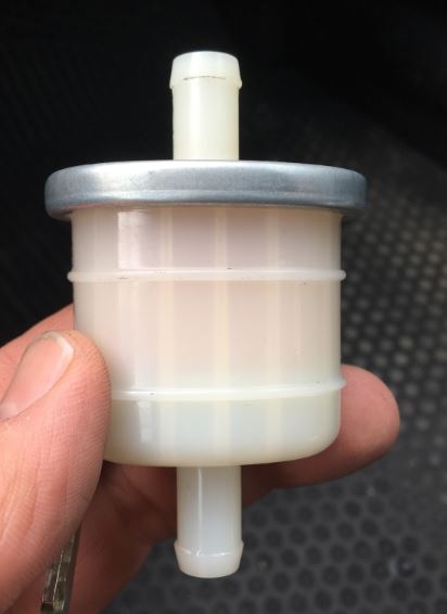

One caution: be sure that fuel filter is made for a "gravity feed" fuel system such as for a lawn mower, motorcycle, or similar. Many fuel filters are designed for high pressure applications and fuel may not flow well through them in your application.

I sad to the gay I don`t had fuel pump and needed filter for gravity, but I don`t know how much skills he had...
Is there away I can test these? will I get problem now or is these something coming sneaking.... ?
What I liked was it was big, then it properly longer time before I need to replace it ?
For me it looks like there are many type of filters? some has "coffee" filter type ? some has just a plastic filter? what is best?
Now I have plastic screen in the tank and "coffee" filter between the tank and the carb, maybe that is a good combo to take everything?

I use these.
I'd check the pilot jets again. They are very small. Use a guitar string or strand from a wire brush to clear them.
