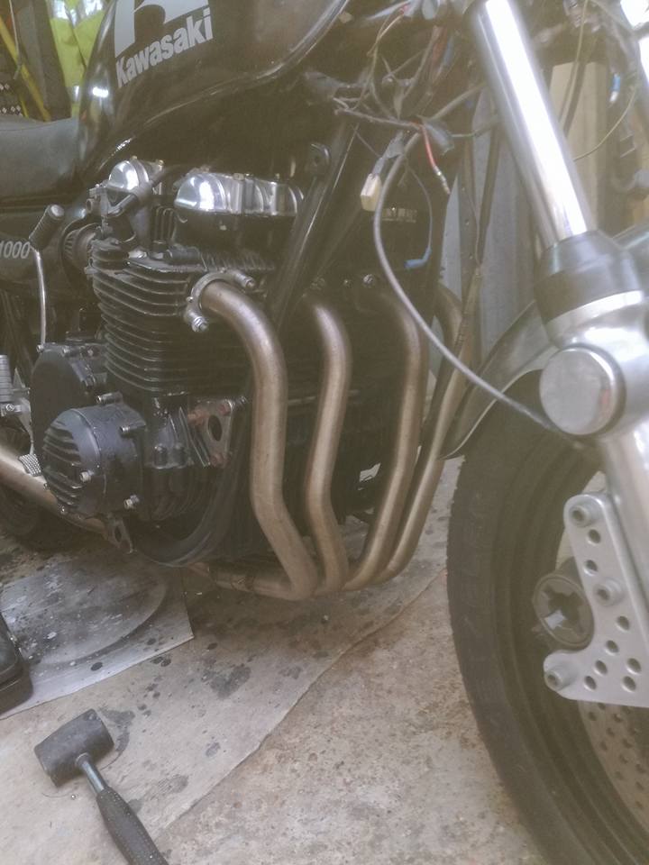

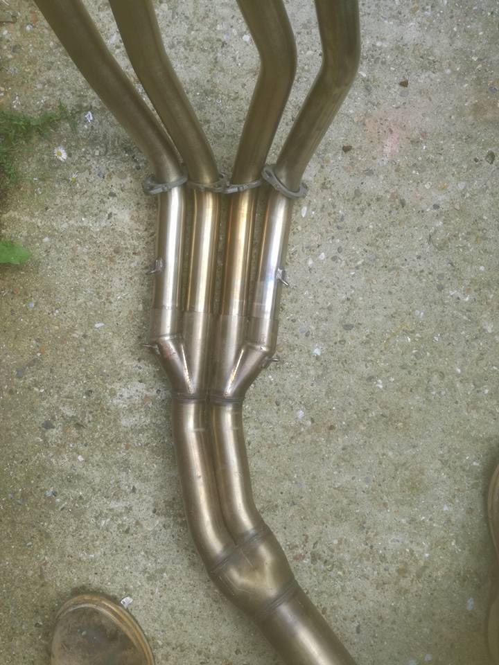

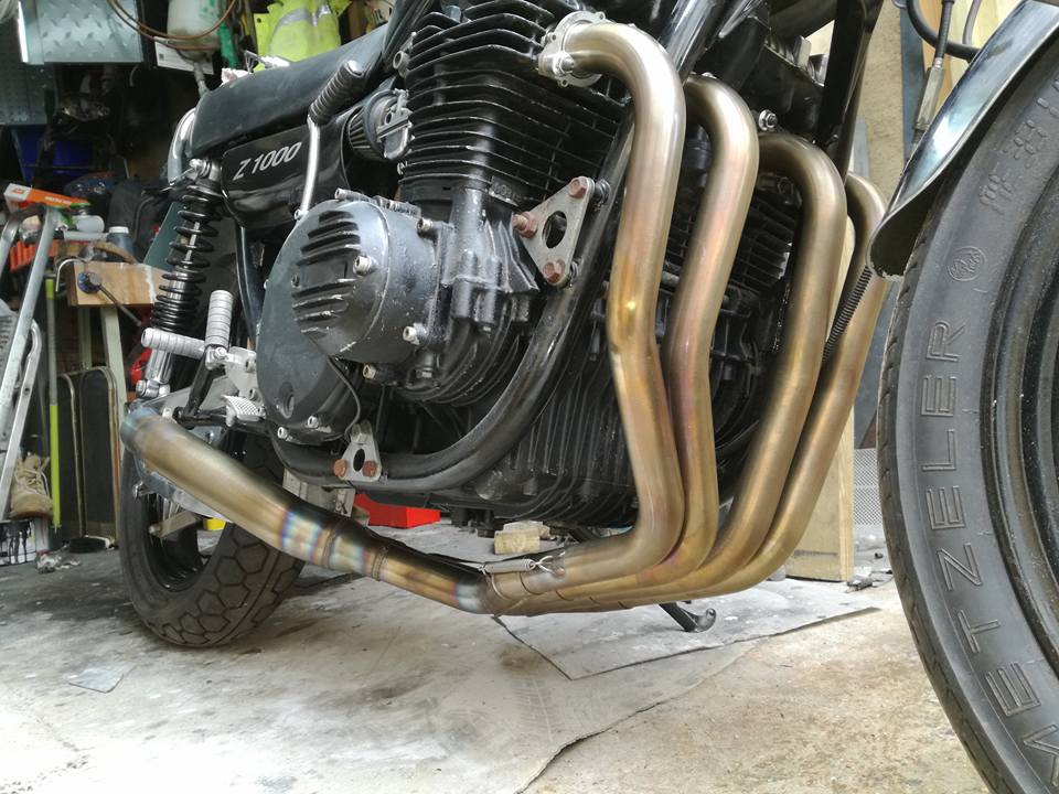

I thought this might be well interesting to those looking for a set of pipes for their build. Found on the facebook. A lot of very interesting groups on there.This is from one called 'Butchered Classics'.
Anyway ( I have no idea if its possible to link to it and I cant be arsed to try) bloke says;
'After market stainless 4into 1 off a fireblade from Kempton bike jumble fitted quite nice'

Interesting. I wonder about the tuning since the CBR1000RR (not Fireblade here) is capable of quite a bit more rpm than the typical KZ?

What years fit?

Sorry Kidkawie,no idea!
Heres more of the comments;
that doesn't look a bad fit at all , any idea what year fartblade it was meant to fit .
That was lucky! Did you know it would fit - or did you take a risk? Looks great!
Looks like a black widow .... and a bargain
There was a kwak 1100 nearby so I done some rough sizing the headers are all slid in so have plenty of side movement still was a gamble. I dont know what year blade it was for
