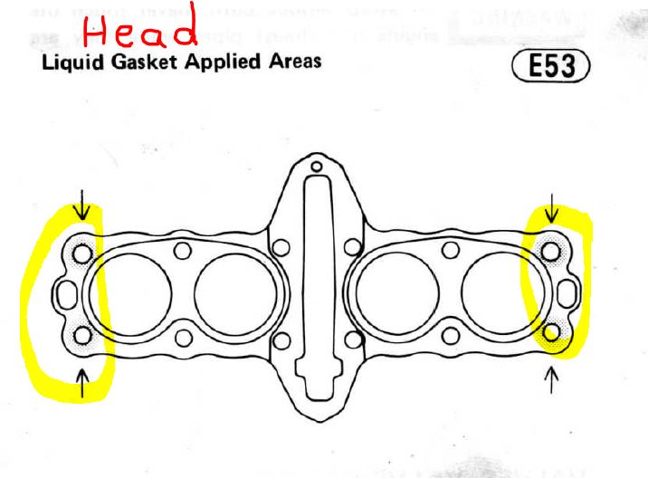

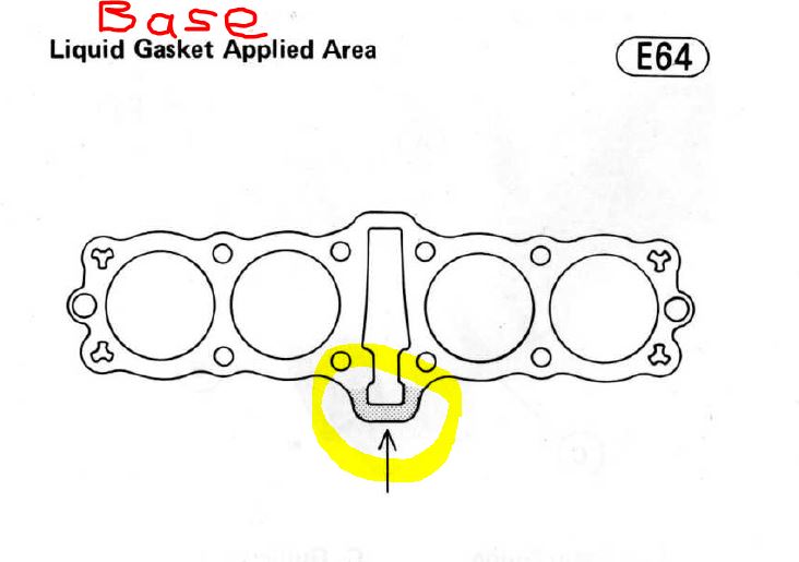

- Posts: 8205
- Thanks: 3577
Re: Gaskets
09 Jan 2018 10:41 - 09 Jan 2018 10:41
The only gasket I use oil on is the valve cover, and only on one side. I would not use oil on any other gasket. And you don't need sealer either other than in the spots where Kawasaki suggests. See below.

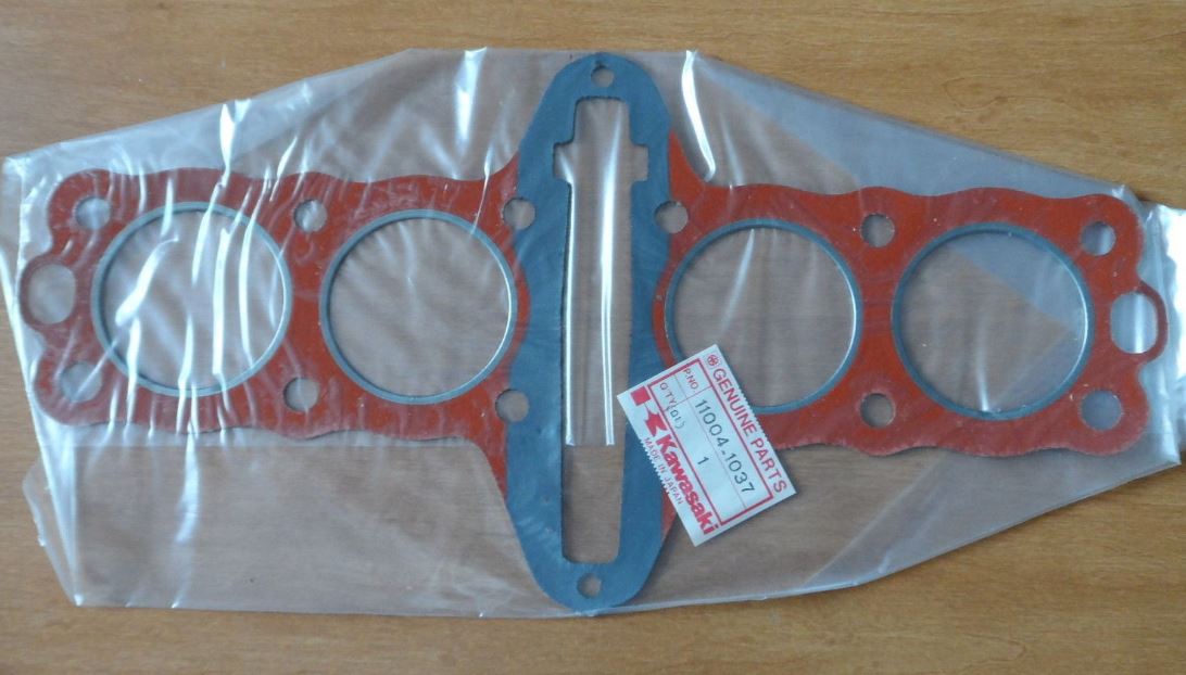

This photo is an OEM Kawasaki 750 head gasket. Kawasaki changed the head gasket quite a few times over the years and this version is one of the later ones. The red stuff is RTV sealer. Coating such a large area is contrary to what the manual states but it does suggest there may be some good in doing so.

1. I will use Wiseco / Cometic head gasket so I understand from you I shall use sealer where Kawa indicated on the picture you attached?
2. Or maybe I shall use a thin layer of sealer on both side of the gasket not only on indicated area? Since kawa have started to use RTV on almost the whole gasket?
3. Can I use ""Three Bond Case Sealant Liquid Gasket 1184A100G"?
4. Shall I apply thin layer of sealer on the gasket it self or on the metal?
